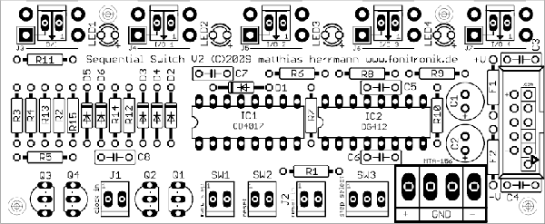

PostPosted: Sun Apr 19, 2009 3:51 pm    Post subject: Reply with quote  Mark this post and the followings unread
fonik wrote:
there are a lot of DIY-boards out there without any standard headers... so "something is better that nothing"?!
when ever possible i don't build boards without PSU Headers.
btw.:
the dotcom connector can use the pads from one row of the doepfer Header,
you just need to place a sixt pad, and you must change the Ground plane on that row
---> dotcom has the Ground only on one pin, and +5V on a pin that goes to Ground if not changed a little bit.
dotcom pinout:
V+
NC ....( Grnd on doepfer)
+5V...( Grnd on doepfer )
Grnd..( Grnd on doepfer )
V-
NC ( ok, not really necessary )

okay then... now almost everyone should be fine, i think. i added the MTA-156 connector and modified one row of the euro-style ribbon connector to comply with the dotcom standard. the footprints for the beads now have a .039 drill.

PostPosted: Mon Apr 20, 2009 1:16 pm    Post subject: Reply with quote  Mark this post and the followings unread
Wow, thats cool ! i use dotcom headers banana afro thanks !
