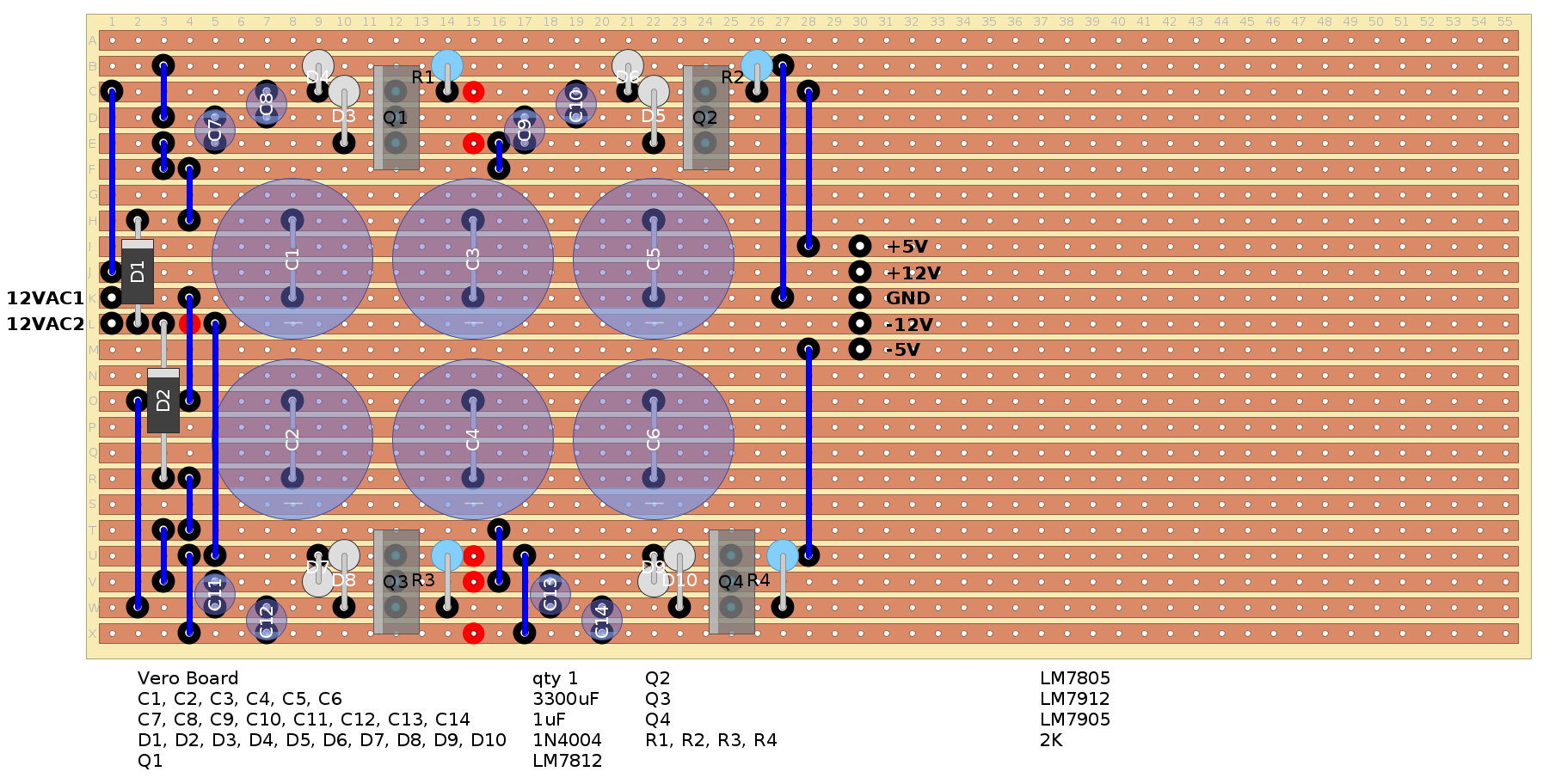

PostPosted: Mon Jul 12, 2021 6:17 pm    Post subject: Reply with quote  Mark this post and the followings unread
Sorry to necro a thread, but it's kind of perfect and why reinvent the wheel?
I took inspiration from this thread and the stripboard on page 1 and this stripboard layout and created what is attached. I'm looking for a sanity check before I get building.
 Filesize:  151.92 KB
 Viewed:  279 Time(s)
PostPosted: Thu Jul 15, 2021 8:01 am    Post subject: Reply with quote  Mark this post and the followings unread
Do a quick dry-fit to see if there is room for heatsinks on the regulators -- without heatsinks, I found on my first rack that the voltage rails sagged under load, and the regulators got way too hot.
dadinfinitum
Joined: Dec 16, 2019
Posts: 41
Location: Maryland, US
PostPosted: Thu Jul 15, 2021 3:50 pm    Post subject: Reply with quote  Mark this post and the followings unread
Yeah, I'll scoot some components around as needed to fit some on. Thanks!
