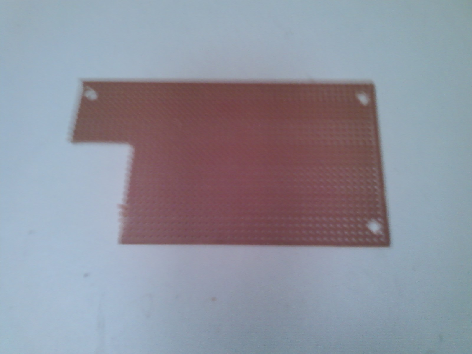

Here is a photo of the mysterious chopsticks. It is a proto board with a notch cut out of it and when seen from that angle it looks like chopsticks. Sorry photo is blurry.
Actually I'm surprised that you guys were distracted by the chopsticks so much that you missed the reflection of the UFO in the background! Laughing

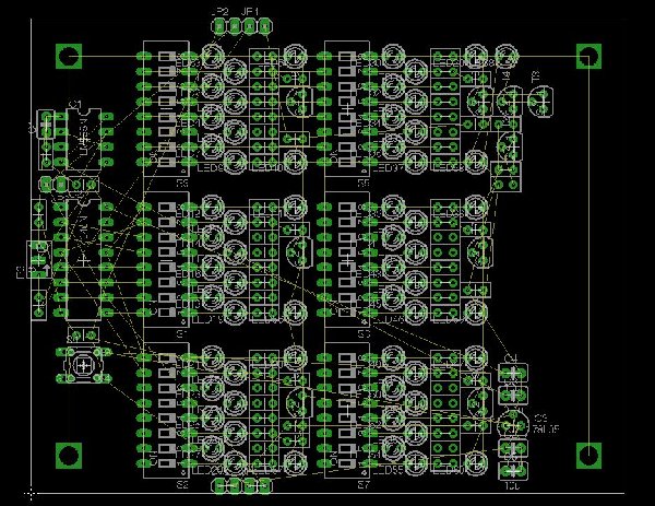

As a sort of test-fit, I did a board placement this morning, shown below. While the BS part of the BSG fits nicely, there is little room left for the G part (KS). So what I'm thinking of doing is simplifying the LEDIL logic somehow. I'll let you know how that goes.

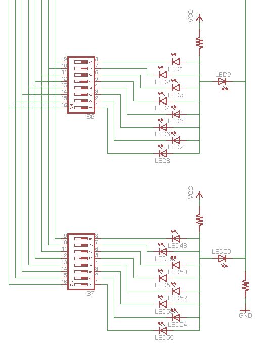

I simplified the LEDIL to make more room on the board, and now there is plenty of space. You can see two sections of LEDIL in the attached schematic. There are no series resistors with the LEDs and no transistor buffer stages either. I may have to adjust the bias and gain of the output, but at least I think the output will be correct.
The performance difference here is that the input LEDs will get dimmer when there are more of them on at the same time, but that saves on battery life and makes for a more interesting display perhaps, so it's not really a negative.

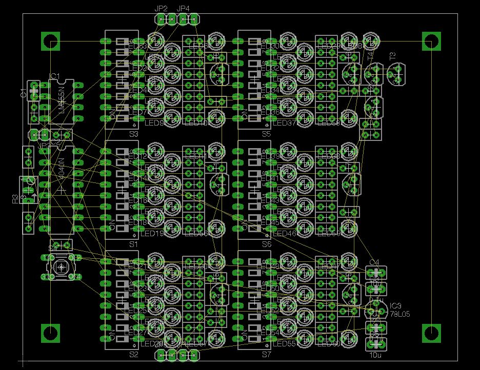

Ty droffset, i need motivation like that. Shown is a layout with simplified LEDIL and two opamp chips on the output. Should be enough room for a KS circuit, should I ever get to testing that. Bet I should huh? Anyways ty and best wishes droffset.
