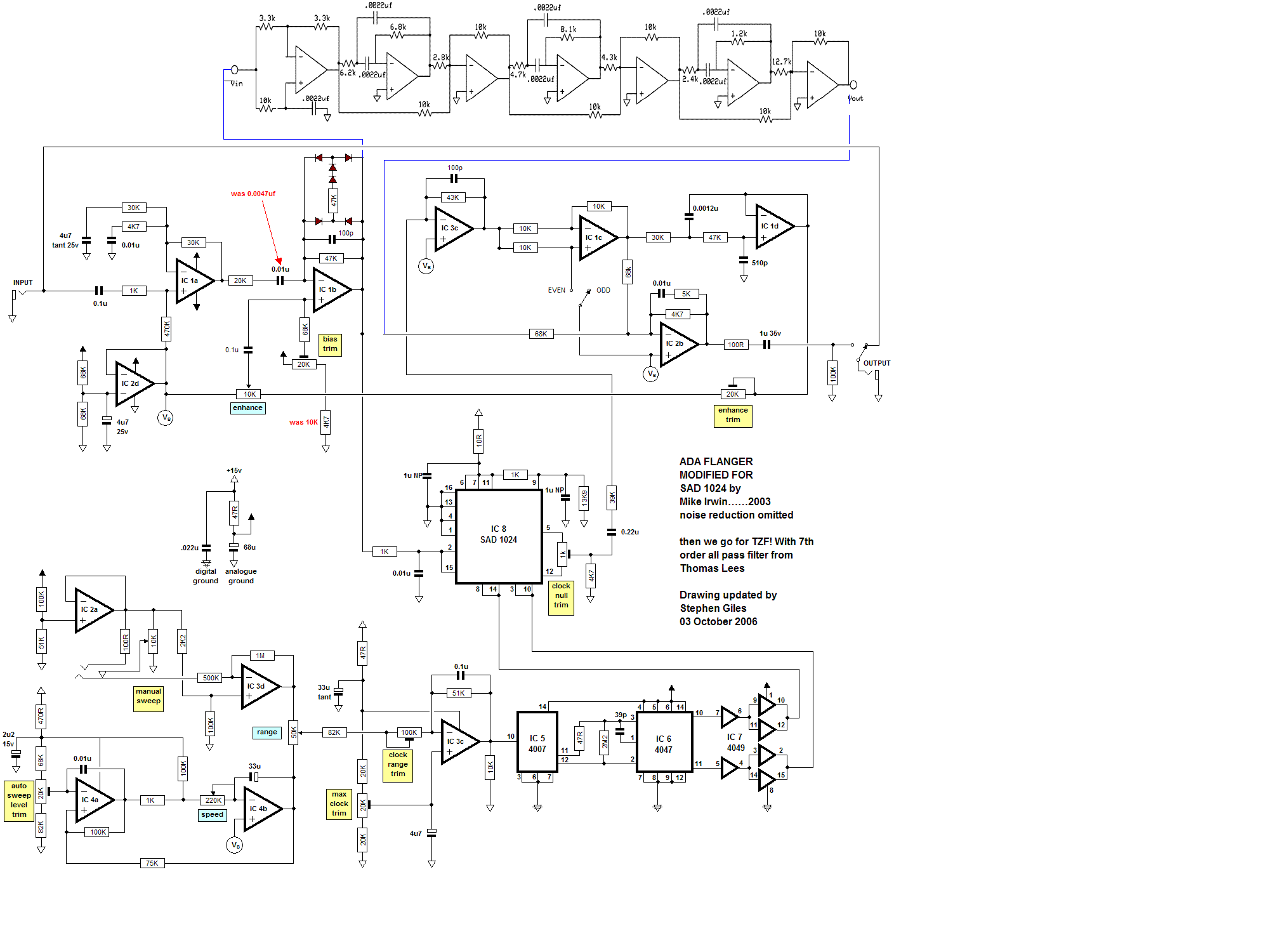

For a project of mine, I need shorter delays than what is suppose to offer usual BBDs (I mean sourceable BBD and at a reasonnable price).
Ideally I could do what I want to with SAD1024, SAD512 or TDA1022 but these are nearly as difficult to find as a yeti or if available they are at a "forget about it" price.
Those I have are BL3207 and the upper clock value is 200kHz giving a shortest delay of 2.56ms . Can I overclock them up to 1MHz/2MHz ? What are the risks of doing so ? Will I burn the IC or if not will the BBD keep on track with such a high clock rate ?
As somebody around tried that ?

I've overclocked the dickens out of a 3207; it's been a while, but IIRC I was in excess of 700 kHz.
The real trick is that you need to buffer the clock pulses with some CMOS to keep the pulses nice and straight (the capacitive load of the BBD puts a lot of bend in the pulses straight out of an MN3102 at those frequencies). Some flanger designs I've seen eschew the clock IC altogether and use a CMOS multivibrator. I've read that the CP1 and CP2 spacing of the MN3102 is ideal, however; I've wondered about driving an MN3102 to very high frequencies and buffering its outputs, but I couldn't tell you if there would be any discernible difference in the final outcome.
As far as overheating, I'd say just grab a victim and clock it as fast as you want and see what type of heat builds up and see how long it.....survives Laughing
They're cheap enough these day to do that. Even for me.

StephenGiles
Posts: 507
PostPosted: Fri Nov 04, 2016 12:00 pm    Post subject: Reply with quote  Mark this post and the followings unread
You need to look for a modified ADA Flanger circuit, I have it somewhere.

Buffer each of the clock signals with three sections of a 4049 each, that'll help. Even so, bbd's do have a upper clock limit.

StephenGiles
Posts: 507
PostPosted: Sat Nov 05, 2016 8:41 am    Post subject: Reply with quote  Mark this post and the followings unread
Found it!
