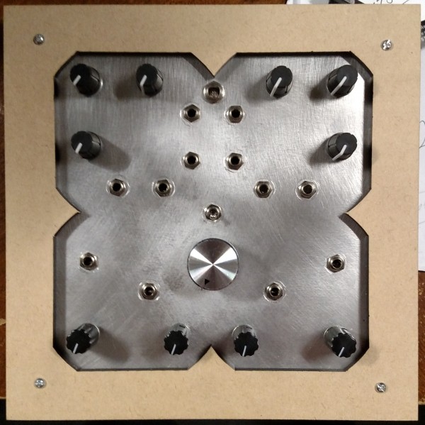

A Static Environment for Complementary Instabilities from macumbista on Vimeo.
++dual butterfly benjolin++chaotic feedback++
++symmetrical patching++high resonance++
++total harmonic distortion++
++no changes++no cuts++
++get hypnotized++

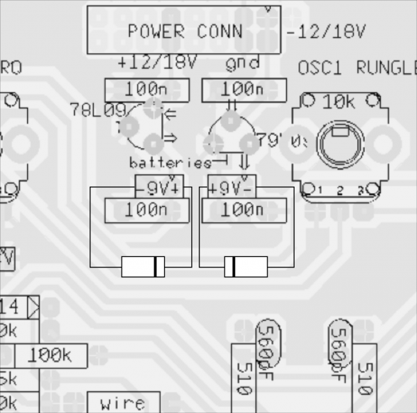

i etched the pcb myself. the holes for the regulator were a bit too small and i couldn't get a fitting regulator. because of this, I had some problems with the power (only 1 side worked sometimes)
i wired the headers with dupont wire (with connectors) , that was a bad choice.

This could also be because of the regulators themselves. Rob recommends putting reverse-biased diodes just after the regulators to prevent this, it's written somewhere in the documentation Wink

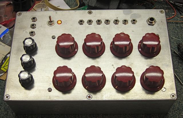

Here´s my Twinjolin, labeling will be following with old school Dymo- I just love the rundown industrial look...
Thanks Rob, a lot of fun already!
And thanks Macumbista for inspiration Very Happy
a few mods:
-switch for loopx1/off/loopx2
-switch for loop lenght, 6/8 steps on rungler 1, 7/8 steps on rungler 2
-switch for crossfeed of selected output bits rungler 1 into data in on rungler 2 (and vice versa for weird canons)
-ext. clock inputs on both runglers for syncing the runglers etc.
-Hp/Bp outs added (especially love the Hp)
-internal resonance trimmer (parallel to R28) for max.Q up to self oscillation (which is actually not desirable as s.o. is frequency dependent and sets in with high squealing, but you can trim resonance to the edge, for for even more wet/pingy sound than given circuit)
Powersupply is MFOS circuit, jacks are 3,5mm type high quality
Dual Zeitgeist will be following! I found the pcb layout on muffwiggler-

Looks great! Love the metal toolbox enclosure!
I'd be curious to see what you did for the loop length mod. Also, the HP/BP outputs are just tapped from different places in the filter architecture, or did you need to buffer them, etc?

Loop lenght: really simple, put the node of R16/R17 on the middle lug of a switch, and put the bit out pins of the 4021 on the outer lugs...
You could use 3throw switch for all possibilities, but I used 2 throw...
It would probably be good practice to buffer the filter outs, but I think it is not necessary with any sane load impedance (just as the original lp out).
The crossfeed feature is a winner, btw. With the runglers synced, benj2 plays the pattern of benj1 with eight step delay, trhat ties everything together nicely, I recorded a little piece, that I will upload asap (I record on cassette) cyclops

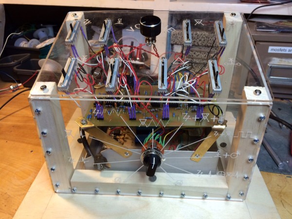

I'd swear I had posted mine, but apparently not....
