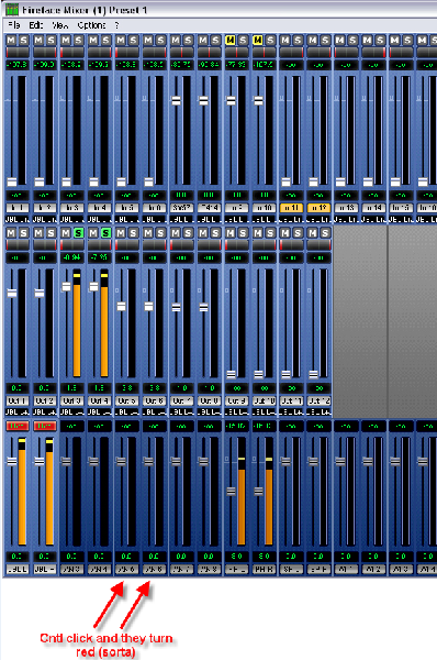

In another topic a question was raised about the need for using external cables to do output to input loop back with RME audio interfaces.
I'm starting a new topic here because it may be of more general interest.
durwood - re using cables for loopback wrote:
... I thought someone on DIYAudio.com had mentioned RME had internal routing?? Can you link spdif out with spdif in without the cable? Seems like conflicting information and I think how you are routing your signal is how you have to do it with that card.
You can in fact route the SPDIF output back to the SPDIF input with RME devices - at least with the RME Fireface interfaces and some of the PCI cards as well.
On the RME mixer application, you just control-leftClick on the routing buttons at the bottom of the output fader. They call this loop back in the manual. You can only loop back an output to its corresponding input. SPDIF out may only route back to SPDIF in, for example.
A great thing is you can route to and from outputs and inputs that may not exist in hardware. If you enable ADAT, and you don't have an ADAT device, the RME interface provide another 8 IOs that call all be used as loopback channels. All mixing is done on the RME's DSP, so there is virtually no load on the host CPU.

Yeah this was brought up in the chat yesterday, I checked it for my multiface II unfortunately that one cant rout back to it's inputs - that is control left click does nothing in the matrix screen for me.

It's not the matrix screen, it's the Total Mix screen. Maybe your interface is different, but it looks like the same basic thing. It seems strange that they would leave that feature out. See attachment.

Cool that does it! thanks!

Laughing I pulled four cables out, made 8 new virtual ones, and I understand less and less what I'm doing ... but preset 8 will set things ok for radio stuff Cool

the cable is out, the loopback works and i love my fireface!
