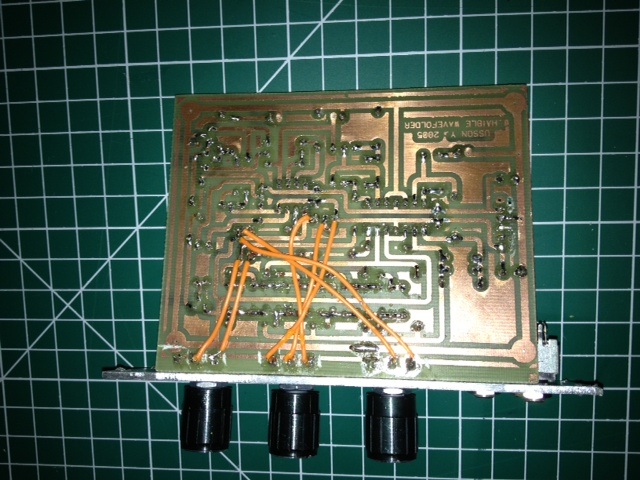

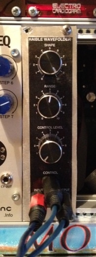

PostPosted: Wed Aug 28, 2013 8:26 pm    Post subject: Reply with quote  Mark this post and the followings unread
I had great fun building the wavefolder for eurorack. This was my first yusynth and pcb etch. I decided to add pads for the pots before I made the press and peel so I could then add short wires to the pcb. This way I could mount the pots straight onto the front panel.
I am very impressed with the sound of this module. It works great with synths and is fantastic on drums. I look forward to making many more yusynth modules!!!

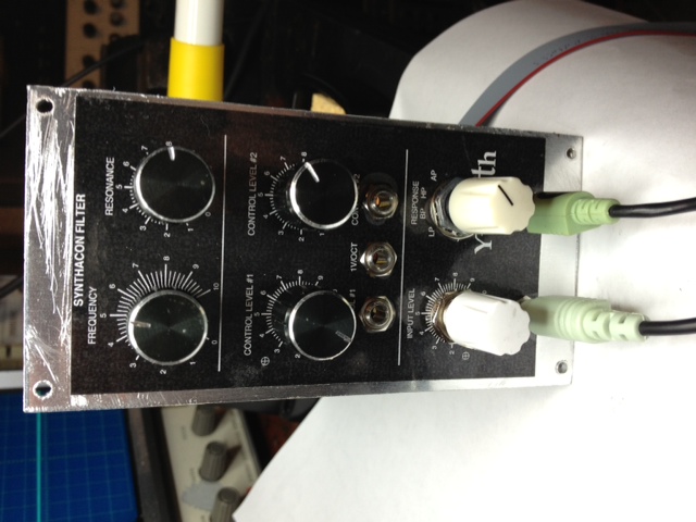

PostPosted: Sun Oct 13, 2013 8:52 am    Post subject: Reply with quote  Mark this post and the followings unread
So Yves Usson you have made me addicted to recreating your modules.
I thought that i had enough filters but no. I am so glad i made the Steiner filter as it is so different to anything else.
Thanks again Yves for making your work plublic.

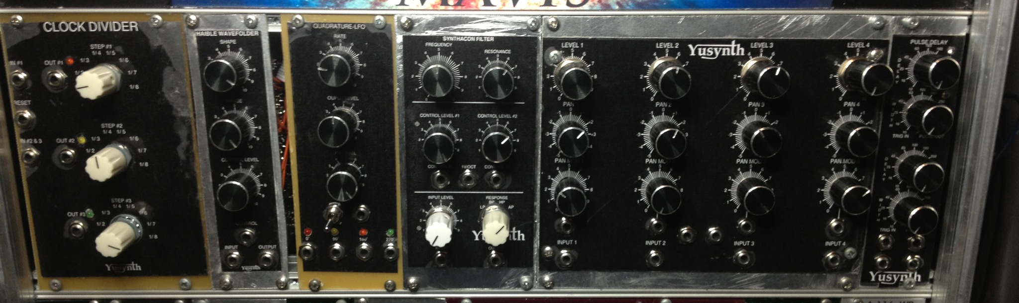

PostPosted: Wed Dec 11, 2013 11:22 pm    Post subject: Reply with quote  Mark this post and the followings unread
So here is my finished yusynth.
Running on 12volts I have CV Standards, Steiner VCF, Dual Auto Bend, Clock Divider, Dual Pulse Delay, Dual Gated Slew, Wavefolder, Saw Animator, Quadrature LFO and the 4 ch Stereo Mixer with CV panning.
I also have a Frequency Central PSU running 15v for the 2x Oscillators.
I can't thank you enough Yves for sharing your wonderful creations.

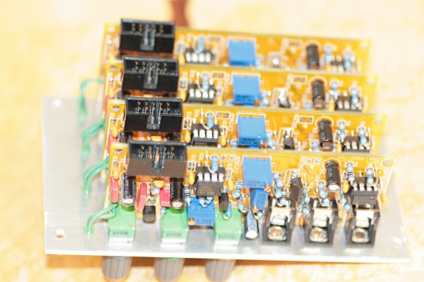

diablojoy
Posts: 809
Location: melbourne australia
PostPosted: Thu Mar 06, 2014 6:50 pm    Post subject: Reply with quote  Mark this post and the followings unread
hmm is there interest in a 4HP version of the yves's simple VCA single cv input, signal input and only the 1 output , but there are connectors for the others if you want , i should get back a prototype in a couple of weeks.
this is the 2SC1583 version
did this one for myself and putting 4 behind a 16 hp panel
ask where the hell am I
as good an answer as any

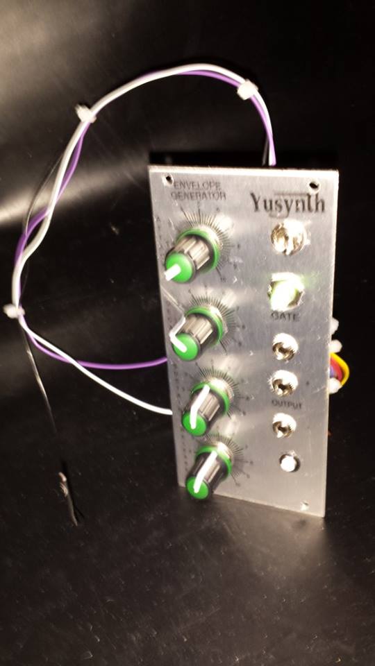

PostPosted: Mon Mar 10, 2014 3:58 pm    Post subject: Reply with quote  Mark this post and the followings unread
Yusynth ADSR

diablojoy
Posts: 809
PostPosted: Mon Apr 07, 2014 1:10 am    Post subject: Reply with quote  Mark this post and the followings unread
VCA prototype seems to work as expected
still some testing to go to make absolutely certain
some crappy pics of quad version in 16HP
really like this VCA - simple and efficient, i plan on having 30 or so eventually
