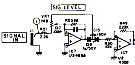

PostPosted: Mon Feb 15, 2010 3:46 am    Post subject: Reply with quote  Mark this post and the followings unread
wouldn't we need two actually? one for the carrier and one for the modulator?
anyways, i'd liked to leave it as a synth module. maybe i should/could bring out the left opamps pins to pads? the one could use it for whatever he wants to...
BTW i once had the MS20 external in circuitry on my breadboard and i found it quite useful. i especially liked the idea of using a 1M potentiometer to change input impedance and amplification. worked fine for me.

PostPosted: Mon Feb 15, 2010 4:02 am    Post subject: Reply with quote  Mark this post and the followings unread
Hi Matthias,
Bringing the pins out to pads is a very good idea.
Thanks for posting the MS20 circuit, agree that could be very useful.
David

PostPosted: Mon Feb 15, 2010 4:28 am    Post subject: Reply with quote  Mark this post and the followings unread
+1 for pads for the spare Opamp.
Maybe if board space permits, include pads for the couple of additional components to make a simple attenuverter?
They're always useful to have around....

PostPosted: Mon Feb 15, 2010 4:37 am    Post subject: Reply with quote  Mark this post and the followings unread
Well, yeah, if both modulation and carrier are low-level, like voice modulating guitar, or vise versa. But as a synth module, one or the other is likely to be at a high enough level. I was avoiding adding another package.
A low-budget way to do it might be to change the attenuation at the OTA inputs by increasing R4 and/or R8. A.C. coupling might be desireable.
Excellent idea! Should be incorporated in all future projects with unused devices. Frankly, I have doubts that non-logic inputs (op amps,) even need termination.
Ah. I knew I'd seen a circuit something like that. You saved me the trouble of digging through my old magazine clippings.
