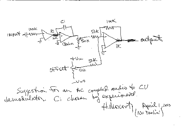

On another topic, http://electro-music.com/forum/post-290079.html#290079 , the G2 guys are talking about using their synths to control external equipment. Believe it or not, there is no CV output from a G2. Some guys are modifying their machines to short out the decoupling caps on their output. This works, but one accident and poof, there goes your prized G2. Rolling Eyes
I was thinking that a simpler method would be to build a simple Pulse Width Demodulator for the output. This would be external. A Pulse Width Modulator would be very simple to patch up in the G2, of course.
I don't build any more, as many of you know, so I'm planting the seed for a discussion here with the hope that some of you will take this idea and build upon it so that we can come up with a useful circuit.
So, here's the ideal. A pulse width modulator is simply a square wave running at a constant frequency that is with a CV to adjust the pulse width. That's trivial to do in a G2. The demodulator is a circuit that converts the audio signal back to a CV, for controlling external gear like a Moog filter or whatever.
The basic circuit is just an OP amp integrator,
Anyway, if one selects the cap value correctly, then the output will follow the pulse width. I'd suggest using about a 10 KHz square wave in the G2 so the demodulator will run fast enough.
A second op amp circuit with inversion, offset, and scaling would make this thing more useful for the G2 users.
I think this isn't a bad thing for modular builders to have in their bag of tricks.
Please, those that are interest, take a look at this and see if you can flesh this idea out into something that will work. I think a lot of people would appreciate it.

PostPosted: Tue Mar 30, 2010 2:00 pm    Post subject: Reply with quote  Mark this post and the followings unread
Howards circuits has a lil problem, but I don't think it will be fixed by a circuit as posted by Matthias.
The problem is that that the circuit is coupled AC to the synth, so the average Vi will be zero, no matter what the pulse width is. So Vo will be zero as well.
I think an AM system should be used, i.e. an averaging rectifier instead of an integrator.

varice wrote:
Sorry, but you cannot derive a DC signal from an integrator that is getting an AC signal input! For that integrator idea to work, the input signal must already have an average DC offset!
If you are really scared of modifying the G2 for DC output, then amplitude modulate a square wave output and use a fast response envelope follower. That would work... kinda...

PostPosted: Wed Mar 31, 2010 1:54 am    Post subject: Reply with quote  Mark this post and the followings unread
why not just blocking the negative excursions of the PWM signal on the input of the demodulator?

PostPosted: Wed Mar 31, 2010 5:59 am    Post subject: Re: Pulse wave demodulator Reply with quote  Mark this post and the followings unread
I was thinking that a simpler method would be to build a simple Pulse Width Demodulator for the output. This would be external. A Pulse Width Modulator would be very simple to patch up in the G2, of course...
Mosc's circuit would track frequency changes -- you wouldn't necessarily have to control it with the duty-cycle.
If you use FM instead of PWM, then you don't have to worry about DC coupling issues. Would that work?
Yes, of course. Two ways to do this: (a) a half-wave rectifier using a diode to clip the negative excursion, (b) put the signal through a comparator referenced to ground. I think Howard's scheme is probably the simplest method to use for this problem. But I would probably use FM demodulated by a LM331 F/V converter.

PostPosted: Wed Mar 31, 2010 11:29 am    Post subject: Reply with quote  Mark this post and the followings unread
You could place a Schmitt trigger prior to the integrator. Then, the average Voltage will vary with the frequency and/or the pulse width.
Incidentally, this is the technique that the Paia Theremax uses to convert the Theremin's pitch to a control voltage output that tracks pitch.

PostPosted: Wed Mar 31, 2010 11:48 pm    Post subject: Reply with quote  Mark this post and the followings unread
Sure, any kind of comparator could convert the AC coupled output from the G2 into a nice solid rectangular wave. The effect of that AC coupling cap is neutralized by a zero crossing detector. Good suggestion.
FM demodulation as suggested would work, of course, but PWM is much simpler. IMHO. Most FM demodulators work over a relatively narrow frequency range. They usually detect a time varying signal, not necessarily a constant, but that's not to say it can't be done.
The AM modulation scheme that was suggested will work too, but it is hard to calibrate the G2 output. This is because there are so many ways the amplitude of the G2 can be changed both in the patch and in the G2 system. My experience in playing the G2 almost exclusively in live performance teaches me this. The PWM doesn't need calibration because the level of the output is not critical.
A quad op amp and a few passive components would do the trick. Input comparator - integrator - invert, scale and offset. One free op amp.
With a little more design you could superimpose a gate or AM on the PWM output to generate a gate or even a second CV output. This adds more complications on both ends.
There is more that can be done, but just getting a single CV with PWM shouldn't be that difficult.

PostPosted: Thu Apr 01, 2010 12:45 pm    Post subject: Reply with quote  Mark this post and the followings unread
Here's a diagram of a suggested implementation. If someone could try it out and report back, that would be nice. I haven't done building in a long time.
Remember to get this to work well, the higher the freq of the PWM signal in the G2 the better. I suggest 10 KHz as a good compromise for high frequency responsiveness and stability.
Ci is selected by experiment. One could trim Ri as well.

Posts: 1459
PostPosted: Thu Apr 01, 2010 1:36 pm    Post subject: Reply with quote  Mark this post and the followings unread
Ah, time to get out the breadboard!
You may need to apply some negative bias at the junction of the 100K resistor and the - input to the comparator. This will prevent unwanted firing of the comparator at narrow or 0% duty cycles.
An alternative to negative bias would be to apply positive bias to the + input -- that is, you would reference the comparator to an above-zero value rather than to ground.
I've been working lately with op amp based Schmitt triggers and comparators -- they can get fussy when the input voltage is at or near zero.

In cases like mine though, where I’m also sending raw audio from the G2 to the moogerfooger filter, the G2 Patch Level and Master Level undesirably affect that level as well. So, one would still need to keep these levels fixed. The relative input level immunity of the PWM/integrator would not be of any benefit. The AM/envelope follower scheme is a more simple solution (as an alternative to a DC output mod). I simply leave the G2 Patch Level and Master Level set to max (which is a good thing to do anyway in the digital domain) and control the final patch output level with a mixer module within the patch. The master level is set by outboard mixer/monitor volume controls.
In my opinion, the best idea is to get a DC CV signal output (just like other modular synth CV output signals) for external control. The various AC to DC convertor schemes are overly complicated and full of unnecessary compromises. None of them can derive a DC output that has the same speed and integrity as the original DC signal. If there are concerns about protecting the DC output circuit, then the effort should be directed to just adding some protection instead of trying to come up with an AC to DC convertor compromise. Some protection ideas are discussed in my thread, including adding a current limiting/short circuit protection resistor in series with the DC output (as I did), adding a couple of overvoltage clamping diodes (as suggested by Jan), and adding a DC buffer opamp that could also double as a level amplifier/scaler.
