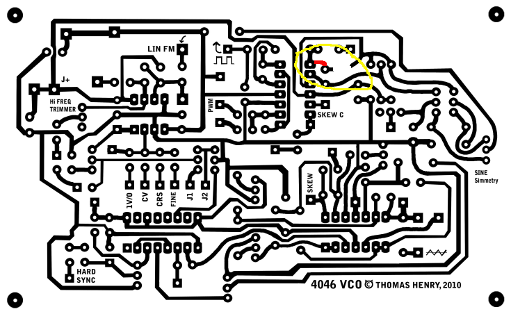

PostPosted: Wed Dec 21, 2011 7:13 pm    Post subject: X-4046 confusion
Subject description: Anyone else notice this?
Hey Spitfire...
Sorry to necro post but I see a problem on the PCB you etched,I know because I just made the same mistake. I think I should of flipped or reversed the artwork for this board,before I made it with Press N Peel.As it is now & just like your board pics I think the Chips are backwards & upside down; meaning you would have to intstall your chip sockets on the copper side of the PCB in order for the pinouts to work.Keep in mind that the square pad is pin one on the IC . Anyone else care to comment.
spitfire wrote:
Guys, I'm confused. I made PCB by myself, panel, everything as always. But I'm stuck on wiring. I see two J1, two J2, in schematic is writen to connect volt/octave to J1, but there's two of them on PCB, and also 1v/octave is writen there... I'm posting some pictures how my works look like. I hope you will help me. I don't want burn everything after such a nice working.

PostPosted: Mon Jan 09, 2012 5:33 am    Post subject: Reply with quote  Mark this post and the followings unread
@Rykhaard
Is the 'error' on the PCB layout already fixed?? (10k res. in Sinesection @ TL074)
I would love to build one of those ...
EDIT: I'm a newbee to electronic-circuits, so don't beat me please .... but if I understand the sheets and the comments right, then the little error on the pcb-layout by rykhaard is this one see attachment??
(borrowed the layout from drapdap on page 3)
rework of pcb-layout regarding 10k res. in Sinesection @ TL074

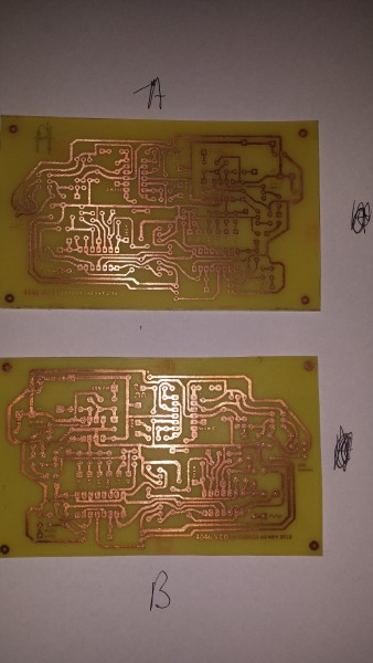

so is the board the right way on this picture ????

ok I made a second board as I think the first one I made was wrong I think A is right in the picture

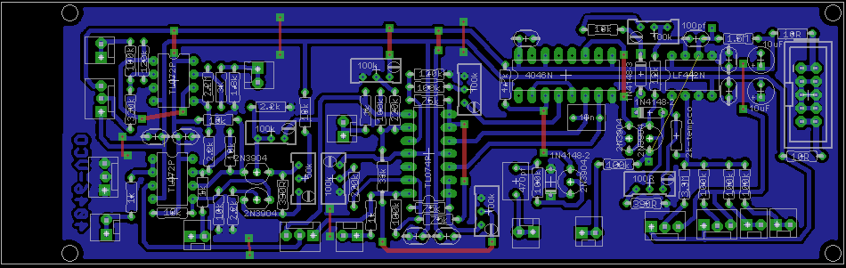

PostPosted: Tue Feb 11, 2014 3:35 am    Post subject: Reply with quote  Mark this post and the followings unread
I've just built and tested my own pcb layout of this circuit and it works fine. I can give you the eagle files if you like.
They are a fair few jumpers, but that don't bother me like Wink

I'll post the eagle files later on the night when i get home, so if anyone else is interested they can just jump in.
If any one has a problem with me uploading these files please just let me know and i'll take them down.

PostPosted: Thu Mar 06, 2014 7:37 pm    Post subject: Reply with quote  Mark this post and the followings unread
You'll need to compare TH schematics to mine for pot names, values, the odd jumper and a wee bit of off board wiring. Should be pretty easy to figure out.
A quick overview
All red traces on the board are jumper wires.
The one air wire from the expo transistors to the LF442 is also a jumper wire. (solder pads have been provided)
All off board wiring use 2 or 3 pin 0.1 header connectors (I really recommend these)
http://www.esr.co.uk/electronics/products/frame_connectors_pcb.htm
I would use eagle when building. you can highlight a part/trace in the schematic editor (show object button) and it will show up in the board editor. (really useful, i use it all the time)
two VCO's can be transferred onto on 160mm x 100m copper clad board
the freeware version of eagle allows you to export images from these files. The board dimensions are bigger than the the freeware limitations so you won't be able to edit without the full version.
