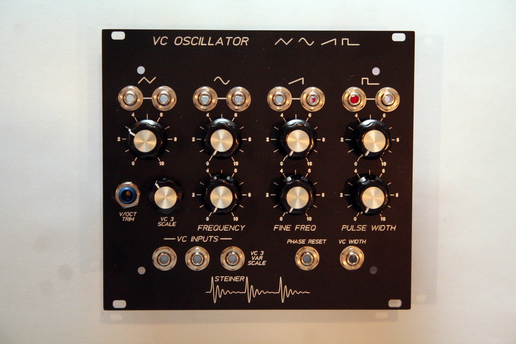

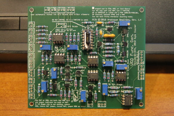

Here are a couple of photos of a typical VCO PCB build and the Steiner VCO panel adapted to Euro. I haven't run the flying wires yet, but will try to this weekend.
For this one, I used SSM2210s for the two other matched pairs in the schematic and a THAT340 for the exponential converter and the PNP transistor.
As always, see the website for more info.
Enjoy.
