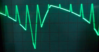

Thanks for the scope shots! They look great!
These mods certainly make the 281 more flexible and greatly expands the variety of LFO waveforms that it can produce. Of course, you could always take 5 patch cords and patch the output to a mutliple and then to 2 external attenuators (provided that you have some) and then from each attenuator back to the 281's Attack CV and Decay CV inputs).
ATOM wrote:
camelneck wrote:
That looks great ATOM. I'm also considering adding extra pots to regulate the amount of "Attack CV" and "Decay CV". I also plan to use "switching jacks" for the "Attack CV" and "Decay CV" inputs. This way I can wire them up so that the "output of the EG" is wired to the Attack CV and Decay CV inputs when a patch cord isn't inserted into these jacks. You can then use the pots to reshape the output of the EG from a linear-type envelope output to an exponential-type envelope output.
Did you wire your module up in this manner? If so, how does it work. (Some scope shots would be wonderful!)
Yes. I had wired the module as you described. Works great.
Expo decay
Peak out one slope expo, one normal.

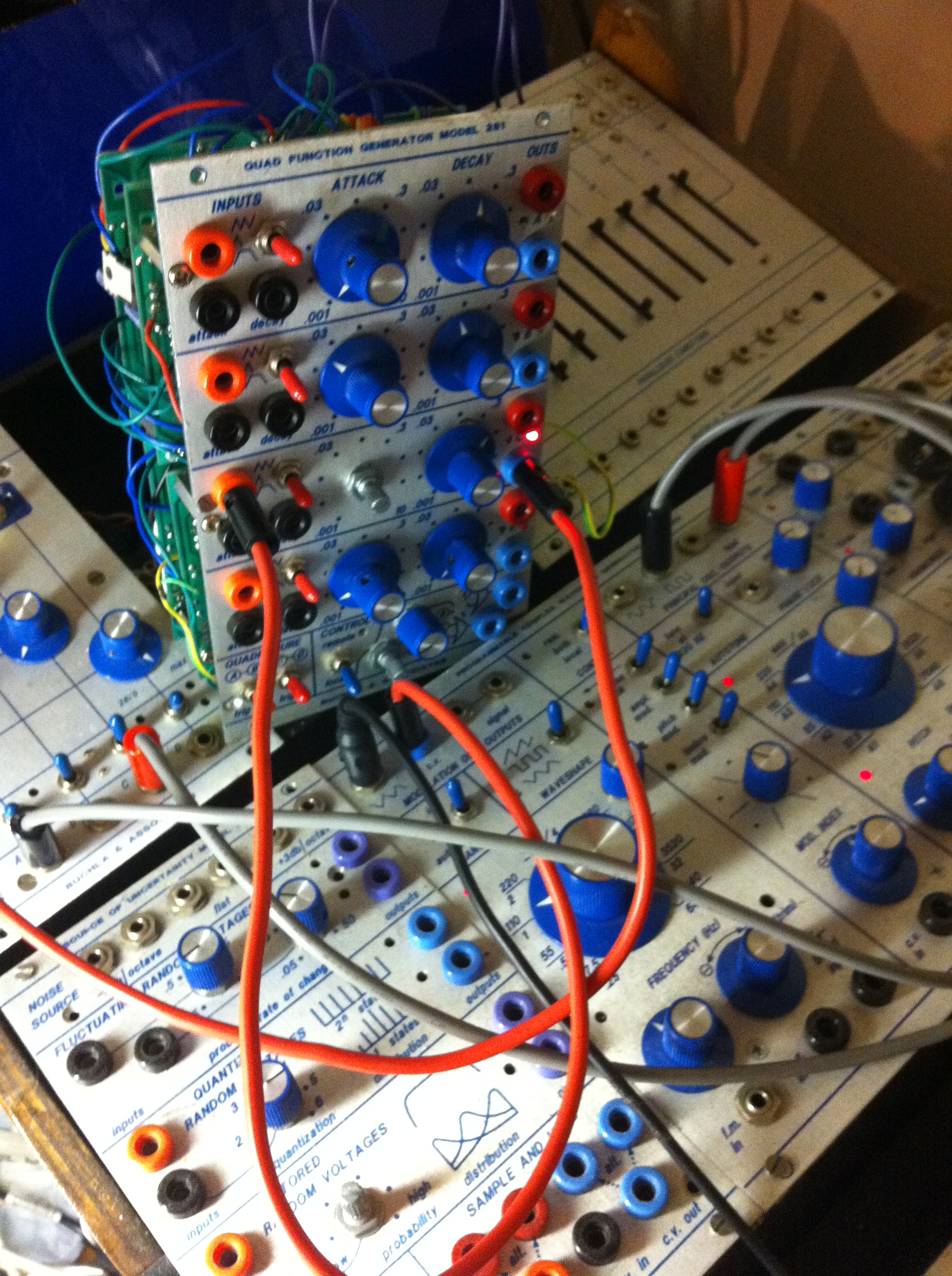

I finished my quad 281 Function Gen some time ago, but I don't know if I've ever posted a photo or anything. I looooove this module. I don't know if mine is perfectly calibrated. Each section does seem slightly different, but everything works great and I couldn't be happier with it.
For one, I love the pulse output. This seems to me to be an End of Attack-stage pulse. Is that what it's supposed to be? Before building I assumed this was End of Cycle-- but in practice it seems more like End of Attack. By using this pulse to trigger additional Functions/envelopes I love being able to set up timed chains of delayed events-- I can imagine this being really useful for bringing a series of delayed reverb or other effects to processed audio signals. I desperately need to make some kind of external input module for this system.
I also really like the voltage inputs on the attack and decay. In practice, so far, it seems like they work more like modulation inputs. Rather than increasing the attack or decay times, it seems like I'm more often able to get modulation on just the attack part of the CV, or just the decay part---depending on which input. This may have more to do with the voltage I'm feeding them. Not sure yet.
It's just great all around and it's inspiring to work with something different from the standard synthesizer tools. That's one general rule that I find very endearing about the Buchla in general.
Enormous thanks to Topp for making this module available to the proletariat, and of course, all props to the man above (DB).
