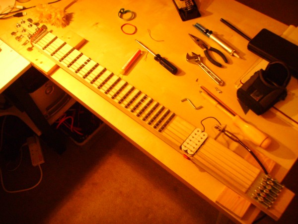

So... I have been working on this on and off. I am not really a guitarist, and can't find justification for spending a lot of money on a tap guitar or stick. So I decided to build one, just to see if I can do it. If it turns out even slightly passable I might make an other one, and an other, until I have a playable instrument. It all depends on how much time I have as well...
This one is my prototype, and I am making everything myself except the pickup and tuning machines. It is as simple as I can possibly get away with. The main goal with this one is to work out how to fret a guitar... I simply glued some 5 mm metal rods on a plank. I may do some modifications on it as I go along, we will see.

As simple as it gets... A piece of poplar, bought at a local wood recycling yard.

Some shaping for the tuning machines and fret positions marked out.

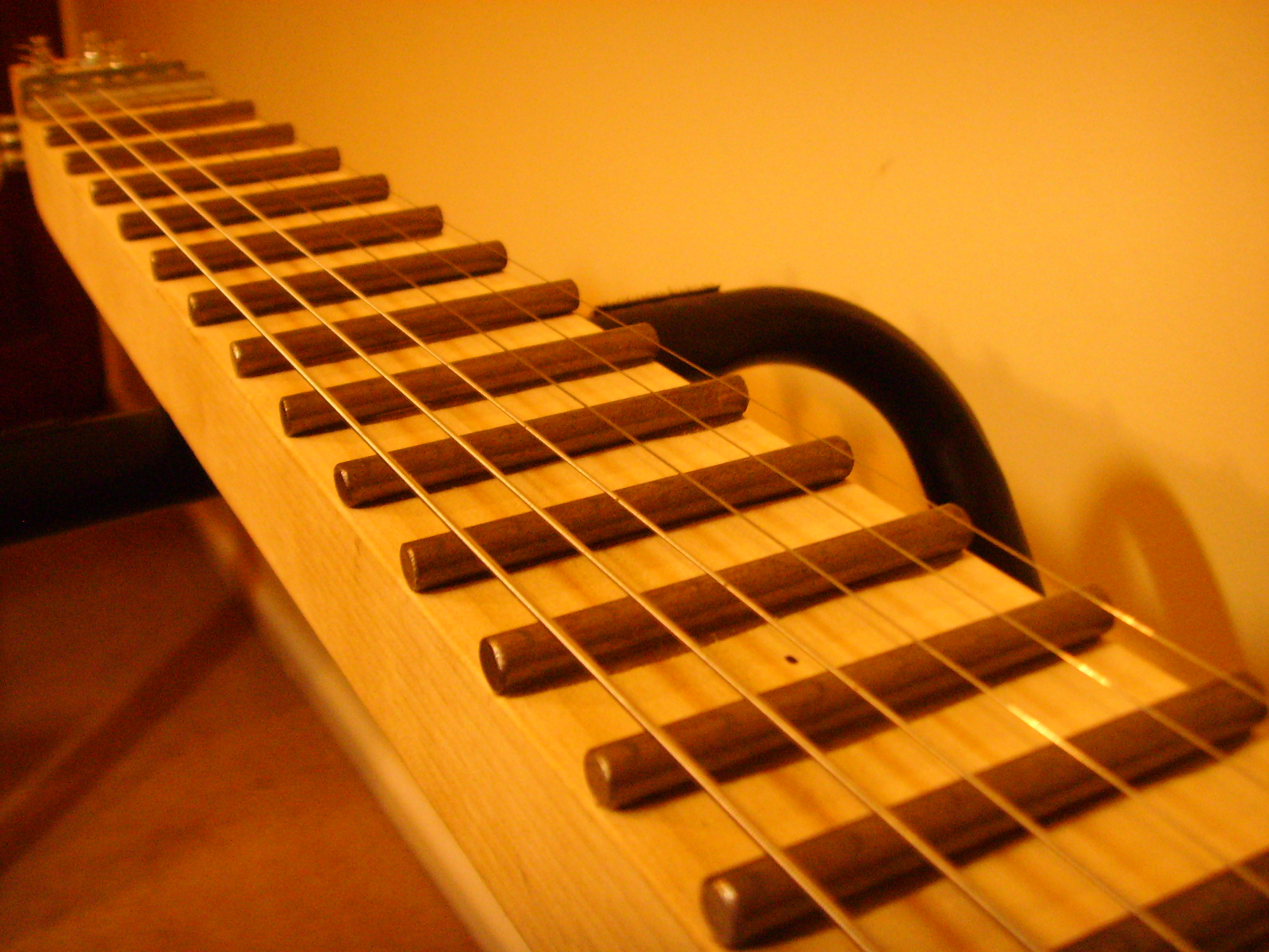

Frets glued on. Yes, they are monster sized.

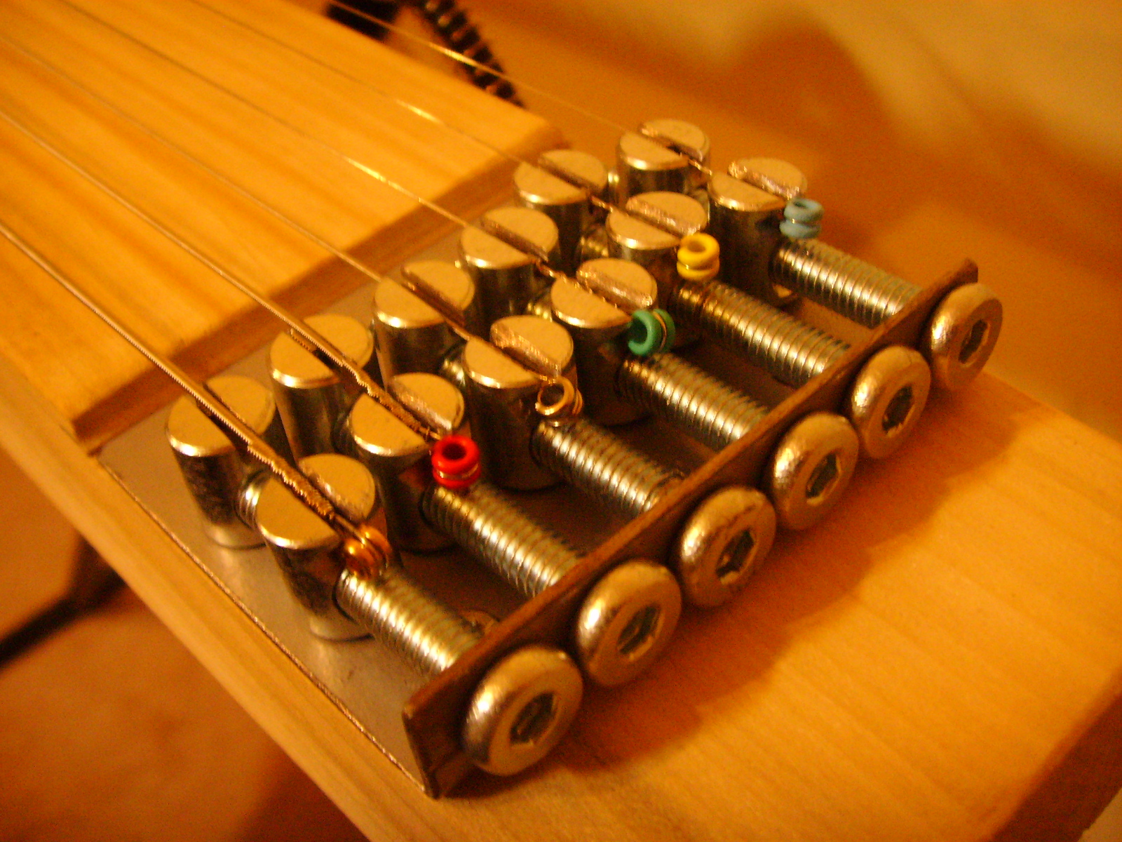

Bridge, courtecy of IKEA parts.

There are a couple of buzzy frets and it is far from perfect, but turned out much better than I had expected.

Jumbo frets, 6 mm in diameter, glued on to the top.

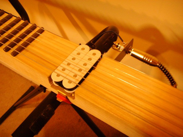

Bridge, with intonation adjustment scews. No height adjustment is possible.
 Filesize:  976.77 KB
 Viewed:  873 Time(s)
Pickup, borrowed from an other guitar.
 Filesize:  992.87 KB
 Viewed:  795 Time(s)

Very Nice Rob! It came out realy well. With regards to the jack....I don't know how thick the wood under the bridge area is, but you might want to see if a jack plate from a Stratocaster could be imbedded in the side. Use a Forstner drill bit to bore the hole to fit the jack and plate in. A jack plate should only be a couple of dollars and will protect your connection. You drill a hole from the pickup cavity to the hole drilled for the jack.

I completely agree, and will get a recessed jack - but probably for the next version. This one is not really meant for anything other than getting started somewhere and the only thing I bought (apart from the wood) is the rod to make the frets out of. Total cost for this instrument amouts to about £7 if you exclude bits and pieces I had lying around and the parts I borrowed from other guitars. I will probably return those parts when done and start afresh on a new instrument where I will pay a lot more attention to it being a playable instrument. At that point I will buy original parts and even rehearse the presision building stages like fretting and related things.

I will however work a little more on this model to perfect the bridge as much as possible and see if I can can get it intonated properly.
