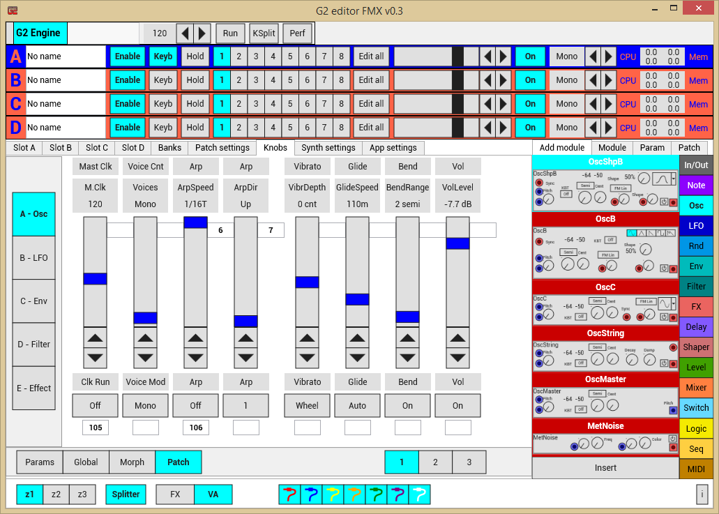

I updated the editor to v0.3 and made the following changes:
- Cleaner and faster termination of the USB connection on closing of the application. This bugged me a long time, but solved this by just sending a reset command to the usb interface on closing.
- Changed the location of the ini file “g2editorfmx.xml”. On windows this will be in the application folder, on Osx this will be in the documents folder.
- Added functionality “Auto assign midi to knobs”. This is for engine owners who want to use an external midi controller.
I tried to make this before on the previous editor by making an extra midi connection to the editor, but I wasn't really happy with it, because you basically had to run the editor all the time, and also the midi connection wasn't very stable.
Now I've implemented it differently, you can assign midi cc's to the buttons and sliders on parameter pages that are stored in the ini file, see picture below.
On the application settings there is a knob "Auto assign midi". If you enable that knob, the controllers are automatically assigned to the parameters associated to the buttons and sliders on patch load.
This means that the "in memory patch" will be modified, because midi controllers are stored in the patch.
- Changed the patch file browsing tree. Sub directories are only read if you expand a directory in the tree, so the application won't freeze if you accidently enter C: as your root patch folder Wink
- A number of small bugs.
- Updated help file: http://www.bverhue.nl/G2editorFMXHelp/G2_editor_fmx_help.html
If you want to try out the editor you can find it over here: http://www.bverhue.nl/g2dev/?page_id=17

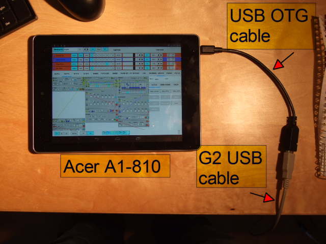

Ok, I managed to get the USB connection between Android and the G2 going Smile
It wasn't as difficult as a I feared, but there are a couple of requirements for the tablet:
- The Android device must support "Host USB" mode
- You need a USB OTG (On the go) cable
I'm happy with this because these Android tablets don't cost a lot of money, I have an Acer A1-810 which supports USB host mode, and costs about 175 euro.
I ran the editor, but the full application is much too slow to be of any practical use and also the screen is too small for the application.
So I'm going to downscale my ambitions for the moment, and first make a simple G2 controller app for Android. I'm thinking loading patches, setting variations and some parameters.
 Filesize:  539.13 KB
 Viewed:  877 Time(s)

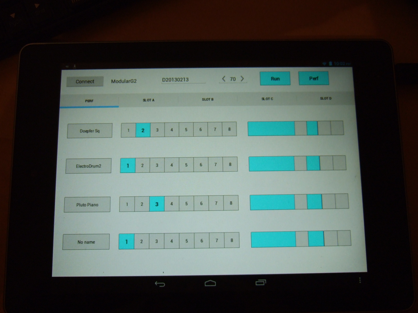

Couldn't resist making a little application Smile
It isn't much yet, just loading patches/performances and changing variations, but it responds well and is just fun to play with.
For anyone interested in the programming part of making the Usb interface working on Android with Delphi, you can find some demo code over here http://www.bverhue.nl/g2dev/?p=65
 Filesize:  614.86 KB
 Viewed:  800 Time(s)

If you have an Adnroid tablet supporting USB Host mode, you can give the application a try. You can download an experimental version over here http://www.bverhue.nl/g2dev/?p=108 and read some instructions how to install and use it.
It's not much more than a controller at the moment, and it may crash now and then, but has some potential.
The problem of the usb interface is mostly tackled, at least, on my acer a1-810. The crashing happens mostly when sending a lot of parameter messages to the g2, for example by moving a slider up and down with high speed, so I had to put a limit of 20ms on that, which in turn causes latency. So that's something that remains to be solved.
Another problem is how to implement a complex patching interface on a small screen and a slow processor.
 Filesize:  137.72 KB
 Viewed:  730 Time(s)

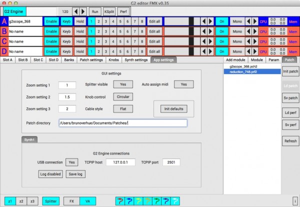

Hey Sven, good to see you back!
I didn't know about that error. I'm on 10.8.5 also and haven't seen that error message.
What have you put in the "Applications settings" "Patch directory" edit box? See image below.
The idea is that you put the root directory of your patch files in that edit box, then if you press "Refresh" on the Patch tab, the directory tree and files should appear. Seems to work o.k. here...
And Xav about your dream, the best thing I can think of is to build some function into the tablet application by which you can easily switch the foot controller between patch parameters. Are you using one foot controller or multiple?
 Filesize:  188.8 KB
 Viewed:  686 Time(s)
Hi, thanks Smile
Actually i had nothing there.. Selecting a folder in my user folder actually fixed the issue.
I however have difficulties to create a path to my secondary hard drives.. Usually i just select them--but how is the path in a written way?
Would be actually nice to be able to select the path with a selector box.. But thats maybe useless comfort since you usually only do such a setting once..

It all depends on what you want to do with the tablet.
I agree that the little acer tablet is not much use for patching, even if I would be able to create the user interface for it.
I want to use it more as a sort of controller for loading patches or assigning controlers, that kind of thing. Maybe usefull for someone with a small mobile setup with a g2 engine.
If you want to be able to edit patches on a tablet, I guess you'll need a windows based one for the moment.
