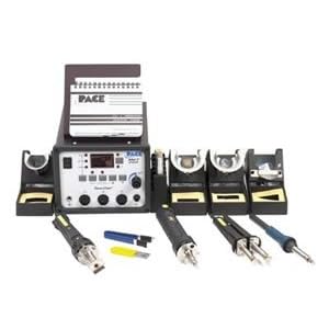

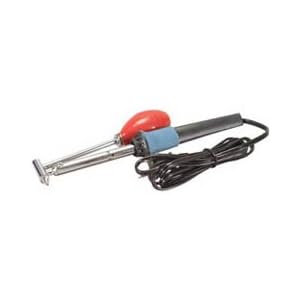

PostPosted: Tue Apr 10, 2012 7:01 pm    Post subject: Reply with quote  Mark this post and the followings unread
Uncle Krunkus wrote:
successfully de-soldering 6*11pin rare slabs of IC and soaking them, and getting them all back in, without doing any further damage,........ is not something I'd be looking forward too! Laughing
If it's not something you're comfortable doing, then you most certainly shouldn't! The key to desoldering is having the right tools. For plated thru-hole boards you most certainly need something that sucks solder. At home I do OK with a bulb iron like this, but for serious stuff I am fortunate to have one of these at my work.

PostPosted: Tue Apr 10, 2012 8:52 pm    Post subject: Reply with quote  Mark this post and the followings unread
Oh I'm comfortable with doing it. It's just not a job I'd take on lightly.
I've done quite a bit of fine work before (I'm also a model maker), and working patiently and precisely is what I do best. But because of the concentration needed, I like to prepare well.
I've de-soldered chips before, but I only have a solder sucker, and solder wick. I'm sure these ICs would be quite heat sensitive, so it would be good to insure a consistent and hassle free approach.

PostPosted: Fri Apr 13, 2012 4:08 am    Post subject: Reply with quote  Mark this post and the followings unread
Okay,
Well I succumbed to completionism and pulled all 6 80017s. And I might say that I'm feeling pretty full of myself too! Cool Laughing
The last two, (which, as far as I know, were working perfectly) I simply covered in solder and yanked 'em out like sore teeth! This took about 30 secs each, as compared to farting around with solder-wick, then solder sucker, try to get a definite release of one pin at a time, method, which often ended in a "drown it in solder and "out you come, you little!!?!"" anyway.
Like you said infindebula, the right tools make a helluva difference. But even with basic means, you just gotta get a feel for the least intrusive method. It's almost like surgery. The medicinal practices oath goes back to ancient Greece. "At the very least, you should do no harm"!! Laughing
Desoldering these kinds of chips definitely flies close to crossing that limit! Laughing
