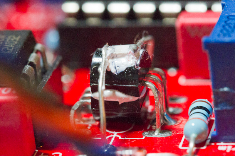

PostPosted: Tue Jan 08, 2013 8:07 pm    Post subject: Reply with quote  Mark this post and the followings unread
If the image is not that clear, the thermal paste is between the flat sides of the transistors...
I'm now wondering if the thermal paste on the tempco has become conductive...

PostPosted: Tue Jan 08, 2013 10:33 pm    Post subject: Reply with quote  Mark this post and the followings unread
OK that looks right to me , oh well it was just a thought .
nice method with the tranny mounting by the way, very neat
but the thermal paste being electrically conductive is possible [some are, though most are not and also to varying degree's, also some are capacitive {a few pico farads}] . It should say if it is on the packaging .

PostPosted: Wed Jan 09, 2013 1:49 am    Post subject: Reply with quote  Mark this post and the followings unread
that's an idea.
i did a quick search in the net, and the whole topic is a known issue for those PC guys.
allmost all thermal pastes are conductive, especially the ones with silver in there. paste with zink oxyde is less conductive (but it still is).
however, there is non-conductive thermal paste available for PC users.

PostPosted: Wed Jan 09, 2013 2:50 pm    Post subject: Reply with quote  Mark this post and the followings unread
if it is the thermal paste being electrically conductive, being smeared all over the smt tempco like that would basically short it out , that would definitely cause a whole bunch of variation with the frequency over time and fits the bill for the most likely cause given the symptoms.
easy to check if a bit tedious cleaning every trace of all that paste off.
for an idea once you get your 2210's
my preferred method till now has been with socketed ssm2210 with the tempco underneath inside the socket, I either melt a couple of slots in the ends of the socket for the leads or use 2 rows of machined SIL pins , means the chip is still easily removed if need be , but you do have to get the height of the tempco right very slightly above the socket height and with a little extra length on the leads which gives the tempco some spring to press against the underside of the chip. With an smt tempco as you have used this should work fairly well as there will be good surface contact and temp changes from stray cool air is minimised by the socket body and chip
thermal paste should not be needed at all in that case.

PostPosted: Wed Jan 09, 2013 3:48 pm    Post subject: Reply with quote  Mark this post and the followings unread
Well I de-soldered the tempco, wiped off the thermal paste, and re-soldered it. I have allowed it to run for a few hours to hopefully stabilise before making any dependable tests.
Now the wave does not jump around like crazy like it did (jerking from one frequency to another like a demented sample and hold unit). However the pitch is increasing and decreasing gradually like there's a really slow and subtle LFO controlling the pitch. So omitting the paste seems to have alleviated the main problem, but it's not cured it completely. Better, but still not usable...

PostPosted: Thu Jan 10, 2013 3:20 am    Post subject: Reply with quote  Mark this post and the followings unread
Wouldn't you get more accurate tracking by sandwiching the tempco between the transistors? Confused
You really want the tempco to be enveloped by the temperature of both transistors. As it is, one side of the tempco is tracking one transistor, and the other side is tracking the air temperature above it. The temp of the lower transistor is probably not affecting the tempco very much at all.
I'd clean all the paste off everything, butt the tempco leads off the ends to keep it nice and slim, and put it between the transistors. Keep the position of the transistors almost the same as it is, just bend the lower one down slightly, upper one up slightly, thus making a very thin slot between them for the tempco.

PostPosted: Thu Jan 10, 2013 3:55 pm    Post subject: Reply with quote  Mark this post and the followings unread
Well, I got one working, after cleaning the thermal paste from the tempcos (I left the paste sandwiched between the transistors). The fluctuations looked huge on the scope, but in fact they were minuscule when I linked them up to audio.
The other 3 have developed other faults somehow in all the messing about...

I forgot to mention, I also swapped out the 4046 for a spare on all boards, it didn't seem to affect anything. I didn't change any wiring (bear in mind these were all working perfectly when I first built them - before the paste turned sour)...
