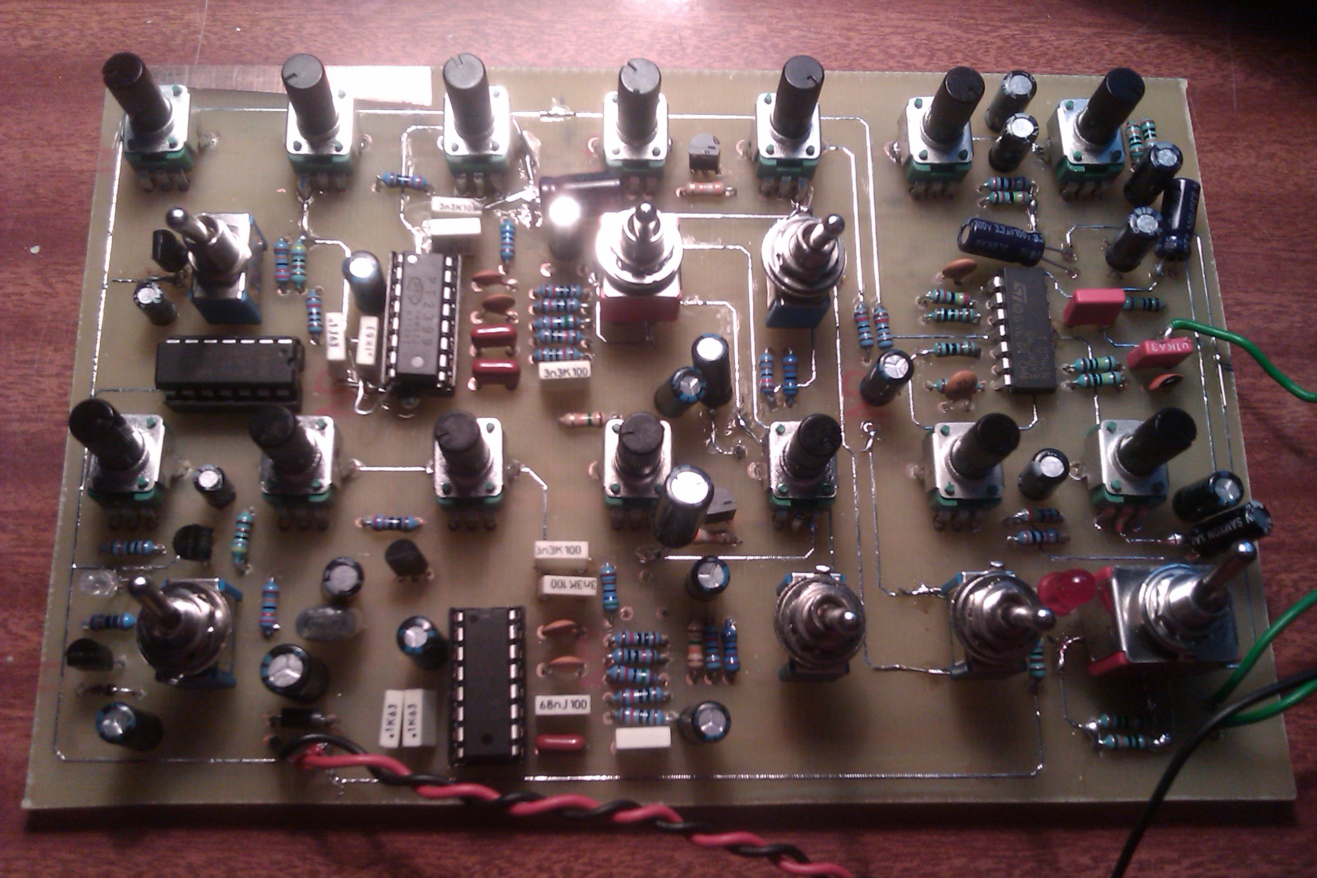

HI!
Here working on a Pseudo stereo (1 in 2 outs) delay with modulation, an LFO. The Jellyfish.
It's capable of single delay lines, stereo lines, stereo expanding (just one repetition and very short but different delay times per channel), vibrato and stereo vibrato, something like reverb, and lots of weird noises.
The LFO is modulating the delay time and has triangle and square waves.
Theres is a fine control (time) for adjsuting the effect qhen doing some stereo xpanging.
Individual Dry and Wet controls for using only the effect when requiered (vibratos)
A switch for combine the two channels in a single output (parallel).
And that's it. I will do very easy to mount PCB's with directly to PCB pots. The photo is the first prototype. Still need the clear some errors.
I'm thinking to put a send/return into the delay for experimenting with other effects inside the fx. Just imagine some effects repeated with the feedback. Also thinking to put a CV in for control the delay time. Any thoughts?
Here a photo of the prototype and some demos. Just finished today!!!
http://snd.sc/ZZoetd
The controls are (in order): LFO Rate, Depth, Time, Fine, Feedback, Wet, Dry.
Any suggestions / comments?
I will do a batch of 50 PCB when finnished.
Still working on the centipede sequencer!

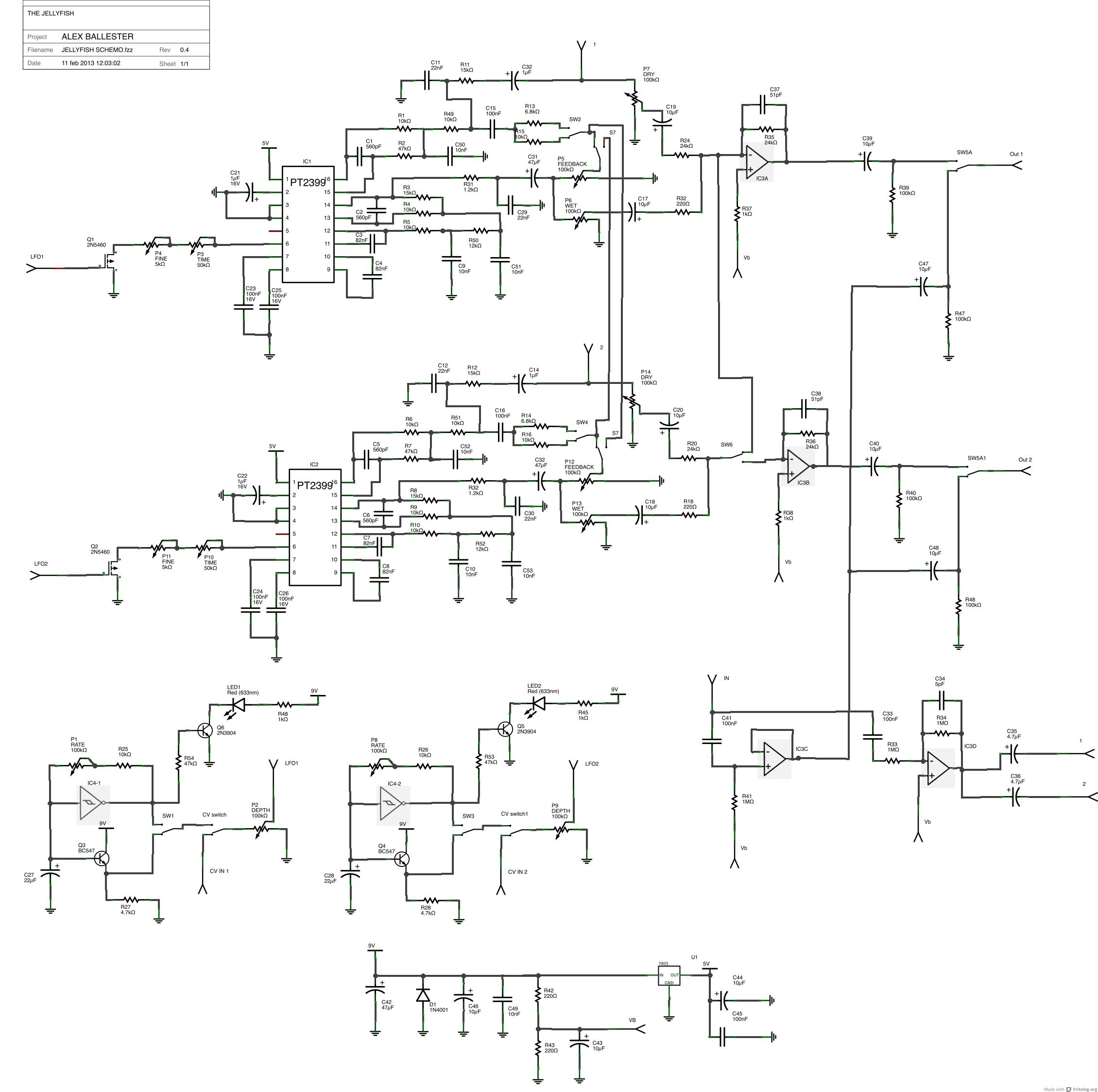

here is the schem. A bit of explanation:
The delays are based on the PT2399 chips. The circuit is very close to the one that appears in the datasheet. Diferences are some filtering changes, the independent dry and wet controls, and the switch (SW2 & SW4) that changes the feedback resistor. This switch select between infinite and non-infinite repeats and works different than the feedback pot.
LFO's are simple 40106 circuits with the add off NPN and a resistor that transforms the square wave to triangle wave. A switch (SW1 & SW3) is provided for select between the 2 wave types getting a wide variety of results. The modulation of the delay is thru a transistor working as a resistor. In this case I have take the same formula as one delay that is on the net (echobase) but the circuit is pretty simple. There are a lot of ways to do this. There is a website with many circuit examples for doing this.
The delay time is controlled by a 50k pot and a Fine 5k pot. This one is very usefull when adjusting the delays in stereo mode providing cool effects.
With Switch 6 is possible to send the second delay to output 2 or mix it with the first delay to the output 1. With this is possible to use the effect in mono and parallel.
Switch 5 active the effect on and off. In "off" mode a buffer sends the input signal directly to outs 1 and 2 without impedance issues.
And thats it! Smile
Maybe I will add a CV in and a send & return pair in the feedback. The S&R will be very simple as it will not have buffers but I thin that it can work with short wires.

PostPosted: Wed Nov 21, 2012 5:13 am    Post subject: Reply with quote  Mark this post and the followings unread
That looks like a really cool project papaver.
I've been wanting to do a similar thing with the MN series of BBDs for a long time, but haven't found a circuit I like yet. Crying or Very sad
One thing I would definitely recommend, is a swap over switch (DPDT) on the feedback lines straight off the wiper of the pot. So you can literally send one delay to the other one's feedback input, and vice versa, and back again. At slower delays, this sounds really nice.

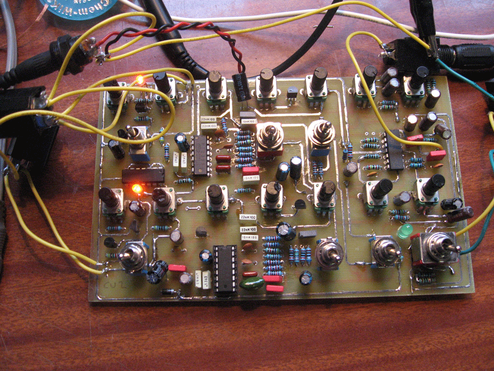

Have a problem here.
I'm finishing next the next PCB with the crossdelay (from UNcle Krunkus) the send and return jack and all the switches soldered directly to the board.
The problem is that the on/off switch is doing a pop sound when switched. I have put a 1M resistor to the output cap but the sound is there anyway. Maybe the leakage of the cap?
Any sugestions here?
papaver
Joined: Sep 18, 2009
Posts: 68
Location: Barcelona, Catalunya, Spain
PostPosted: Thu Dec 20, 2012 4:36 am    Post subject: Reply with quote  Mark this post and the followings unread
Solved!
I have finished the next prototype and it works fine. No clicks or noises when switching.
The crossdelay function is really nice and open a world (thanks to Uncle Krunkus).
Added leds to the on/off switch and to the LFOs.
Waiting for the stereo jack connectors with switch for test the send and return feature.
Then I will restructure a little bit the position of the items, improve the filter section, make a final protoype and thats it!
News soon... Very Happy

So in the final design:
- I have added more filtering, lowering the cut frequency on the existing ones and adding two more filters per channel.
- The crossdelay function is implemented. You can see with Switch 7 (2 pole). When activated the feedback signal of delay one is sent to delay 2 and viceversa. This causes a nice effect similar to having to delays in series but a little more usefull as you can avoid part of the filters when the signal is going from one channel to the other.
- Finally I have not added the send and return section as it needs to be buffered and there is no more room in the PCB if I want to keep the things easy for the begginer DIYers (all the pots and switches are in the exact place and there is no need to run wires for this items).
- I have changed the modulation section. The old one was the same that there is in th Echobase delay. But this one have a problem that's when you turn up the depth knob you're increasing the resistance of the delay section, so you are increasing the delay time even if there is signal incoming. So if you have determined an usefull delay time and then you turn up the deph knob to create some modulation you are loosing the usefull time.
Instead of the PNP mod I have used a P-channel Jfet. This is very usefull and easy to implement. With the Jfet the resistance in the drain increases as the voltage on the gate increases too. The voltage on the gate have to be more positive than the voltage of the source. So as the source is grounded the input signal can not be below 0.
Using this method as you turn up the depth knob the delay time keeps in the same centered place.
- Added CV inputs. the CV input goes directly to the depth knob. It uses a switched jack so when a jack is plugged in the signal comming from the internal LFO is deactivated. It's important to keep signals from 0 to 9V here. The depth knob acts as a voltage divider for the incomming signals.
And that's it!
I'm correcting all the number and value mistakes and designing the final PCB, si this will come very soon... Smile bom

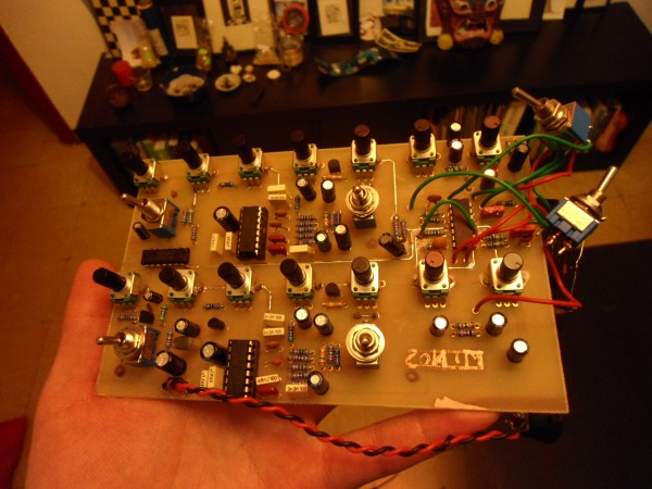

PostPosted: Thu Feb 21, 2013 3:15 am    Post subject: Reply with quote  Mark this post and the followings unread
Finall prototype.
This is woring very well. I'm happy with this!
demos soon!
 Filesize:  526.59 KB
 Viewed:  510 Time(s)

I really like this design and I have to build one some time. I finally got a load of PT2399s from Tayda, as you suggested. I'll probably try breadboarding a simpler design at first (e.g. the Deep Blue Delay), as a quick test to check the ICs (although I'm pretty sure that they're OK).
One question. You have used a 7805 in your circuit. Do you know if this is necessary, as I've seen 78L05s in other designs. I looked at the datasheet, but I couldn't find a typical power consumption value on it. It doesn't really matter, as I have both regulators anyway.

PostPosted: Thu Feb 21, 2013 11:42 am    Post subject: Reply with quote  Mark this post and the followings unread
Hi Gary!
I'm using a 78l05, there is a mistake in the schematic. Rolling Eyes
I have mounted the PCB into a blank drilled cases and I have found some mechanichal problems. First, the switches are to high and there is no room for the alpha pots to appear outside. The second, again the switches puts the PCB to close to the bottom of the case and there is very little room for the jacks.
I need to find some super mini switches to replace the existing ones or find another solution.
So I think that this will take longer. Evil or Very Mad
Ah, that's why I couldn't see any TO-220s on your PCB! I have seen PT2399 circuits using 7805s, but it always strikes me as unnecessary. Perhaps that's all they had at the time.
As for the mechanical problems, I've certainly been there before - very annoying Laughing
