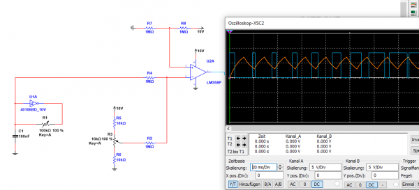

Hi! I've been experimenting with the circuit to achieve some PWM effects with my 4093 square waves.
It works great for low frequency triggers (100k pot 10uf cap) meaning I can go from tiny pulses to the full width of the original trigger. Super useful for triggering short notes.
But when I've tried to use it with audio range (100k pot, 100nf cap) I have a problem of there only being a limited range where the full pwm "phasing" or "beating oscillators" effect is noticeable.
I had more success with a high pass configuration (reversed from Phobos' schematic, so resistor to ground, cap in series). If I've understood correctly and using my scope this is because the filter that slows down the wave at lower frequencies doesn't slow it down enough and at too high a frequency cuts off altogether.
I've tried a couple of variations - 10k and 100nf in the filter for example. Or 47k and 22nf (just various combos I've got to hand) but all have the same problem.
Is this just an inherent limitation of that particular circuit? You can't get a filter that serves all frequencies? Would the sort of active filters built with 4069/4049 be better? e.g. https://hackaday.com/2015/03/25/logic-noise-filters-and-drums/
(these are on my to build list, but I wanted to get an oscillator design that I'm happy with going first). I know I could just breadboard it up but if someone can stop me going down a blind alley...

i would expect that, like in a 40106, in a 4093 osc is also a tri like wave to find.
and if so, you could use an opamp
opamp Shocked lunetta

Posts: 5881
PostPosted: Thu May 05, 2022 12:51 pm    Post subject: Reply with quote  Mark this post and the followings unread
I'm sorry
I'll allow it Laughing (can't speak for anyone else)
Although it's not a clean triangle but something a bit more exponential, it should work I think. neat.
I'd just use the non-inverting input for the reference voltage though. An inverted output wouldn't really matter
and can easily be (re-)inverted anyway. Also easy to add CV to it.

I remember vaguely, back in the days .... (Where I barely understood an opamps work)😃 that I had some trouble on the yusynth VCO PWM, which Mixes the CVs on the non inverting input.
Then I saw the Formant PWM , which uses the inverting input for Signal and the two CVs, lokked easy and elegand, tryed, worked well, since then I always use this topology.
Always happy to "see" you and the guys still around here
For a summing mixer yes, using the inverting input does have less drawbacks and is just easier to use.
For a comparator I don't think it matters much. it just compares the voltages on both inputs.
well in theory anyway with a perfect opamp, there might be some practical benefits I am not aware of.
To be clear, when I said "I'd just use the non-inverting input for the reference" I meant instead of the fixed voltage created with R7/R8.
