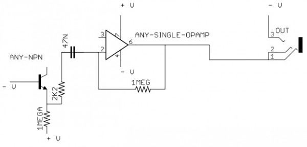

PostPosted: Mon Apr 01, 2013 10:06 am    Post subject:  DIY NPN Transistor Whitenoisegenerator from scratch
Subject description: npn reverse bias junction
NPN Whitenoise generator with opamp amplifier
NPN Whitenoise gen with opamp amplifier

PostPosted: Thu Apr 04, 2013 4:15 am    Post subject: Reply with quote  Mark this post and the followings unread
To make the video of the breadboard it is a very nice the idea! Very Happy
May I ask why you didn't connect the op-amp's non inverting input to ground?

2kohm
Joined: Feb 19, 2013
Posts: 52
Location: germany
PostPosted: Thu Apr 04, 2013 10:47 am    Post subject: Reply with quote  Mark this post and the followings unread
Thank you guys Smile
one blemishes Smile but it makes no audible difference.
yes! i used the UA741 veteran Smile tested also with lm324 tl072 tl07X.
I think every singel opamp works!
15 v not tested but i think it works also

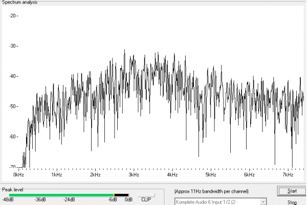

Spectrum
 Filesize:  32.63 KB
 Viewed:  579 Time(s)
Ableton view
 Filesize:  18.68 KB
 Viewed:  565 Time(s)
Abelton view
 Filesize:  63.76 KB
 Viewed:  564 Time(s)

Cynosure
Joined: Dec 11, 2010
Posts: 1000
Audio files: 82
PostPosted: Thu Apr 04, 2013 3:23 pm    Post subject: Reply with quote  Mark this post and the followings unread
Nice! Thanks for posting the response charts.

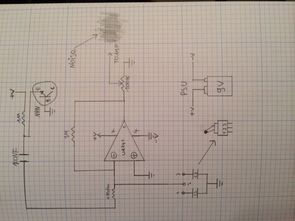

2kohm
Posts: 52
Location: germany
PostPosted: Tue Feb 04, 2014 2:50 am    Post subject: Reply with quote  Mark this post and the followings unread
hi,
try the Transistors 2N2222A and BC457
C2 = 47N
C3 = 27N
for different noises
noise schematic

beesontoast
Joined: Feb 03, 2014
Posts: 7
Location: SW UK
PostPosted: Tue Feb 04, 2014 4:16 am    Post subject: Reply with quote  Mark this post and the followings unread
Thanks - I will play some more.
One thing though - you have + (pin 3 on a 741) on the op-amp going to ground on that diagram...
Your drawing of a PP3 also shows reversed polarity...
2kohm
Posts: 52
Location: germany
PostPosted: Tue Feb 04, 2014 4:23 am    Post subject: Reply with quote  Mark this post and the followings unread
that makes no difference for me

beesontoast
Posts: 7
Location: SW UK
PostPosted: Tue Feb 04, 2014 5:19 am    Post subject: Reply with quote  Mark this post and the followings unread
I can make some pretty weird noises by coupling it to a 386 op-amp and ignoring pin 3 as per the original circuit - something like a cow with bellyache attacking a duck...
But nothing remotely like white noise.
Oh - I also made a pretty fair EMF detector by putting a coil and a 100nf in series between pins 2 and 3.
2kohm
Posts: 52
Location: germany
PostPosted: Tue Feb 04, 2014 5:56 am    Post subject: Reply with quote  Mark this post and the followings unread
which transistor did you use?

beesontoast
Posts: 7
Location: SW UK
PostPosted: Tue Feb 04, 2014 6:19 am    Post subject: Reply with quote  Mark this post and the followings unread
I tried a PN2222, BC517 and currently BC547B.
beesontoast
Posts: 7
Location: SW UK
PostPosted: Thu Feb 06, 2014 1:06 pm    Post subject: Reply with quote  Mark this post and the followings unread
I have solved the problem I had with the first circuit by adding in a potentiometer, and it turns out with a resistance of about 240 ohms I get white noise in a single 16 ohm earpiece.
(added) It turns out that a small electrolytic in that position also does the job.
