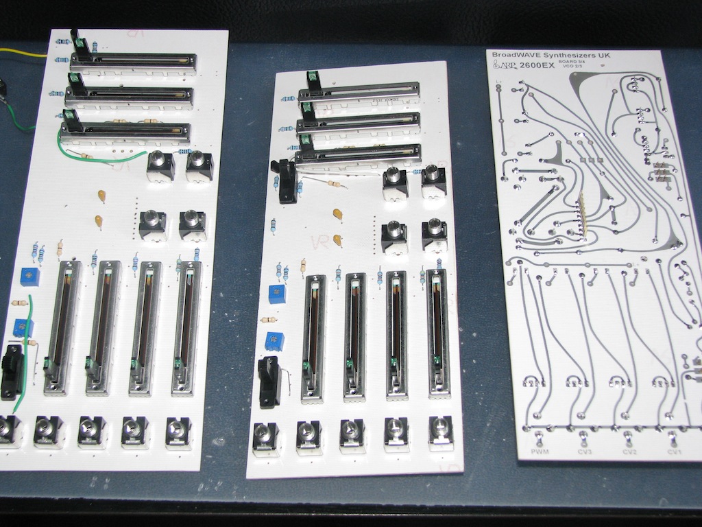

Just a teaser, but I'm well underway with my 2600EX clone (expanded... take a peek at the VCO's) Very Happy
I'll backtrack on the initial build later, but I'm just to excited at the moment to sit down and write up a synopsis of what I've done so far.
This is in no way competition to the TTSH project, as it's a one off that's taken 5 years to get this far!!
More to come...
Basic cabinet build with laser cut and two colour screen printed panel
 Filesize:  329.81 KB
 Viewed:  581 Time(s)
Full VCO's with sync (OSC 1 to 2 &3)
 Filesize:  330.1 KB
 Viewed:  497 Time(s)
VCO 1, 2 & 3 "Carrier" PCB's
 Filesize:  255.04 KB
 Viewed:  503 Time(s)

I did all the panel graphics in Adobe Illustrator - 3 layers:
1. Laser cuts
2. Orange graphics
3. White graphics
I had the panel Laser Cut in 1.5mm Mild Steel, by Cutting Technologies in Barnsley, UK (£120.00). Then it was powder coated in satin black by Ashton Powder Coating, Manchester (£35.00), and finally a two colour screen print by MRT in Stockport (£145.00).
MDF was cut at B&Q (£28.00), Tolex, glue and case hardware came in at £53.00
So, the cabinet and panel alone came in at a total of £381.00
I have most of the components I need, just a few odd value resistors, caps and trannies to get.
The main problem I had was the size of the PCB's I could make, as my UV box can only take a maximum board size of 250 x 150mm (which is why the VCO's are on separate boards).
Busy today with the 4012 VCF... having a problem with the CV inputs at the moment - not able to scale the keyboard CV to 1v/Oct, so I'll probably have to fiddle with a few resistor values to bring it all in line Sad

Completed the cabinet and mounted the PSU Smile
Preamp, Envelope Follower, Ring Modulator, VCO's/Waveshapers and VCF all completed and working great.
Spent way too much time with the slider LEDs!! I usually use a 1.8k resistor for 15v, but the stock green LED on the slider is far too bright (don't fancy being blinded by 57 of them)... Took a leaf from my Odyssey Lumina upgrade and swapped out the R's for 27k - much better.
By a happy accident I found that the slider LEDs are removable, so I've purchased a bunch of 4x3mm blue LEDs to see what they look like.
Today, I'll be drawing up some of the remaining PCB's for the Amp/Env/Mixer.

PostPosted: Fri Jul 12, 2013 10:14 am    Post subject: Reply with quote  Mark this post and the followings unread
@isak - Sorry, but I won't be doing much after this build... I desperately need a break Smile
I may put a PDF together with complete details and PCB foils for all the "carrier" boards and 40 series modules (along with corrections to the ARP service manual - quite a few mistakes there!)
I'm off on holiday a week tomorrow for 14 days, but I'm forging ahead hoping to get it completed before I go.

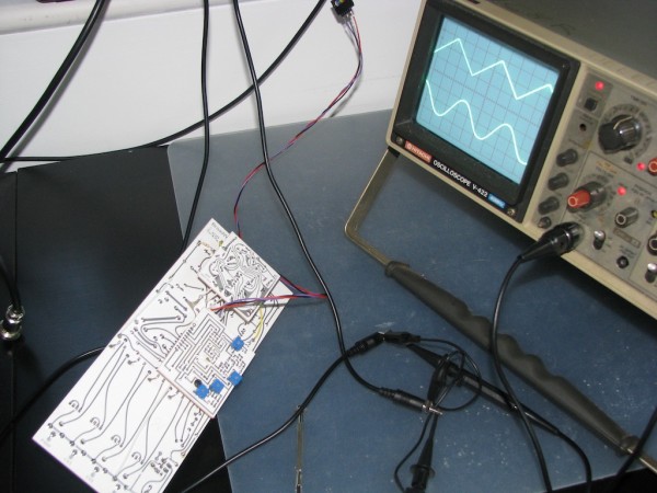

Testing the wave shapers - nice Triangle and Sine... can't get rid of the glitch, but the original VCO's have that too
 Filesize:  219.69 KB
 Viewed:  395 Time(s)
Saw and Square waves... No problems here : )

LED's on the VCF section - much better with 27k (waiting for the blue ones)
 Filesize:  410.05 KB
 Viewed:  395 Time(s)
Just a few more boards to do... The keyboard is something I did a few years back, needs rebuilding into a decent case.
