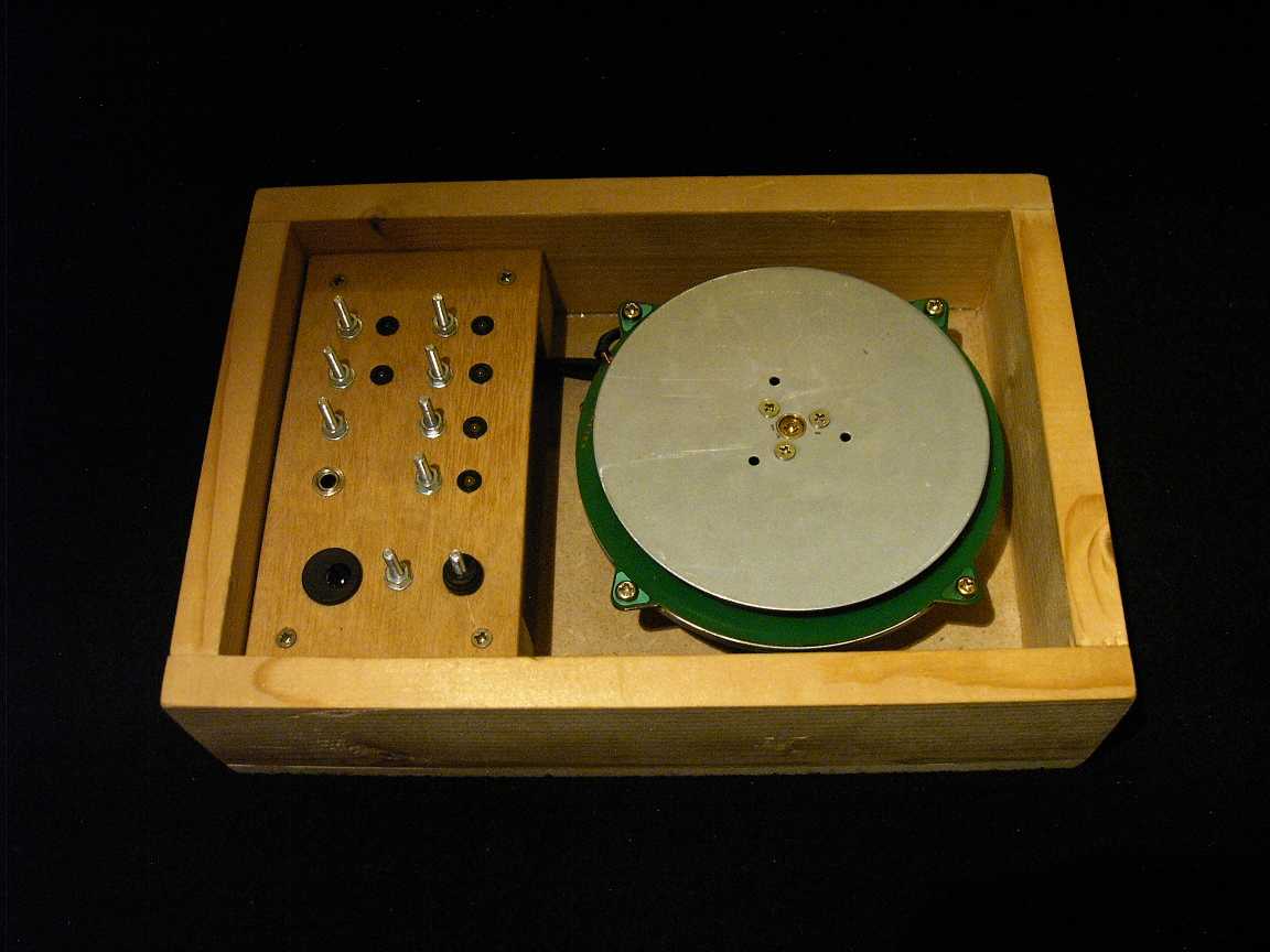

PostPosted: Sun Aug 31, 2014 3:51 pm    Post subject: Circle to Square converter Reply with quote  Mark this post and the followings unread
I turned a motor from an old printer into a rotary encoder Cool
more info here.

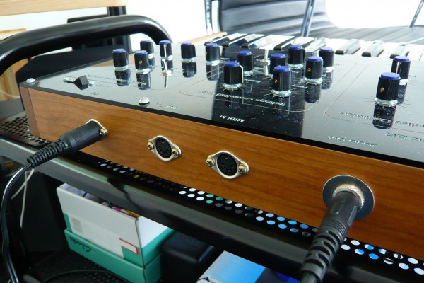

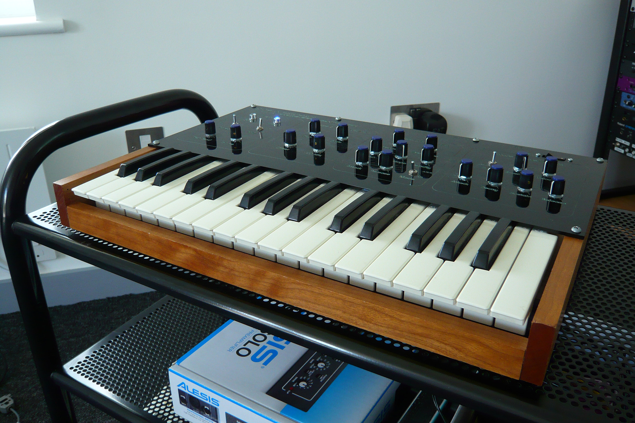

PostPosted: Thu Sep 11, 2014 12:19 pm    Post subject: Reply with quote  Mark this post and the followings unread
Finally got around to finishing my PAiA Fatman Very Happy
I cheated and bought a pre-built one from eBay for about £100 - would have cost me nearly double that to import the kit from the US though. Final build cost for the entire thing was about £150.
The case is solid cherry and I laser cut the panel from 5mm acrylic. Keyboard guts are from an old Roland controller. The sound is fantastic, really nice filter and the ability to assign the keyboard velocity to the VCF and/or the VCA is especially useful.

PostPosted: Thu Sep 11, 2014 10:00 pm    Post subject: Reply with quote  Mark this post and the followings unread
That Fatman is hugely impressive. I take it you infilled? I've come across pedal builds where plastic was lasercut -- on the back side (mirrored), through a layer of paint.

PostPosted: Fri Sep 12, 2014 12:51 am    Post subject: Reply with quote  Mark this post and the followings unread
Thanks for the comment.
I didn't need to infill the plastic, as acrylic tends to go white when its laser engraved - showing up very nicely against the black background.

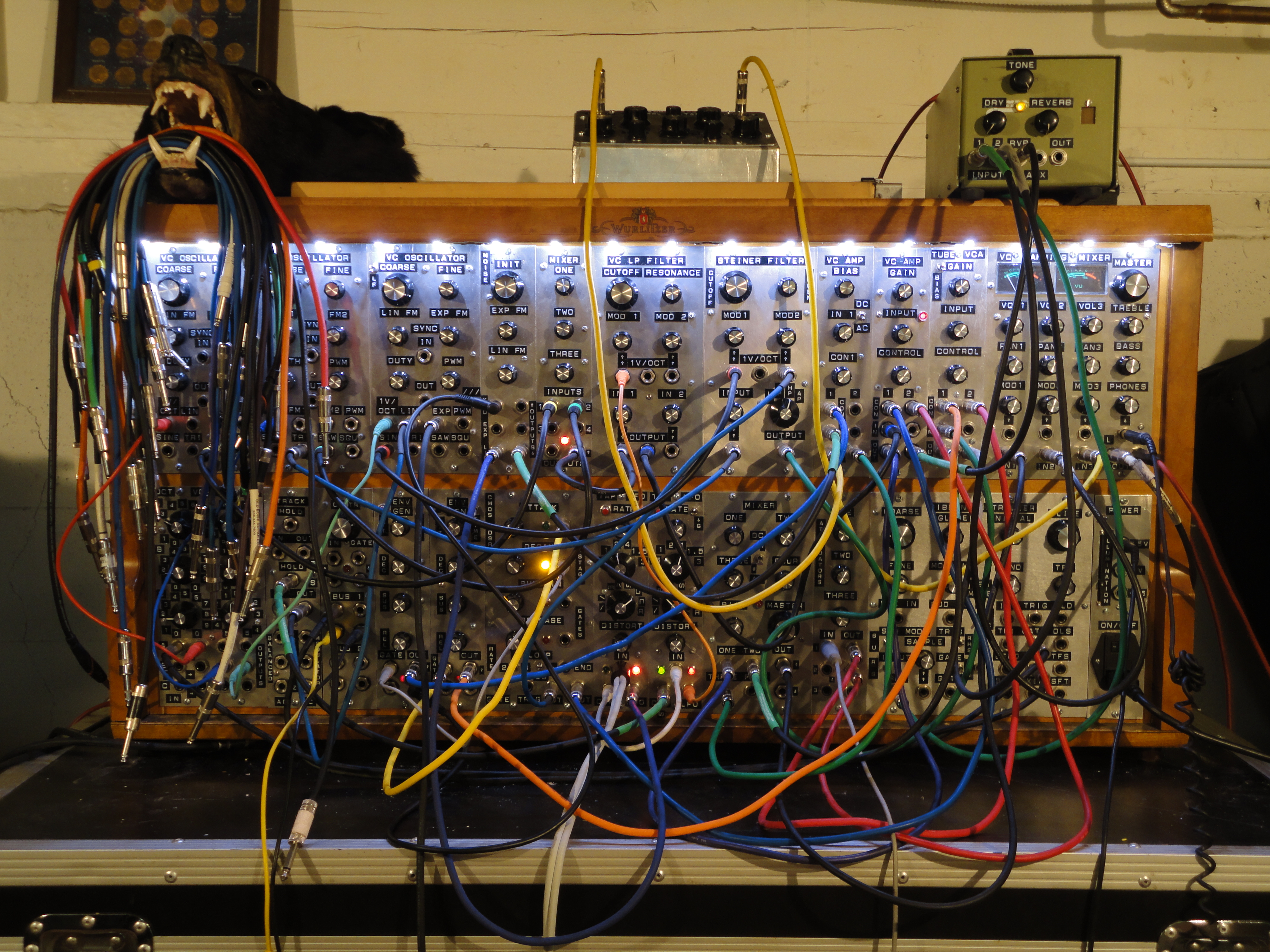

PostPosted: Tue Oct 14, 2014 8:11 am    Post subject: Reply with quote  Mark this post and the followings unread
I finished a modular earlier this year. The cabinet is repurposed from an old Wurlitzer organ that someone was throwing out. The two project boxes are also repurposed. They are a spring reverb and a VC delay.
List of modules:
-Top-
Custom VCO based around ARP 2600 core discrete design and waveshapers x3
Thomas Henry VC Noise
Yusynth ARP Filter
Yusynth Steiner Filter V.2
Audio Mixer
Thomas Henry VCA
Yusynth VCA
GS65 Tube VCA
Yusynth Panning Mixer
-Bottom-
Yusynth Standards
Custom S&H/G&H/Yusynth Ring Modulator
Custom Utility module comparator/gate bus
Yusynth ADSR
MFOS ADSR
Thomas Henry Blinking Lights Fonik outputs
Electric Druid Tap Tempo LFO x2
CV Mixer
Attenuators
Appendage Ribbon Controller
Power module w/ LED fader

PostPosted: Tue Oct 14, 2014 9:41 am    Post subject: Reply with quote  Mark this post and the followings unread
Great job Benjamin!
Looks like a DIY at its best!

PostPosted: Tue Oct 14, 2014 10:07 am    Post subject: Reply with quote  Mark this post and the followings unread
looks and sounds great isak Very Happy but what's the big knob on the side for ?
Nice patch cable storage Benjamin AM Twisted Evil (nice synth too!)

PostPosted: Tue Oct 14, 2014 11:09 am    Post subject: Reply with quote  Mark this post and the followings unread
I LOVE the patch cable holder Smile Smile Smile , help to scare away unwanted visitors to the synth. hehehe
Cool.

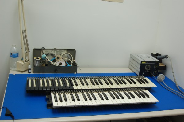

PostPosted: Tue Oct 14, 2014 6:16 pm    Post subject: Reply with quote  Mark this post and the followings unread
Just my humble beginnings,
Clean lab/assembly area not always like this. Been may years since I did any from scratch audio/muzak building. Figured I'd start off with an input device picked up a couple of manuals from a friend one is Lowery the other is Hammond, don't worry it was a nasty 70's Piper altho "revolutionary" they were a horrible sounding temperamental LSI thing . Have to figure something cool to do with the black keys since they're on a separate bus. Have lots of ideas floating around just need to get time to put it all together.
