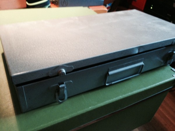

So I just came into possession of a bunch of old slide cases, the kind that hold the old color slides. Basically its a small metal suitcase, the perfect size for a WSG. But its not aluminum, I think its actually made out of steel, magnets stick to them.
MY QUESTION IS THIS: Can I use an all metal case like this to house electronics or will it be too conductive and futz up all the stuff?
Thanks for any help, I do appreciate you guys taking the time to help noobs. I have additional questions but this one is foremost on my mind at the moment.

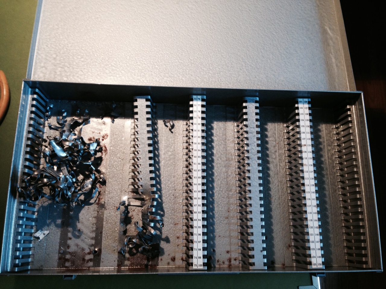

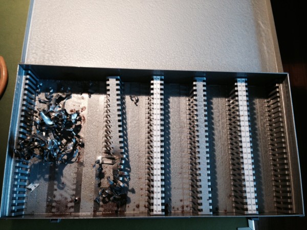

Here is one of the boxes. I've started ripping out the slide slots. Thankfully they don't seem to be warping the bottom and pull out surprisingly easy, though very messily.
What I would like to do, if it all fits, is center a speaker right in the middle then put one oscillator section on each side with the low pass filters across the bottom. I'll mock up a layout soon and post that as well. Guess I'll turn this into a build blog thread.

PostPosted: Tue Aug 19, 2014 5:17 pm    Post subject: Reply with quote  Mark this post and the followings unread
It should be doable; you want to make sure you don't have the PCB touching any metal surfaces other than perhaps on standoffs (which could be metal, as long as they don't short to anything on the PCB.
I would question whether you'll have room for a speaker and the PCB though, depth wise. Even with 1/4" standoffs on the bottom, there are components that will stand another 1/2" above the PCB, so you're looking at 13/16" or so from the bottom just to house the PCB. I have a similar slide box that I want to do something similar with, and I don't think it's more than 1 1/4" deep, so that leaves you very little space for a speaker.
Additionally, you'll need a small amp to drive a speaker, you won't be able to hook it directly to the WSG.

PostPosted: Tue Aug 19, 2014 5:55 pm    Post subject: Reply with quote  Mark this post and the followings unread
Of course! ThePCB! In my mind I was splitting the pots off to the sides so the speaker would have space but I forgot about the PCB. Oh well, the speaker idea was iffy at best but I thought I'd at least consider it. I'm still not convinced there is enough depth to do this as a inside build, I want to be able to close the lid on it. I'll see once the parts get here, I may just revert back to my original design idea once I see it all in person.
Thanks for the tip though, I'll be sure to watch my placement.

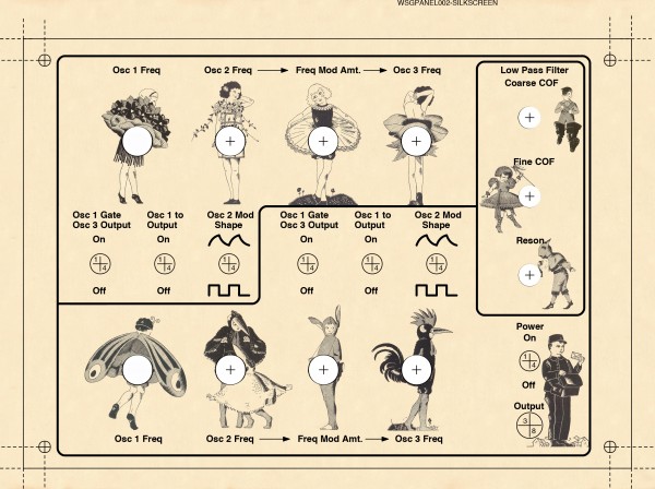

Designed a front plate that amuses me greatly. Found these characters on a site dedicated to old french commercial art, mixed in the WSG plate design and some photoshop and, well, yea.
I feel like I want to change the text somehow but I still want the device to be labeled for my own benefit, haven't figured that part out yet, any suggestions will be entertained.

PostPosted: Wed Aug 20, 2014 3:07 pm    Post subject: Reply with quote  Mark this post and the followings unread
looks great Very Happy
but keep in mind that if you add knobs you probably won't see all of it (depending on the size of them).

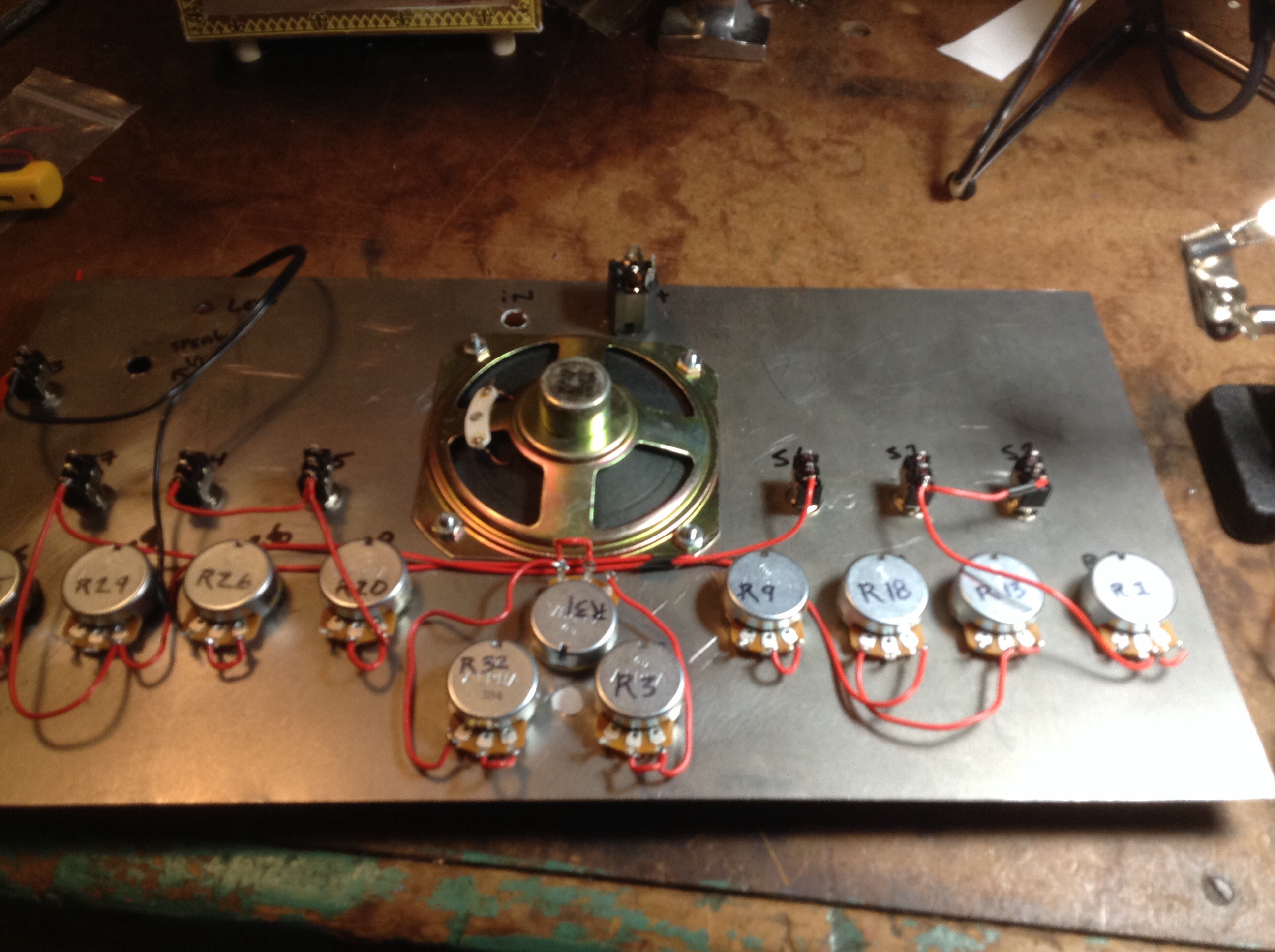

PostPosted: Fri Aug 22, 2014 5:31 pm    Post subject: Reply with quote  Mark this post and the followings unread
Well my littlest helper wanted a project so I decided to do this first build in a wood cigar box I had from when I was building cigar box guitars. He's quite good at drilling holes with the manual drill if I hold the top, not bad for four.
Checked the pot knobs and they don't hide the art at all, which is nice.
Oh, and that's just a mock up version of the art for placement.

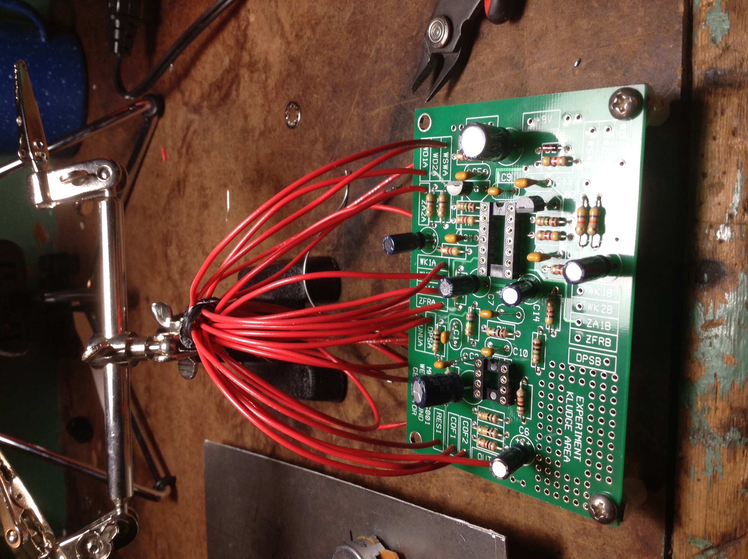

PostPosted: Fri Sep 12, 2014 8:03 pm    Post subject: Reply with quote  Mark this post and the followings unread
Here's the front and back of the final design. I did have to redesign because of the PCB (thanks for the heads up!). Ran out of wire because half the pots are so far away. Always something.
Finally back to work on WSG. I've got most of the wires in. Ended up running out of wire with 4to go.
