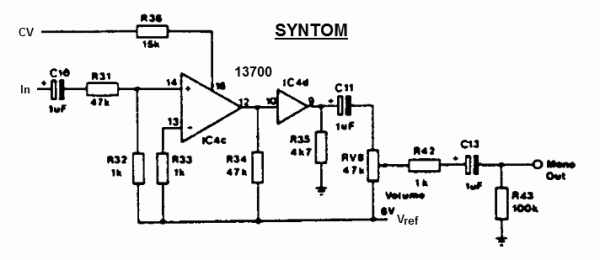

I've got my eye on this guitar compressor schematic at the moment. I think using the OTA as a voltage controlled resistor in an op-amp feedback loop would hopefully work well.

I failed to mention that omitting the 2nd diode from the 2-diode VCA the circuit handles analog as well digital inputs. Replacing the transistor in the "1-transistor" VCA with a single supply opamp makes it even better, as it allows bigger input swings.
I agree with LFLab that looks like too many parts for a single-supply VCA, unless you have your heart set on the compression capability.

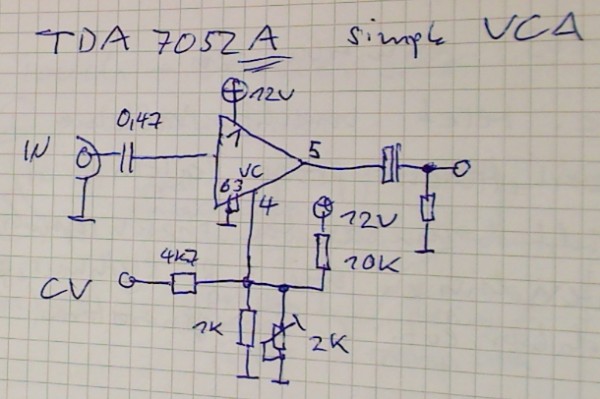

I find the tda 7052 vca interesting! ...never heard of this chip.

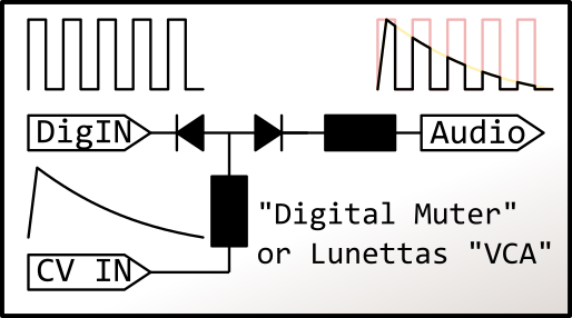

PostPosted: Mon Apr 20, 2015 3:18 am    Post subject: Reply with quote  Mark this post and the followings unread
the trick here is you dont use the positive pulse of the Squarewave. what you hear is the CV that is muted by Squarewave (when the output is low == gnd).
you see evry time the Squre is going low it mutes the CV at the output. so its a "digitalmuter"... Wink
so if you feed a audiosignal to the cvin it is just hacked by the Squarewave - (feed a padsound in and a rythmical square you got your "lofi trance gate sound")

PostPosted: Mon Apr 20, 2015 5:28 am    Post subject: Reply with quote  Mark this post and the followings unread
perfect! now i'm a bit more confused
i thought the pcb made by hexagon5un were refering to this schematics
posted by synaesthesia on december 5 2014.
so to be precise, would be a GATE and not CV INPUT

another question is: does it work only with square waves or i can feed also sines for example?
iam not shure wich pcbs you have and what kind of vca is on them. but the simple diode vca works only with squarewaves whre the low lvl is = gnd.
