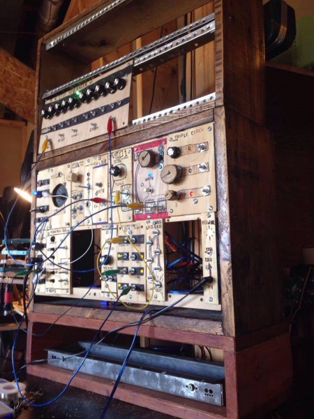

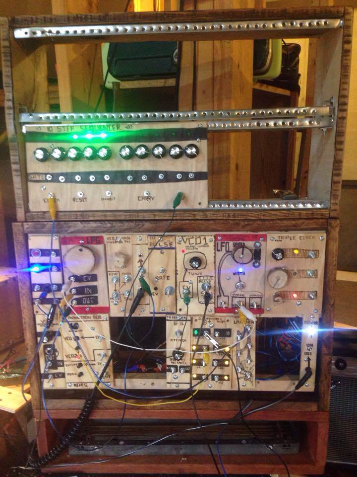

Wow, so much great stuff here. I'm so glad I stumbled upon electro-music in my quest to build stuff that makes noises!
I'm a total newbie to all this, but thanks to these forums and other internet sources I've managed to build a sort of modular. The stuff you all share has been invaluable for helping me make sense of those crazy schematics and stuff.
Some of the modules are totally passive (like the vactrol low pass gate), all are very simple (basic 40106, 555, and op amp-based oscillators). Next step is to build a dual supply so I can finally build a resonant low pass filter (in my mind, that's what I'm missing). Case and panels built with my very minimal woodworking skills and pallets; many components liberated from other items, thrift store toys, even parts of a TV I found in the woods. Patches made with alligator clips, screws, and nuts. Powered off a 5V wall wart. Most of the circuits come from various folks on these forums like synthmonger, Thomas Henry, et al.
Not pictured: I'm using a Raspberry Pi running wiringPi and Mido to listen for MIDI input and scale the 1-127 to 1-100 PWM on the GPIO pins (using a python script). Then I take that through a simple 1-pole low pass filter to get a fairly smooth voltage, which in turn modulates stuff, plays oscillators, etc.
Not the fanciest but it sure does make some noise!
Here's a video of some sounds from a few weeks ago (more modules since then): https://www.youtube.com/watch?v=AR4bPaf7Dwo
Here are some pics:

I always like personalized DIY panels so I really like how that synth looks. And nice to see you're reusing some old stuff.
For a filter you could use the one from Eric Archer which works on a single supply, and sounds quite good. However the
pdf is no longer available, but I have it so just send me a pm if you're interested.
it's been moved and now here
Of course you do want a dual supply anyway. It will make some things easier, and give you more circuits to choose from Wink

Whoa, awesome! Hadn't seen that one yet. To be honest that schematic is pretty intimidating to me– before I tackle something like that I guess I better get a bigger breadboard (mine is the size of an altoids tin). I'm sure it's simple to most folks on here, but I'm just getting started... Gotta work up to using more than 10 components in one circuit!
Probably off topic, but in that schematic what is the "0V"? I get "+9V" and "GND," but not sure "0V."
I've breadboarded various active filters with a LM324 and never have I even been able to get a sound. Probably wiring something wrong every time. Ima keep at it!
Glad you like the panels! Your stuff is very inspirational!

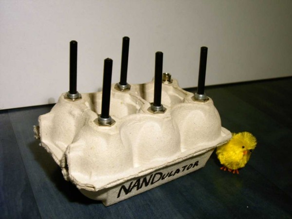

OT: the most recent thing I put together is the NANDulator (special easter edition). more info here

Boah! This NANDulator thing is awesome! (i mean not just the enclosure…) Great sound possibilities despite the simple design. And i suspect further developments.
Anyway. i'm an instant fan and i think we have here the subject for our next DIY electronic workshop! (i guess it'd be ok?)

of course, feel free to use it in any way you want to, that's why I share the circuits.

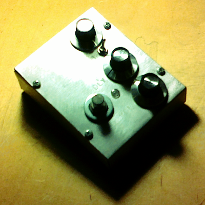

NANDulator!
ghettobling!
