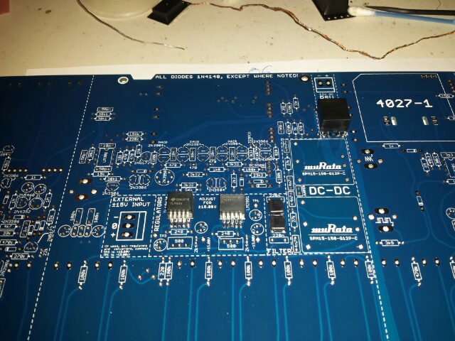

due to Muffs Database Issues, here is the new Build thread rev.2
(backup here: http://electro-music.com/forum/post-407150.html#407150 and on my website)
General TTSH postings like Availability and more here:
http://www.muffwiggler.com/forum/topic-82997.html
TTSH Ver.2 (7.1 on pcb)
Released: 5.January 2015
Release Info:
Changes between first Version and rev.2:
- Powersection, two 1 inch voltage converter, embedded powerregulator like nordcores v1 addon pcb, 3x SMD inductors/chokes and more
- Amplifier : new design without cooling, other Amplifier Transistors and some other parts in this section
- LED Driver redesign
- multiples on pcb
- speaker holes
- switches: you get with the pcb kit few small pcbs with - this are used like a washer for the switches, in result switch mounting is easier as in TTSH rev.1 (pics on my website)
- some minor fixes
______________________________________

known Issues and more:
1.
You dont need TTSHv1. Bugfixes in rev.2 to get a working TTSH
all known Issues are fixed in rev.2, except the Noise gain/distorted - for my usage its the default good ( https://www.dsl-man.de/display/DSO/TTSH+known+issues#TTSHknownissues-3fix )
2.
Measurement of DC Regulator output:
use for measurement the TP 15V to ground and TP -15V to ground (not TP1 or TP3 )
THATS very important to measure -15/+15V
otherwise you risk expensive damages or blown caps. (safe your eyes)

PostPosted: Mon Jan 19, 2015 3:02 pm    Post subject: Reply with quote  Mark this post and the followings unread
I got few kits today.
Jon sells the kits in February too.
he check every panel by hand before shipping.
