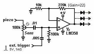

Can't help with your pad problem, but the MPS (and Bass++ and UD-1) won't respond to velocity because the trigger input opamp is configured as a comparator: Its output is off/on. You'd need to rewire it as an amplifier. Copy the DS-7 structure or try the one I've been using. Although both are single-supply, thanks to the diode(s) on the output they'd work with a TLO74 or other opamp powered dual-supply. You might have to tinker with the R & C values.
To get the MPS "Locked" feature, switch the opamp (+) input to a positive voltage.

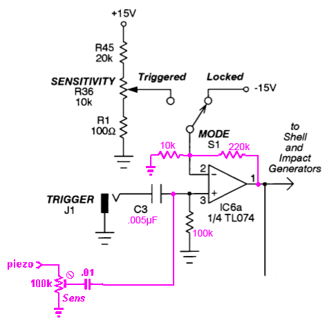

So this modification would mean a separate input for the piezo/pad?
Ive attempted to implement your design onto the MPS schematic below (pink colour), I'm quite a novice in this regard but trying to learn as I go. Would this work or will the Lock/Triggered switch need to be different?

Hmmm...in my circuit the Sensitivity control is only for the piezo. The opamp has enough gain that even a 1V external trigger amplitude produces a full +V at the opamp output.
I think a resistor of some value is needed on the -15V "Locked" terminal of S1. You can just leave the other terminal unconnected.
