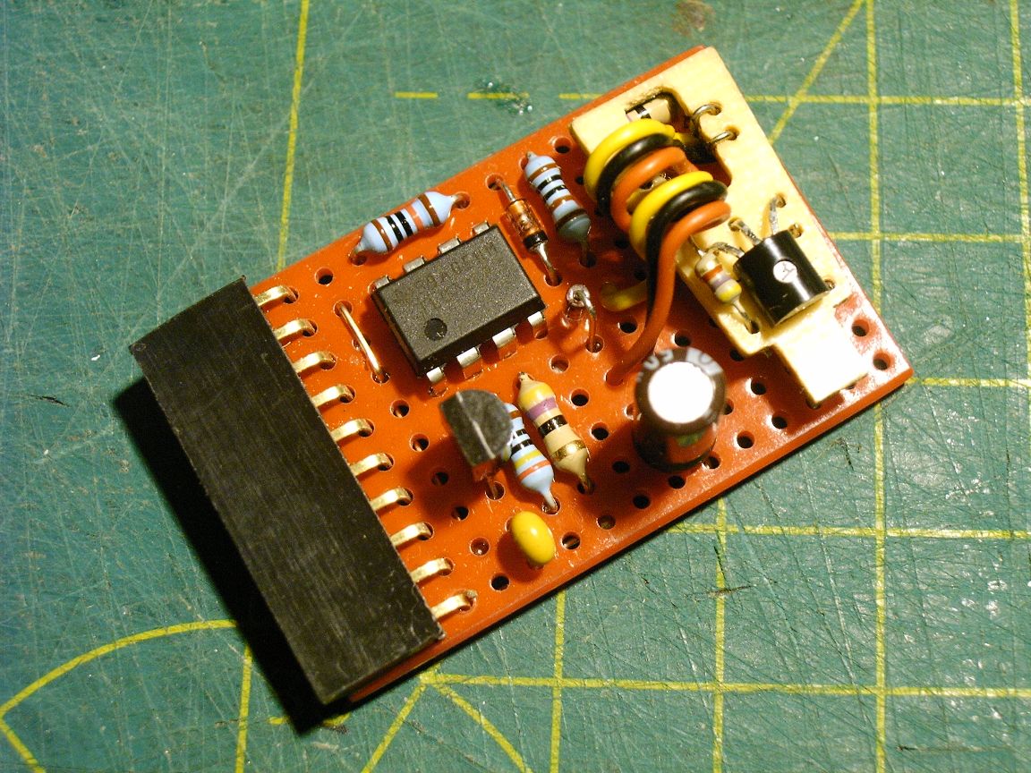

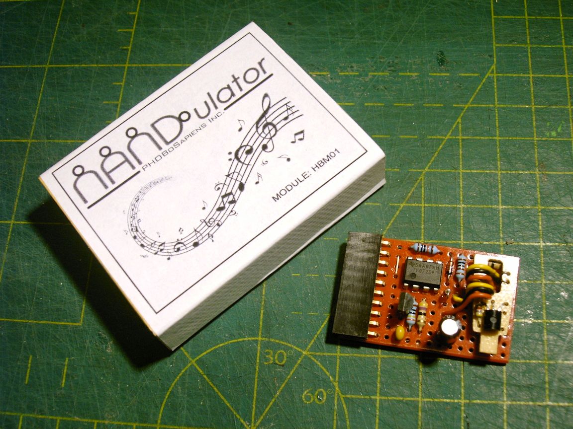

PostPosted: Fri Feb 03, 2017 5:07 pm    Post subject: NANDulator HBM01 module Reply with quote  Mark this post and the followings unread
To celebrate robsol' s recent birthday I made him a little module that plugs onto the NANDulator and plays happy birthday through it.
It gets its power from the NANDulator and the happy birthday melody signal is connected to one of the inputs of Oscillator B so it
modulates the other oscillator build around the same NAND gate. Here's a video he made with it Razz
The circuit itself is actually pretty simple. The melody chip I used comes from a small candle that plays happy birthday when you light it.
It had two small metalized strips attached to it with some insulation between them and they melt together when the candle is lit.
I removed the strips and just bridged the 2 contacts together with a bit of solder which causes it to play continuously. It works on 1.5V
although it might be able to use a higher voltage, but I didn't test that. So the first part of the circuit is a LM317L voltage regulator to
create a 1.5V supply derived from the power of the NANDulator.
The output of the melody chip is a PWM squarewave but because it is powered by such a low voltage the signal is too low to
trigger the NAND gate. To fix this I used a comparator made with an opamp which also cleaned up the squarewave a bit.
Normally I'd use a voltage divider made with 2 resistors to set the reference voltage but because the NANDulator can take
a supply voltage from 9-12V it would also change this voltage. So instead I made use of the voltage drop over a diode to
create the reference voltage. 1 diode didn't work but 2 in series was just right. I used a dual opamp because of the pin layout
and wired the unused one as a voltage follower attached to whatever was most convenient which turned out to be pin 6.
here's the schematic and some photos of the module + packaging:

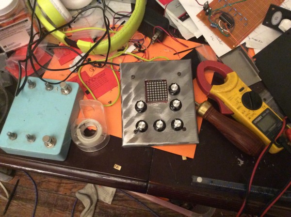

I decided to try putting mine in a case. No where near done, but this is the idea.
The main in out pin header will be accessible from the side.
I missed the LED matrix cut out by a little, but this will make a great pattern to get it right in a final build.
Or I may just take it back out all together. Not sure yet.
 Filesize:  1.02 MB
 Viewed:  747 Time(s)
Posts: 5868
PostPosted: Sun Feb 05, 2017 5:05 am    Post subject: Reply with quote  Mark this post and the followings unread
Good to hear you are having fun with it Very Happy
Did you remove the power connetor to make it fit ? I know that when I tried to design a plexiglass cover for it that was in the way.
The slide switch might also be a little bit high but you could easily replace it with a toggle or just leave it out althogether. To clean
up the cutout it would probably look really nice if you put some red transparent plastic on the inside, lighting gel would be ideal for this.

PostPosted: Sun Feb 05, 2017 6:22 am    Post subject: Reply with quote  Mark this post and the followings unread
I was not sure this was what I wanted, so I shaved the power connector down with a razor knife, same thing with the switch, scored it carefully with a razor knife, then cut it shorter with side cuts.
That made it fit without any major modification, just in case I decided I didn't like the idea.
