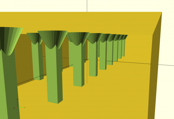

This morning I was imagining what I could do chip-wise for my electro-music friends and I came up with an interesting idea - wireLes breadboards! These are breadboards 3D printed with no wires. So how do they work?
The holes that the chip's legs go into are intentionally designed to have enough room for a chip lead AND a wire! this is very low cost because it eliminates connecting mechanisms altogether. It is also solderable if you are careful enough not to melt the plastic (or even if you do a little bit).
Aha! you say - but what about multiple wires on a single pin? I'm thinking of a post or additional hole system for that, give me a little time, I just thunk this up a minute ago! In the mean time check out the images and let me know what you think!
Les

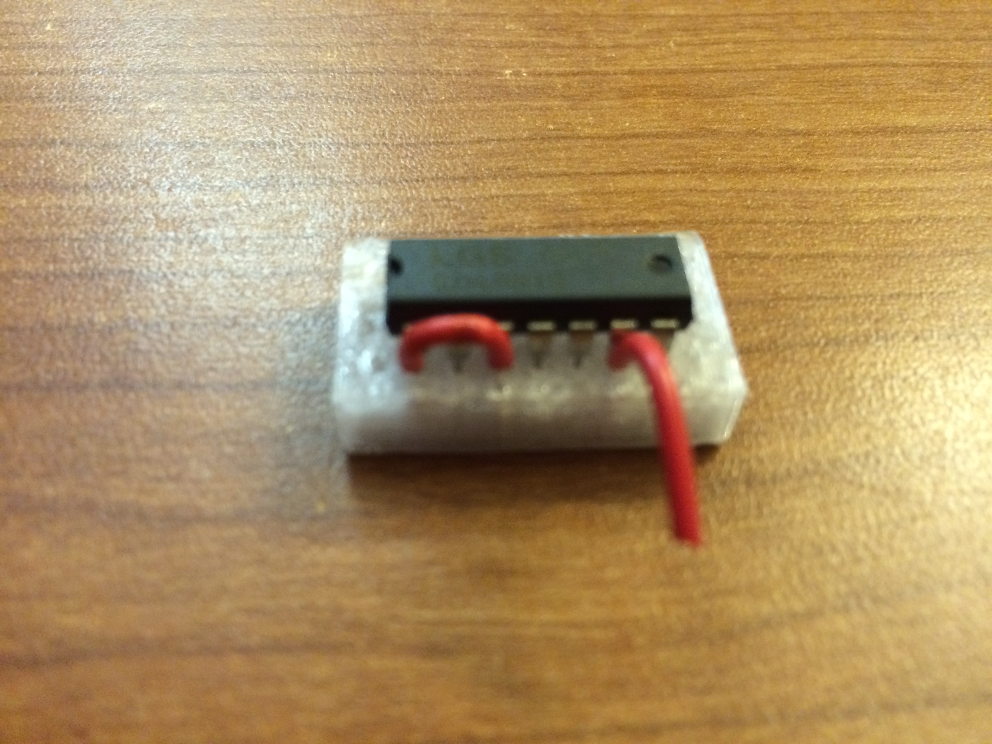

Here is an example chip with two wires inserted - nice!
Les
