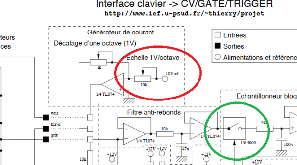

hello chaps,
the following CV GATE TRIGGER controller circuit still puzzles me as to how to get that -10 V voltage that the section i highligted in red calls for.
The whole thing works with a 12 V split supply, so my question is how and where do i get those negativ 10 V required by the current generator?
despite it being french language should be easy to grasp anyway.
thanks ! Smile Smile

PostPosted: Mon Oct 03, 2016 10:29 am    Post subject: Reply with quote  Mark this post and the followings unread
Hi alanwilder81
I can't see the pic well enough to see -10v anywhere in the red circle. I am using an iPad' so that does not help.

PostPosted: Mon Oct 03, 2016 10:46 am    Post subject: Reply with quote  Mark this post and the followings unread
Your could use a 79L10 voltage regulator supplied from the -12V (with the capacitors and possibly diodes around as suggested in the data sheet for it).
Or even connect it to the -12V rail, but the 10V really is to isolate stuff a bit from the supply voltage in order to make the circuit more stable (less drift, less false triggers).

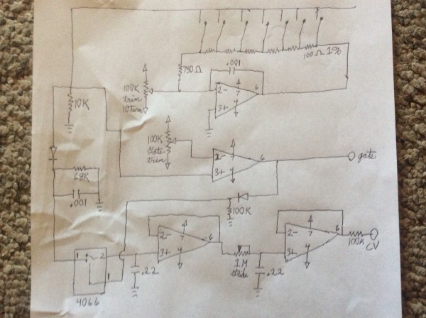

PostPosted: Mon Oct 03, 2016 10:52 am    Post subject: Reply with quote  Mark this post and the followings unread
This is what I was trying to add to the first schematic on this thread.
However I ran into the problem that because I used a comparator for the gate signal, it always samples 0v for the sample.
Working on using a simple transistor gate signal to remedy that.

PostPosted: Mon Oct 03, 2016 12:16 pm    Post subject: Reply with quote  Mark this post and the followings unread
thanks mates,
i posted a zoomed detail of the circuit, hoping it makes more sense to you all Very Happy Very Happy
to Blue hell,yes i wasnt sure wether or not use a voltage regulator to rise the voltage from -12 to -10,on the section circled in red. Your advice confirmes my assumptions were right. Is it not gonna make too much heat ? Dumb question i know Cool
To Cfish,i'd like to get to the bottom of the 4066 thing, green circle.
You run into some problems with it, right? What exacly happened?
According to Yves Usson, the keyb circuit i posted has no flaws whatsoever and has been fully tested.
I am just curious to learn more about it before i even venture into building it Smile

PostPosted: Mon Oct 03, 2016 12:38 pm    Post subject: Reply with quote  Mark this post and the followings unread
Only when by accident you did something wrong .. there is almost no current flowing trough it, so it should not get warm at all.

PostPosted: Mon Oct 03, 2016 12:43 pm    Post subject: Reply with quote  Mark this post and the followings unread
Alanwilder81
My only problem, only arose because I chose to use a comparator to get a gate signal.
I didn't think about sample and hold at that moment.
The problem I have, is in my own planing and design. An uneducated mans mistake. However I am learning just like anyone who isn't dead.
I just try really hard to point out things fast because I don't want someone to get discouraged on my account.
The first schematic on this page works great for what I needed it for at the time. I'm still trying to make it something better, and better.
I really like this thread because almost everyone here has at one point in life wanted something better than the cigar box organ schematics. But not quite been to building a MIDI to CV converter.
By the way. I have built a wonderful aurdino based MIDI to CV converter. Loosely using a Ray Willson design. I really don't need more full analog key beds. This type of circuit just intrigues me. There is a lot going on in it.

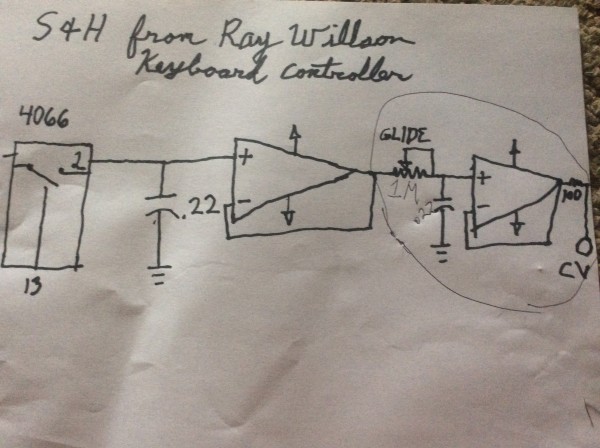

4066 is just a fast switch. The capicitor after it holds the sample voltage for the opamp.
This lets you pick up the key and the note stay the same.
If this does not happen, when you pick up the key and the envelope generator keeps the gate open on decay, the note would change
alanwilder81
Joined: Sep 03, 2016
Posts: 310
Location: italy
PostPosted: Mon Oct 03, 2016 1:33 pm    Post subject: Reply with quote  Mark this post and the followings unread
hey cfish,
i've recently built your CV GATE circuit, and what you described ,is exactly what happened to me. Due to the lack of the sample and hold.
As soon as i released the note, the circuit would stop sending voltage to my VCO, and consequently the note would changhe in pitch Sad Smile Sad Smile Sad Smile
With ADSR zero release time setting, that wasn't noticeable,but of course it was on medium or long release settings.
So, the sample and hold just keeps the output voltage even, until next event.Simple yet astonishingly useful Cool Cool Cool

PostPosted: Mon Oct 03, 2016 1:41 pm    Post subject: Reply with quote  Mark this post and the followings unread
Alanwilder81
The pic I posted above is the sample and hold I am installing.
Look at your schematic you are now using and compare everything after the 4066.
After the 4066 is sample and hold. Mine has glide. Didn't look to see if yours does.
But glide just charges a capicitor to slow the change between keys.

PostPosted: Mon Oct 03, 2016 1:47 pm    Post subject: Reply with quote  Mark this post and the followings unread
If you add the part I circled at the CV out of the schematic you have. It will add glide to it

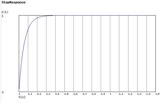

Posts: 1320
PostPosted: Tue Oct 04, 2016 12:19 am    Post subject: Reply with quote  Mark this post and the followings unread
Hi Cfish,
What type of opamp do you use on the S/H?
If you use something like the TL07xx that's fine, because they are FET input opamps (>> very high input impedance).
But if you use the 741 type of opamp, this might pose a problem since (depending of the version of the opamp) this could have a minimum input impedance of 300kohm.
Combined with the 200nF capacitor this could result in a step response of about 0.3 sec.

PostPosted: Thu Oct 06, 2016 12:45 pm    Post subject: Reply with quote  Mark this post and the followings unread
Thanks grumble
I am using TL071 there. I built a quick rig to test the sample and hold and it works good. Took me borrowing my brouther much better scope to be sure, but it is just sampling 0v as the cv drops before the comparator swings negative.
Thanks for the recommendation, I would never thought of that. Was just luck I was using TL071
