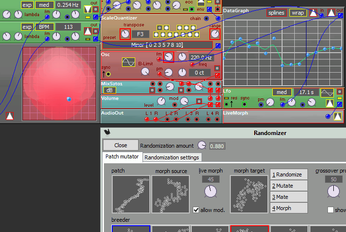

PostPosted: Fri Jul 22, 2016 5:42 pm    Post subject: Reply with quote  Mark this post and the followings unread
Ok, it basically all works .. ended up with:
Where excluded stuff is marked in red in the patch - click on the image to see a larger version.
Some details to fix still, like I would like to be able to set the amount of random to be applied maybe.

Well ... this is it for now :
Posts: 24493
PostPosted: Sat Jul 23, 2016 7:06 am    Post subject: Reply with quote  Mark this post and the followings unread
To clarify a bit ...
The randomizer window holds the defaults for any new modules added to the patch, and it can change the random settings in a patch for categories.
The Module categories only act to control the Randomizable module types - these settings are not saved, and they should probably be buttons instead if checkmarks (except that there is a somewhat nice standard component in Delphi to automagically build a set of checkboxes and not one to do the same for buttons - or so it seems).
Apart from that, at design time some controls that can not be randomized will be excluded from randomization.
Apart from all that, it is always possible to override settings on a module by module and on a control by control basis from the patch itself.
When a patch is saved the actually excluded stuff is saved with the patch, and this will be used again when the patch is loaded (regardless of what may be set in the randomizer window at that time).
The randomizer window settings are not saved with the patch, they are saved with other Wren settings in the main Wren ini file.
The Randomization amount is saved with the Wren settings as well, the default value will be 0.5. Lower values make the randomization less jumpy, but it will also cause controls that do not have many positions to not change anymore.

it now looks more like :

The mutator implements a primitive genetics tool. The idea is that the parameters of the patch form a genome. This genome can be altered by the mutator in a sexual and in some asexual ways.
The graphic images are a visual interpretation of the parameters present in the patch. Every parameter is represented by an angle, and then a line is drawn under that angle to the next parameter - which forms the worms. Worms are then scaled to fit the cage they are in.
Asexual reproduction can be plain random .. which does not really reproduce anything (as all information is lost), or a mutation (which does keep some information and looses some as well). Mutations can be controlled with a probability and a range. The probability sets the chance that a a change occurs, and the range determines how much of a change can occur.
Sexual reproduction picks parts of one genome and parts of another and makes a mix of that. The crossover probability determines how often a parameter pick switch is made from the first to the second 'parent'. Also in sexual reproduction there is some mutation involved.
In the randomizer window the parents are in the breeder bit, the leftmost one being one parent and the rightmost one the other.
The mutate button just mutates the existing worms between the left and the right parent. The randomize button sets random genomes for the same six and the mate button performs the sexual thing with both parents leading to a a sixling .. erm .. if that is a word.
And then you can drag around stuff, like drag a worm onto the patch worm to make the patch have the dropped params. Or drop something on the left morph and something else on the right one, and then you can do a live morph between those.
The scratch area is just that - drag stuff there for later use in one of the active squares.
Clicking on a worm will copy it to the patch, this happens for the morph and scratch things in the same way ... but you can also drag worms to the patch square.
Then when you have a left and a right morph the live morph control can fade between the two. This can also be automated by using a LiveMorph module in the patch, with a checkbox to enable or disable the function.
