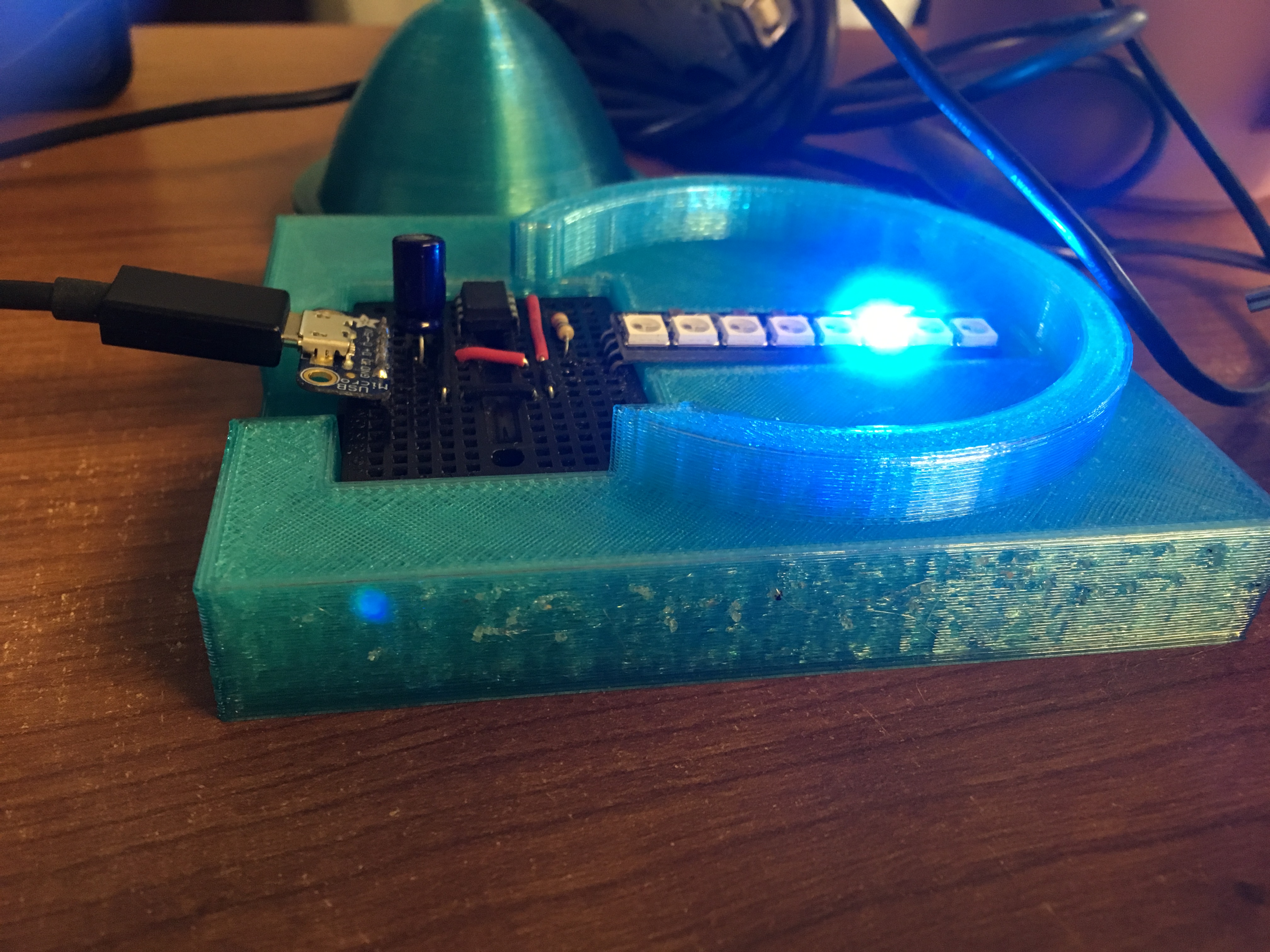

Here are some photos of the test fixture and neutral "control" lens in place.
More details to follow.

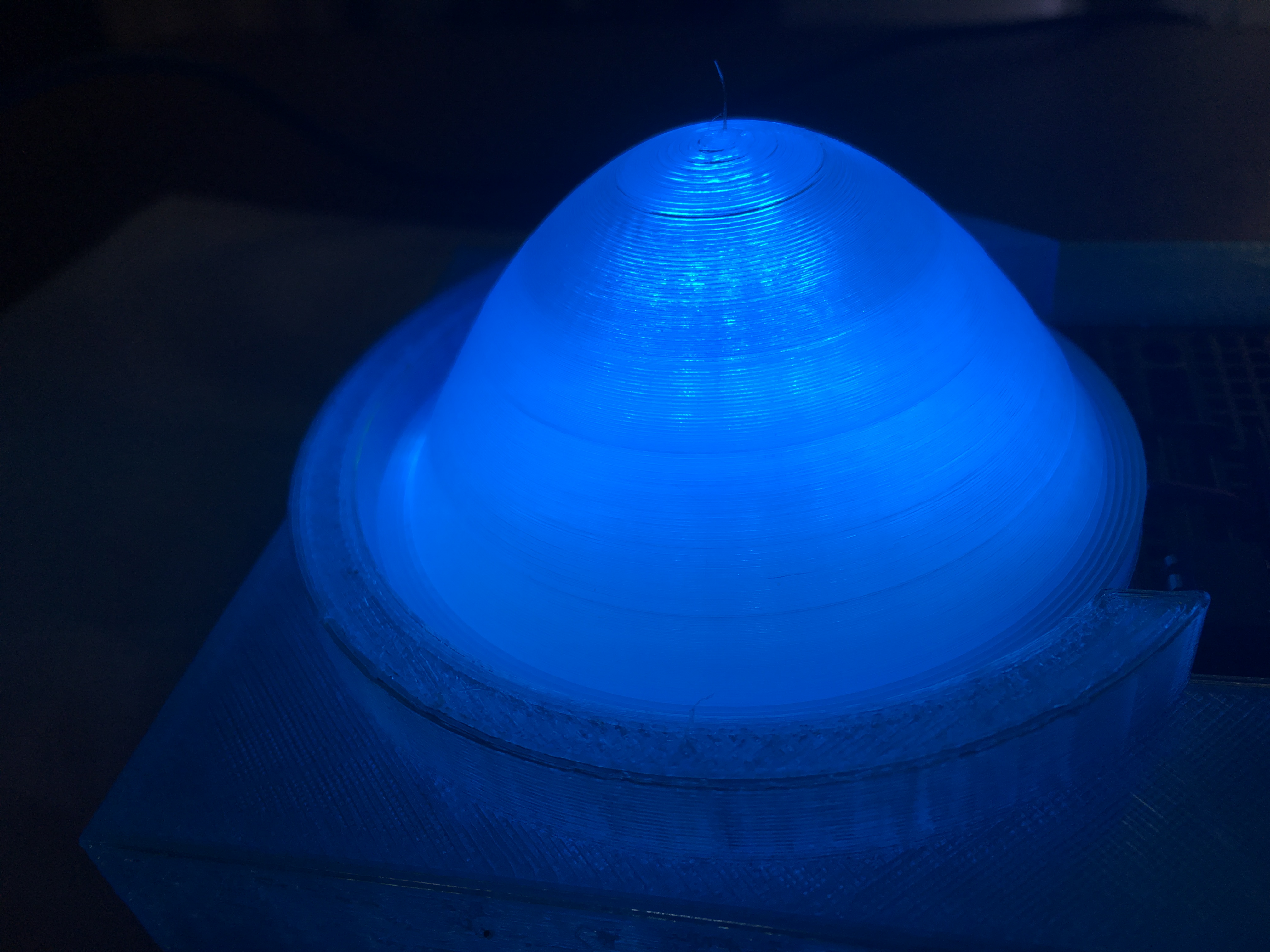

After quite a few failed prints, finally one that looks promising. It is very diffused and yet it does what I want it to do plus the diffusion. That is, if I understand what I want it to do!
Looking at left lens from the side you don't see much light intensity. Looking from the top and angles near the top you see more light. This is an indication that the lens is directing the sideways moving light in a more upward angle than their original travel would lead them. It will take measurements to record that though, as it could just be my wishful thinking.
I need to polish the lens using 400 grit down to 3000 grit to bring on the clarity. That will take a long time so wish me luck!
Les
