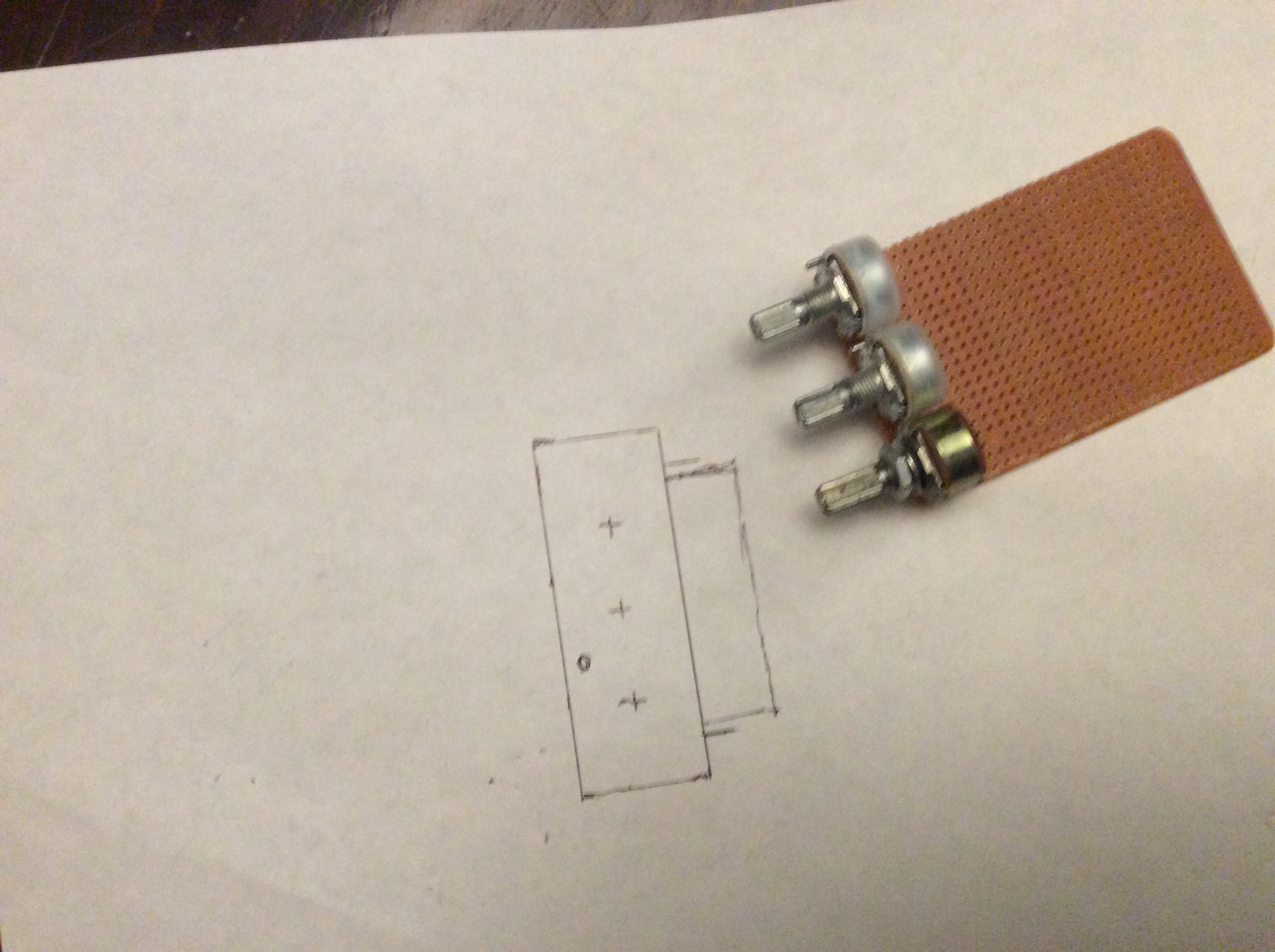

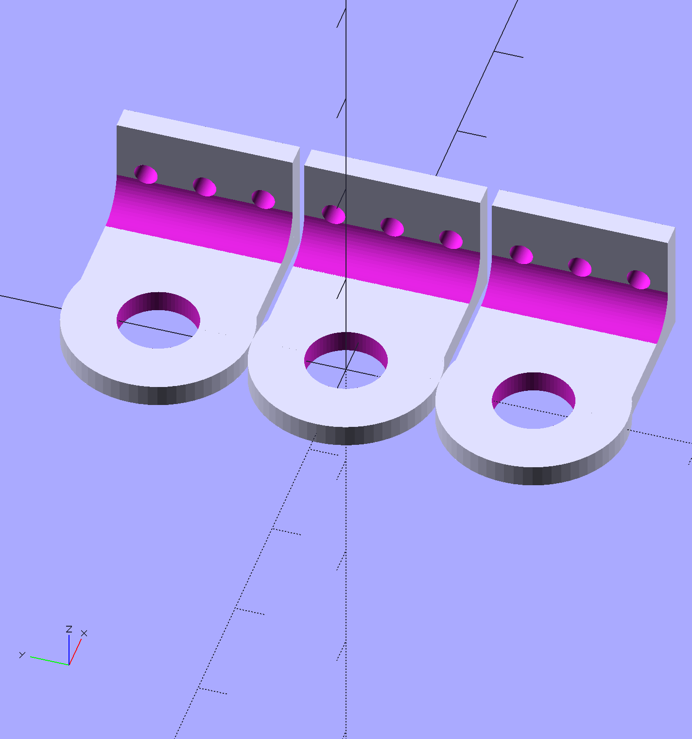

three pots fit with a width of 48mm. the short dimension of the card is 54mm so there is a 3mm space on top and bottom end.
jacks on the back panel?
Les
three pots in a row: 48mm

PostPosted: Sat Dec 24, 2016 12:37 am    Post subject: Reply with quote  Mark this post and the followings unread
Regarding the pots and connectors subject, it seems rather strange to squeeze the entire user interface into the short side of one end of the card. Consider the mini 500 series - I/O on the backplane. I figure we can have a backplane or just a little bit of a backplane to distribute power, then wiring on the back. Leaves room for three items on the front.
Another option is to use the long side for the pots and jacks. Really though, we can make knobs to any size on the 3D printer, the alpha pots are 16mm in diameter each.
I like the creativity of the jack in the hole there, just don't think jacks and pots together really works in a small format. You tell me, we gotta learn how to think things through.
Les
Joined: Oct 13, 2007
Posts: 6221
Audio files: 267
PostPosted: Sat Dec 24, 2016 12:50 am    Post subject: Reply with quote  Mark this post and the followings unread
more facts to consider. when you think about it, designs are full of pots and jacks plus other I/O. the ratio of the space taken up by those items to the space taken up by circuitry is about equal. this means that cramming all the i/o in one little space will lead to inefficient utilization of the available space.
so we have four possible solutions:
    pots on the short side, i/o on the back
    pots on the long side, i/o on the the back
    pots on the short side, i/o on the front
    pots on the long side, i/o on the front
I'm really saying that the third option is the most space-cramped one of all.
you advise please.

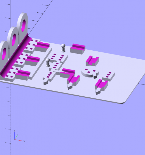

Posts: 6221
Audio files: 267
PostPosted: Sat Dec 24, 2016 1:46 am    Post subject: Reply with quote  Mark this post and the followings unread
my progress, slow with all the alignment and all that schtuff.
Les

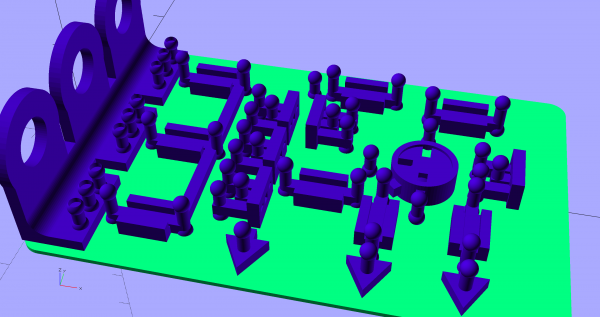

Posts: 6221
Audio files: 267
PostPosted: Sat Dec 24, 2016 4:34 am    Post subject: Reply with quote  Mark this post and the followings unread
been at it for hours and hours, about an 8 hour day's worth of work. getting tired, time for a break!
Les

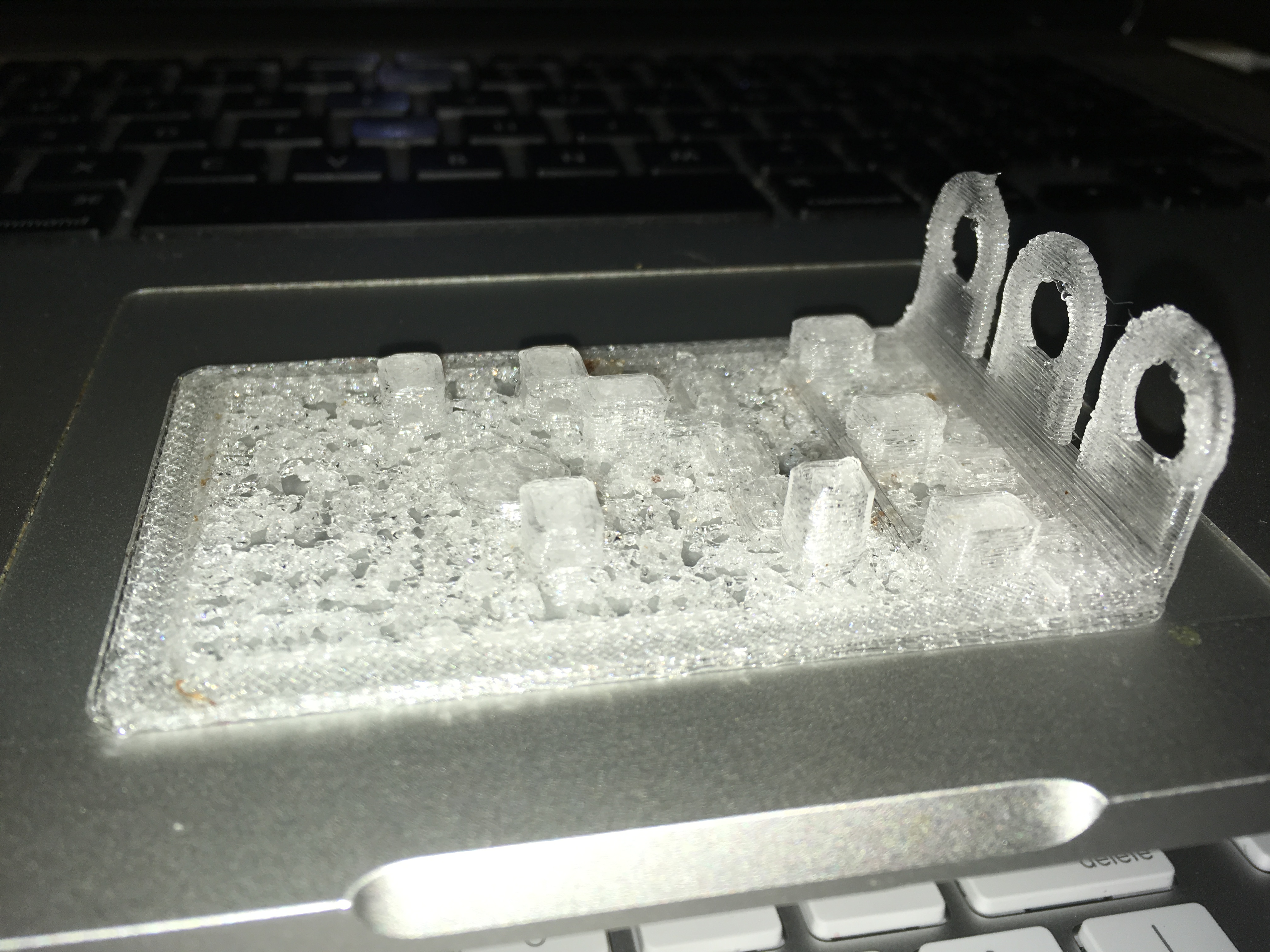

Posts: 6221
Audio files: 267
PostPosted: Sat Dec 24, 2016 8:39 am    Post subject: Reply with quote  Mark this post and the followings unread
you know, CFish, I sai to decrease that resistor by half, then when I thought about it later I wondered if increasing it would help more. Sure enough, your understanding was a practical answer. Shows what I know, lol.
I 3D printed the partially done layout of the twisty leads wire form of the VCO. It's over there all ready for me to get when the next opportunity arises. I'm dealing with pain and healing issues, prevents me from doing much at a time.
Les
Posts: 6221
Audio files: 267
PostPosted: Sun Dec 25, 2016 3:09 am    Post subject: Reply with quote  Mark this post and the followings unread
Here is the form for the credit card synth VCO.
Les

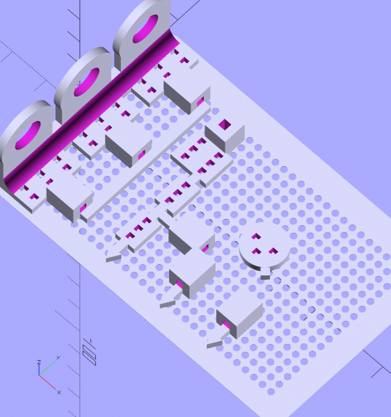

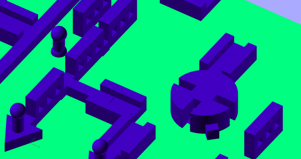

Posts: 6221
Audio files: 267
PostPosted: Mon Dec 26, 2016 1:52 am    Post subject: Reply with quote  Mark this post and the followings unread
Here is a closeup of the VCO fixture. The idea is to wrap wire around the posts in such a way that a drop or two of conductive glue will make a reliable connection. the troughs are for resistors, the brick-things on their side with three holes are transistors or caps, and the can thing is a can transistor. Three pots on left side are not visible in this image.
Les
