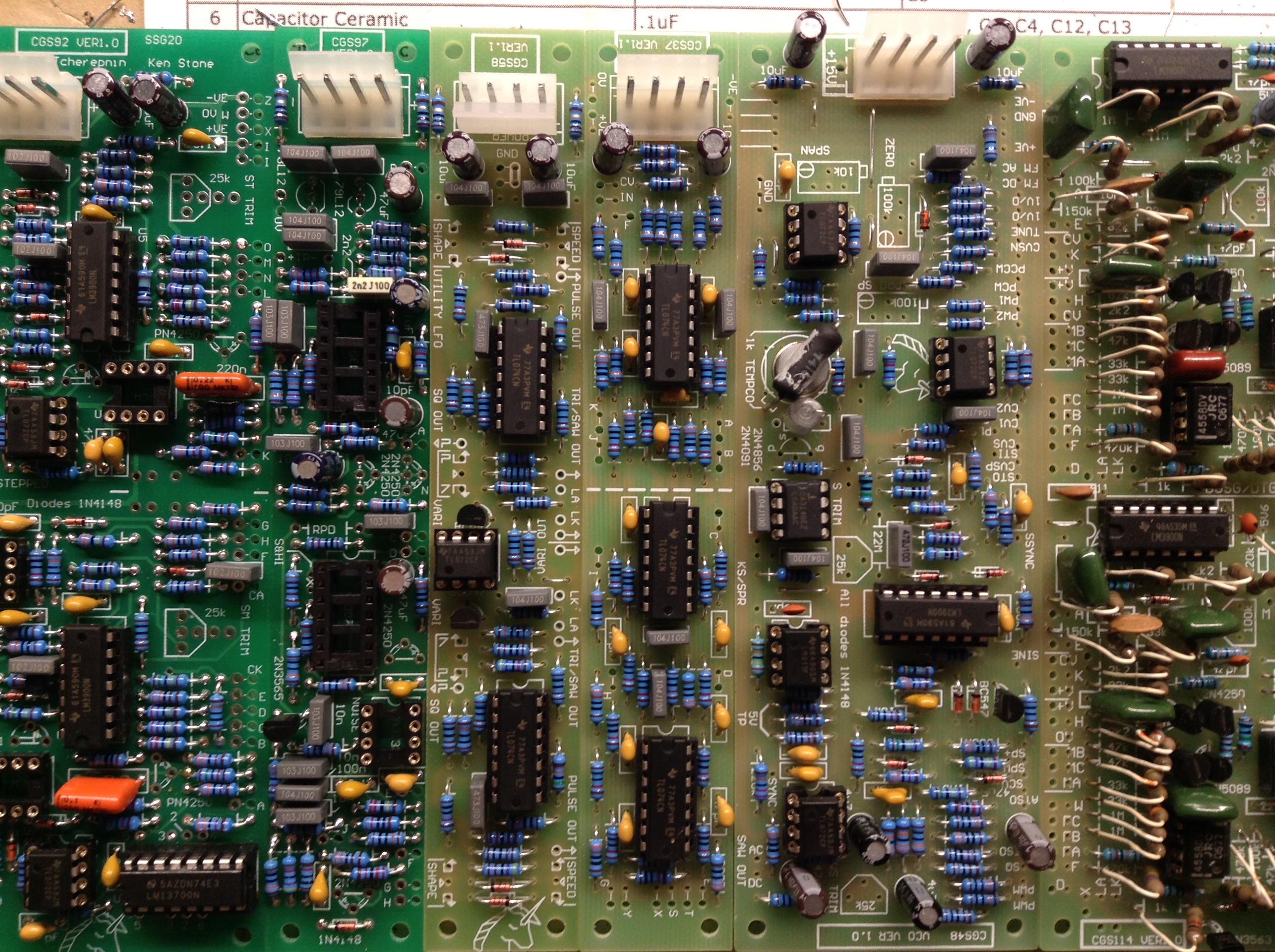

Here's a picture of some of the pcbs that I've populated so far. There are still a few missing parts since not all of my part orders have arrived.

Huba, are those IC sockets dual wipe?
Because they look suspiciously like singlewipe.

I'm not very familiar with dualwipe vs singlewipe. What I can say is that some of the sockets are machined (such as the 8 pin one in the pic) and some of the other ones (such as the all black sockets) were salvaged. Is there a drastic importance between single and dualwipe socket usage?

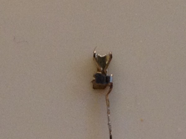

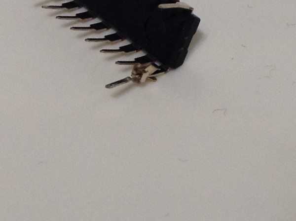

It‘s just how good the contacts are. Dual are better than single and machined are best. I don‘t use salvaged parts. Contacts may be bad.

The problem is not the problem you have now. The problem will appear in a few years.
Dual wipe have double size contact surfaces than single wipe. So you will have less problems with corrosion.

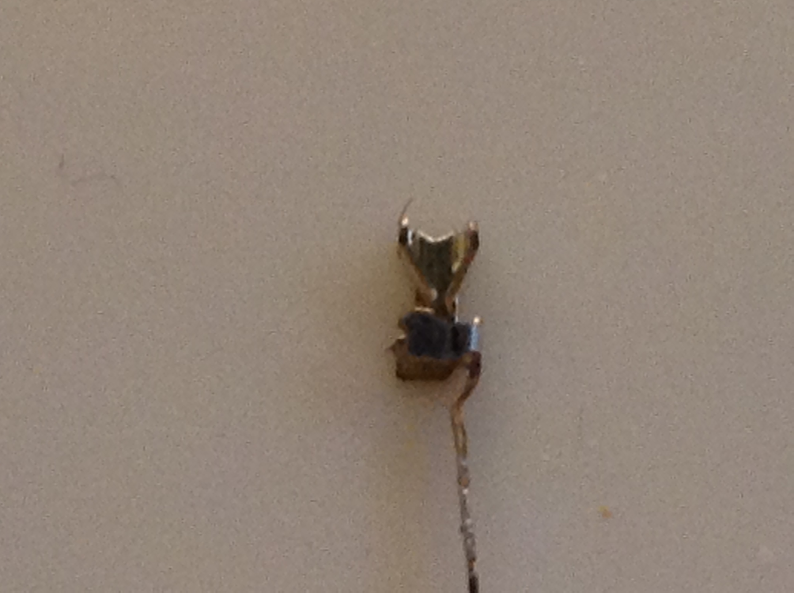

I took out one of the socket legs to have a look at it. It looks to me like it may be dualwipe. Here are some photos:

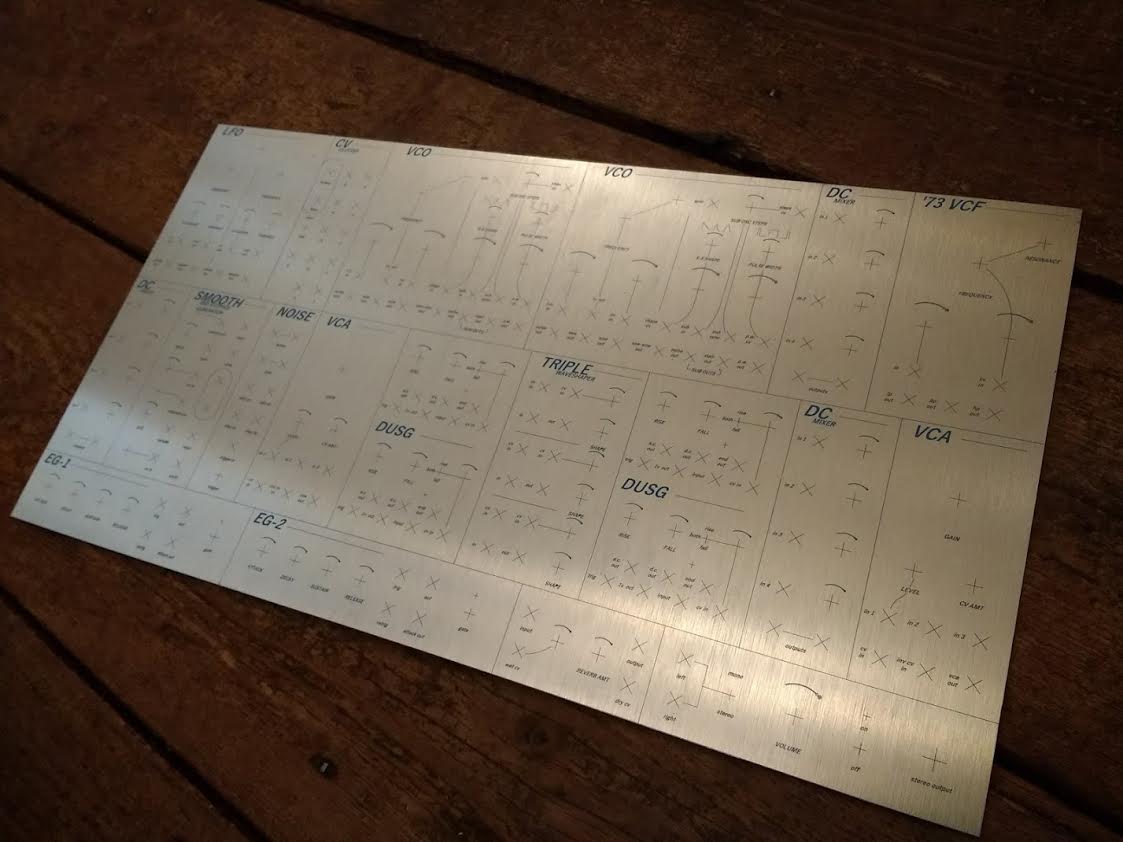

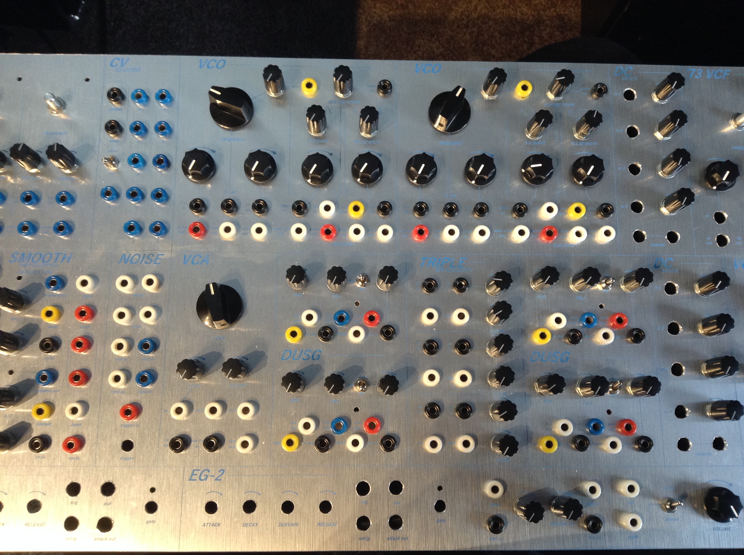

Julian, the guy who I got to make the panel, is just about done making it! Here are some pictures of the panel he sent me. It looks amazing love

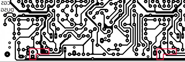

Thanks for uploading these pcbs, I'm planning on having a go at the DUSG.
Just wondering if there's a reason the 100nF is not connected to -V trace on the left hand part of the circuit (from pin 3 of LF353) while it is connected on the other side? This isn't on the CGS schematic but I think it is connected on the Ken Stone pcb?

Just another mistake by me... I'll fix it and update the attachment on that post.

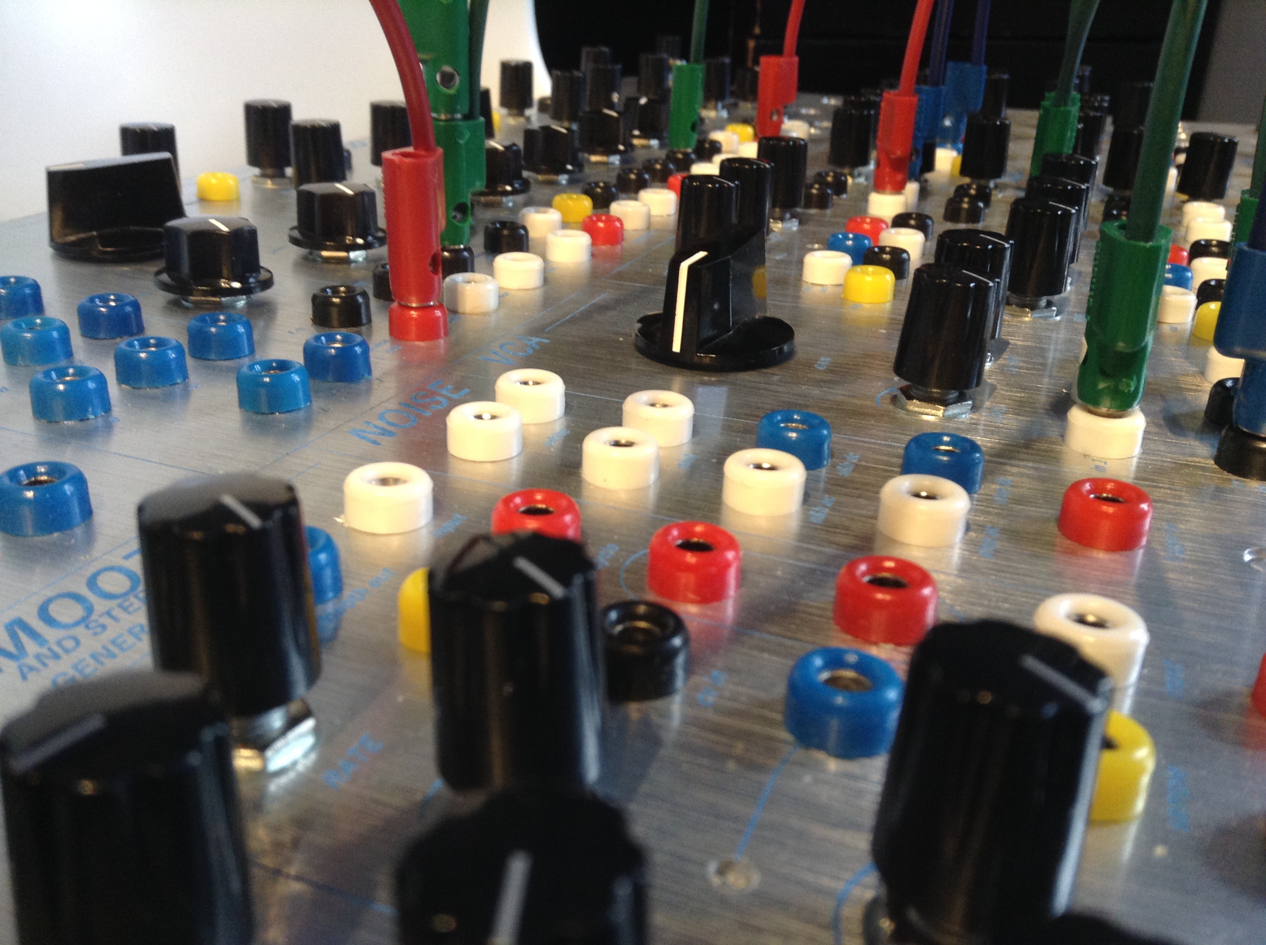

PostPosted: Sat Apr 21, 2018 9:19 am    Post subject: Reply with quote  Mark this post and the followings unread

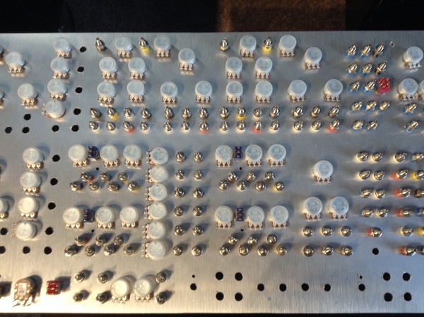

I've started mounting all the pots and jacks on the front panel. I've decided to hold off on buying the buchla style knobs for now simply because they are 4x as expensive as your average knob. So, for now I have some different davies clones and mxr knobs on there, and they actually look pretty nice! They'll definitely do for now.
The only things I've left to do are:
-finish mounting all the front panel components
-put a few last parts on the pcbs.
-build a wood case for it
-install the power supply, and pcbs into the case, and wire everything. This will take a while
Building the wood case will probably end up being the biggest holdup. Although I have access to my Fathers carpentry shop, where he has tools such as planers, table saws, chop saw, etc. Since everything is used more for crude construction rather than fine woodworking, most of it is out of calibration in one way or another. The planer's blades need to be sharpened, The fence on the table saw needs to be fixed, and lots of other little things need to be taken care of before I'm comfortable throwing some nice hardwood through the machines.
Here's some pics:
 Filesize:  1.3 MB
 Viewed:  672 Time(s)
 Filesize:  1.62 MB
 Viewed:  647 Time(s)
 Filesize:  1.58 MB
 Viewed:  673 Time(s)

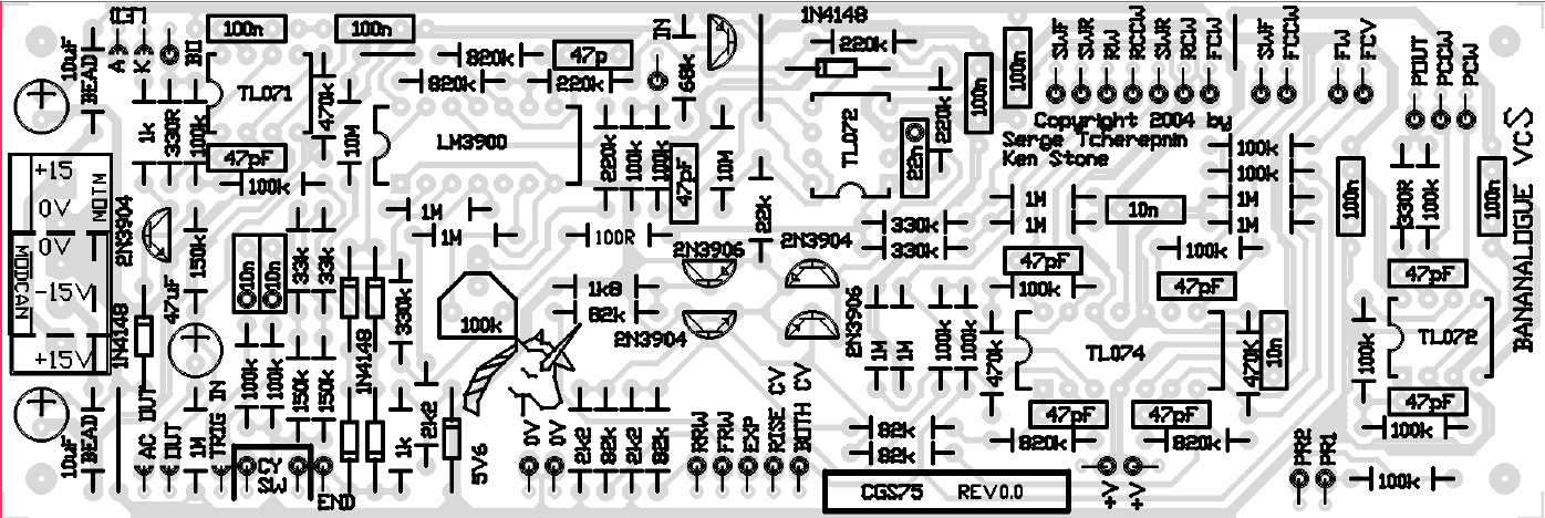

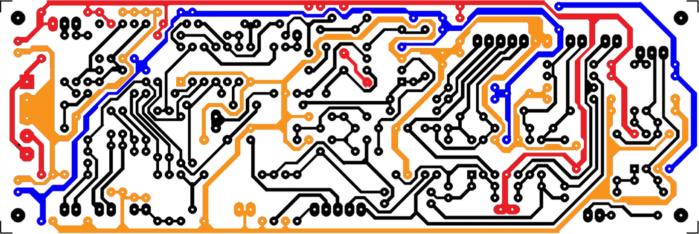

I'm currently running a similar DIY CGS project and having trouble with the CGS75 VCS.
Anybody had any chance with it?
Here is the layout, it's totally possible that i forgot some trace or did some mistake.
I read after some research that it was some problem with the layout of the REV 0 board that was corrected in the production one, but i'm unable to find more precise informations about it.

On the VCS page is mentioned an incorrect resistor value on Rev 0 boards
"On the first run of these PCBs (REV0.0 red boards) the specified 220k resistor connected to the emitters of the four transistors should be 8k2. On the VER1.0 boards, the 22k resistor in this location should be 8k2." Is this possibly the problem that was being referred to?
Are you sure it's a layout fault? There's always the possibility of an etching fault, soldering short, faulty component, etc. It probably would be a good idea to also post a picture of the top/bottom of your board and post it. If I'm able to find a chunk of free time today I'll go over the Rev 0 layout and compare it to the schematic to see if there are any discrepancies.

For sure, mistakes could have been made at different steps, i checked very carefully every solder joint / connections yesterday, without finding anything.
I will switch the resistor as you said, and double check the pinout of the transistors and keep you updated.

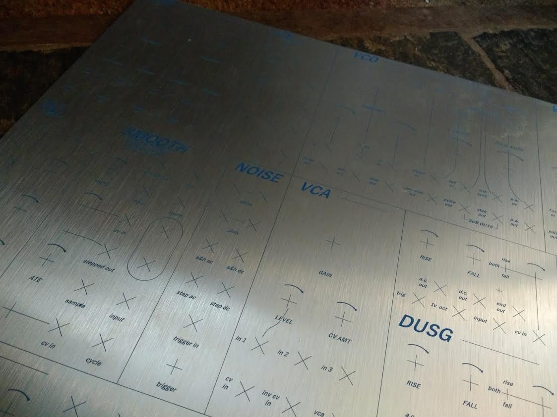

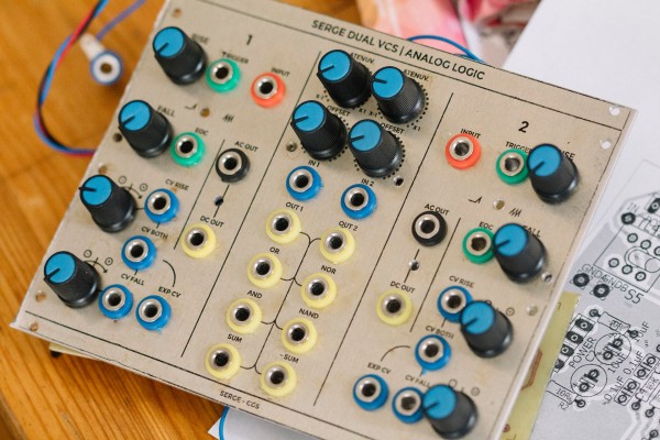

Here is a pic of the panel, it will be mixed with attenuverters (from befaco circuit) and analog logic from CGS to make a kind of math-like module
