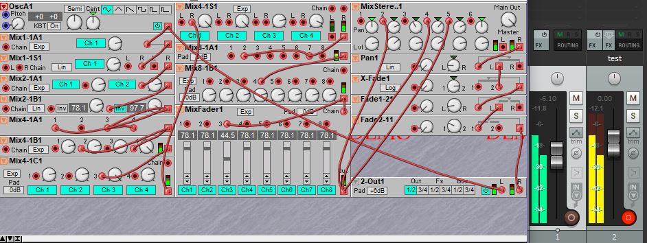

Hi everybody!
I am happy to announce that the MIXER section is completed.
I include a screen of the patch which I used for testing. It includes every module of mixer section. The results (level and phase) are equal comparing to our pch2csd patch. Sure it is quite simple test and probably more complicated things to be done. BUT, at least we have ALL mixers of NM2 completed. Yay!

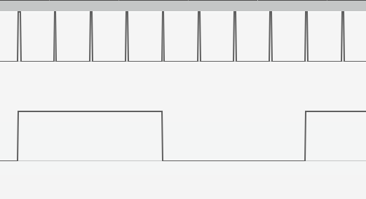

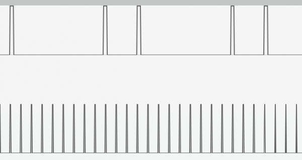

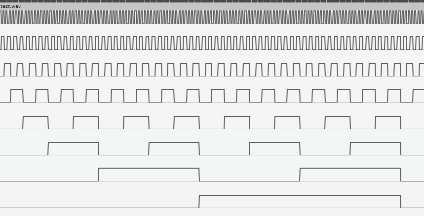

Hi people!
Long time no see! We are back on track again with the ClkGen model (long time tested) and a whole Logic group completed. Not so much about actually sound design, but anyway one step closer to the final emulation.
Stay tuned! more things to come soon!
And as always - any questions are welcome and any help is appreciated.
Gleb and Eugene
Clock divider in the second mode
 Filesize:  3.27 KB
 Viewed:  20431 Time(s)
Flip Flop trigger

Clock Generator (1/96 pulses and swinging 1/16)

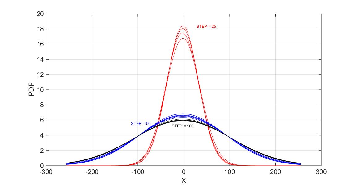

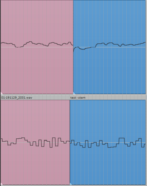

Hi people!
It's been a while. I've been to amazing Csound conference in Italy and was involved into number of activities, as all our little reverse engineering community...
So today I am uploading our first results on emulating NM2 random generators. Sure, we cannot build exactly the same thing, BUT we can estimate Probability Density Function over the series of recorded random values and build the same gen. The PDF graph gives distributions for different STEP values of RandomA/RandomB modules (both original and emulated) and they are rather close. The picture with the time series gives comparison between original random sequences (pink) for EDGE 25 (up) / EDGE 100 (bottom) and emulated (blue) correspondingly.
Stay tuned!
G
PDFs

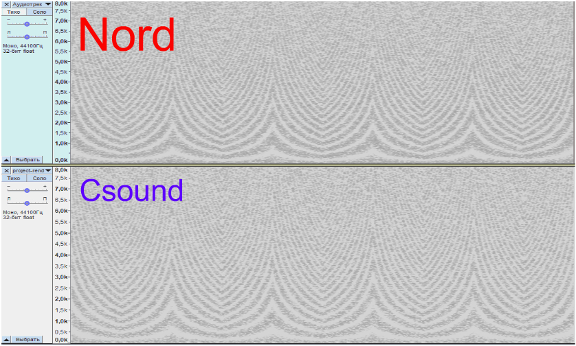

Hi folks!
I hope everybody of you and your family are safe and OK.
I sit at home and continue to develop the project.
Thanks to my student I've finished a Flanger model, which is actually pretty trivial, i.e. just a classical flanger with triangle lfo and one feedbacked delay tap. The code is in the repository.
Until next time,
Gleb
Flanger comparison

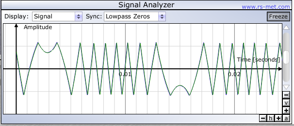

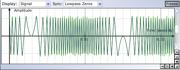

Hi everybody who follows this topic!
Today I've finished reversing WaveWrap. At the beginning it didn't seem too hard since Csound mirror opcode does exactly the same right out of box, BUT Nord also does some kind of amplitude compensating. So last two days I've been measuring all point values (from 0 to 127). The FX level curve seems familiar, but for that opcode we need a high precision, so I decided to have just 128 points instead of any approximation. Some results are given as well as the code in the repository. Have a nice time and stay safe from virus!
The point #127 of WaveWrap scale
 Filesize:  111.01 KB
 Viewed:  14493 Time(s)
Somewhere in the middle of the Wrap scale
