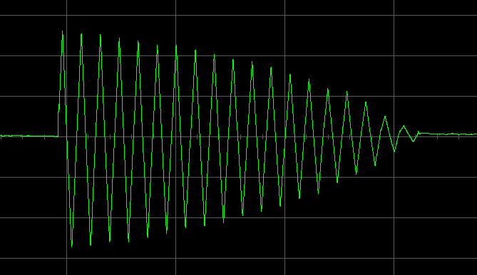

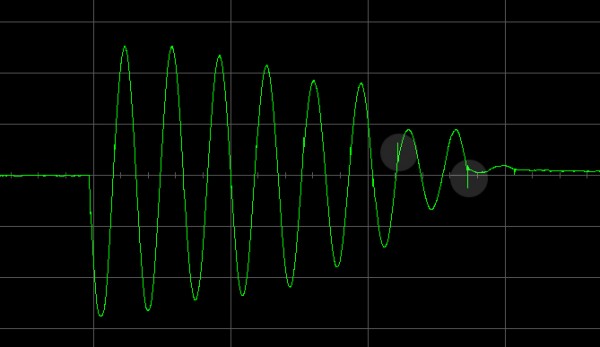

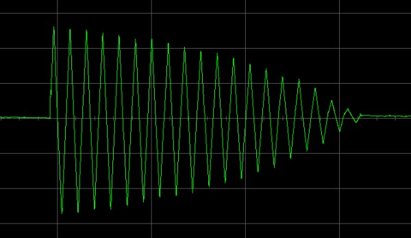

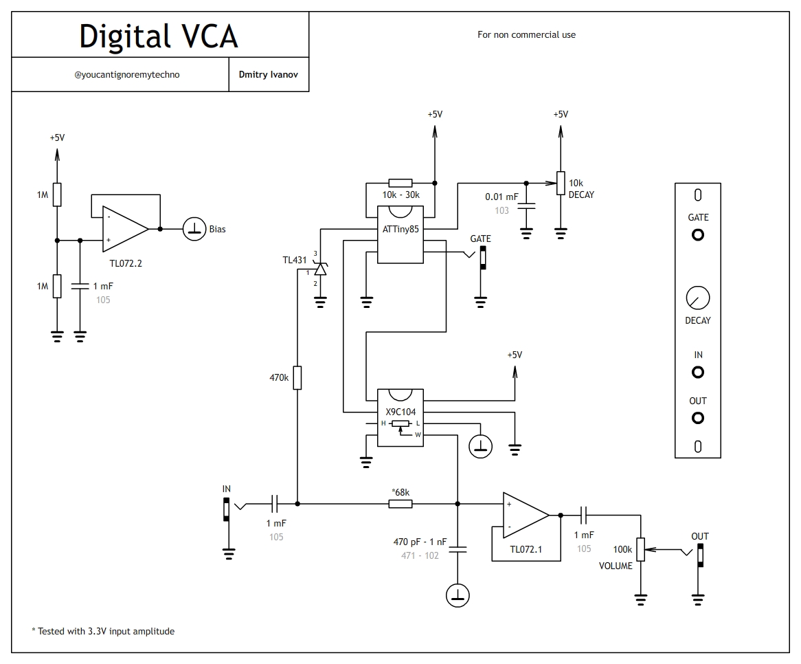

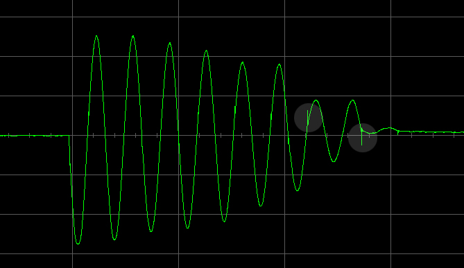

But I've made some 5V digital VCA.
TL431 used as 2,5V comparator. In this curcuit envelope is exponentional. But if you will make inverting amp with digital pot. in feedback loop, envelope will be linear.
If you will use CD4069 as inverting amp with digital pot. in feedback loop, envelope will be also linear, but shape of signal may be distorted. For example, triangle wave will look like lines bended into arches.
Pot. can switch in non zero crossing point, and I don't know why, maybe because of TL431 is not the best decision. Maybe it's breadboard feature.
That's why I used the 470 pF capacitor. It removes the peaks from switching. Two oscillograms, with and without capacitor. Code also included.
5V digital VCA
 Filesize:  169.33 KB
 Viewed:  633 Time(s)
Without cap.
 Filesize:  76.2 KB
 Viewed:  579 Time(s)
With cap.
 Filesize:  99.23 KB
 Viewed:  564 Time(s)
Digital_VCA.zip

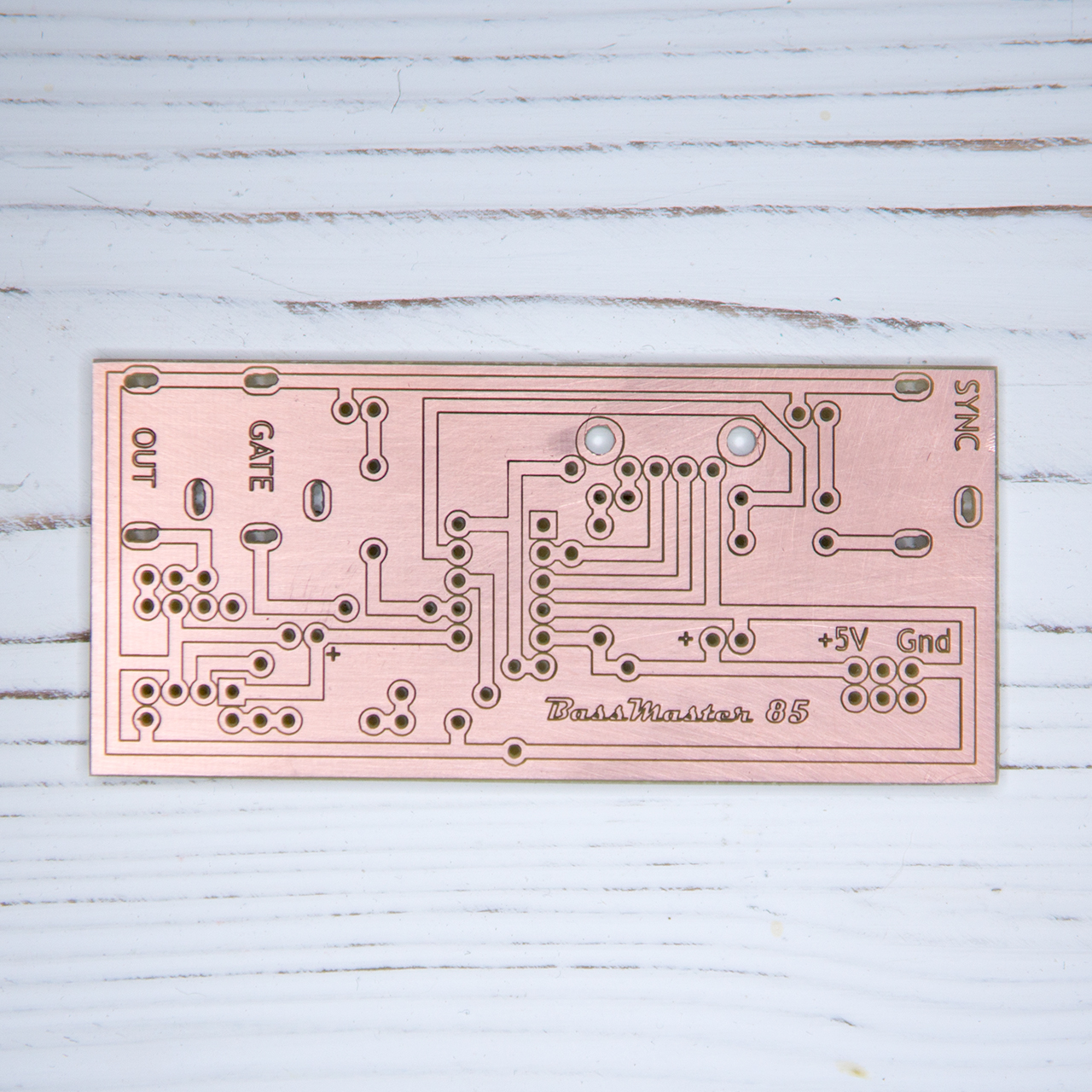

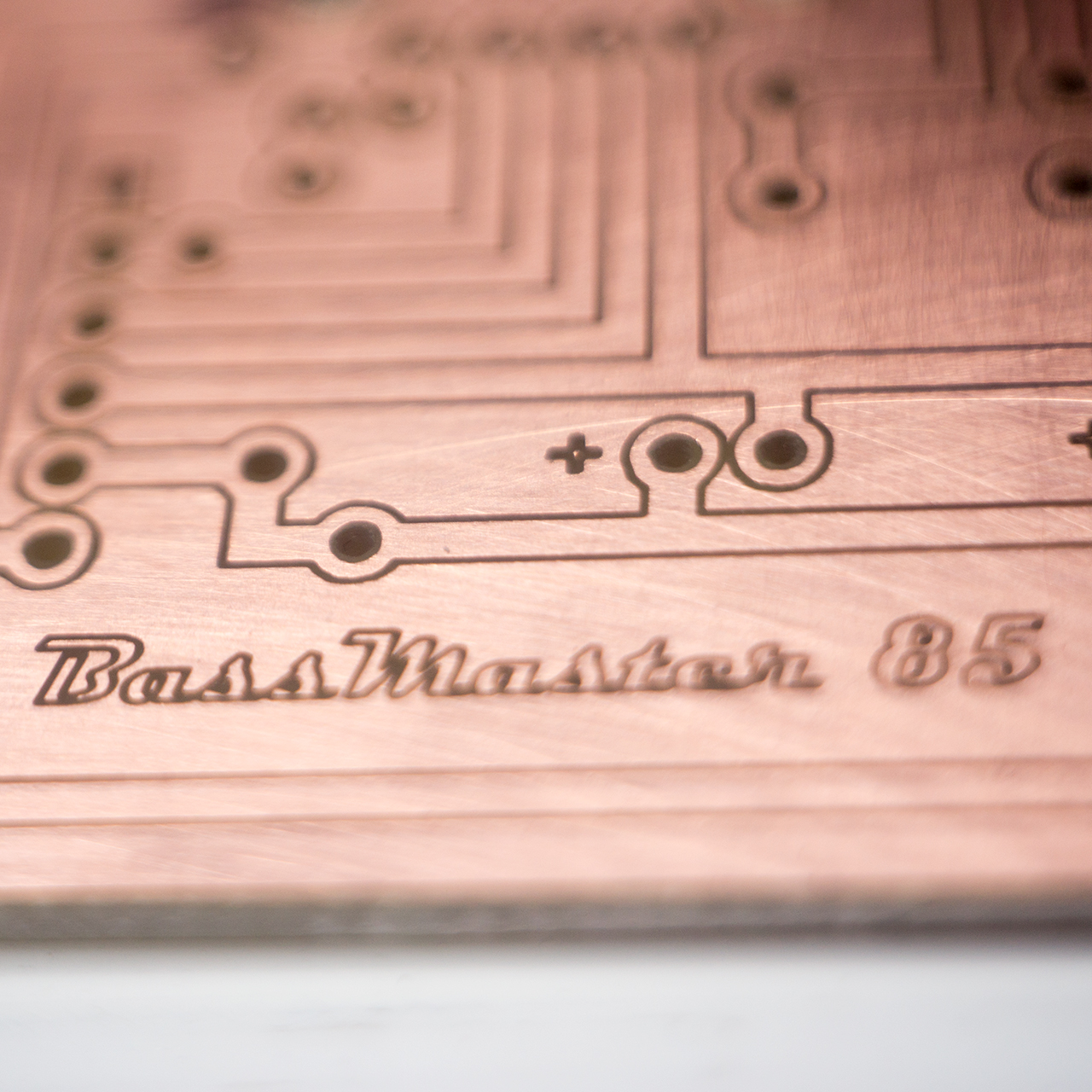

Now I can make single sided PCBs:

PostPosted: Wed Feb 27, 2019 11:51 am    Post subject: Reply with quote  Mark this post and the followings unread
Trying to etch a pcb. New circuit design and new code coming soon)
 Filesize:  880.03 KB
 Viewed:  435 Time(s)
 Filesize:  1015.44 KB
 Viewed:  408 Time(s)
