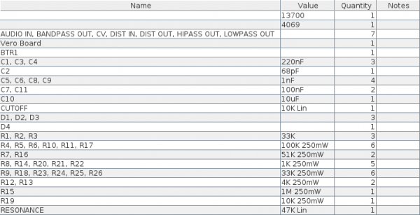

Hi.
I want to add a Wasp vcf to my modular rig, but i feel lazy and i don't want to etch a PCB for it.
I've been searching for a stripboard layout and i'm surprised to not find even one.
It's odd for such a popular circuit, so i made one.
I tried to get the smallest board i could, so i added some components to the pots and jacks.
It's not verified yet, but i'm pretty sure it's okay.
I hope this can help someone.

ceero
Joined: Jul 25, 2019
Posts: 2
Location: Norway
PostPosted: Thu Jul 25, 2019 8:40 am    Post subject: Reply with quote  Mark this post and the followings unread
I just made this, and got it working after scratching my head for a while.
There are 2 errors in the stripboard layout:
The connection from CD4069 pin 5 is supposed to go to LM13700 pin 12.
There's a 51k resistor missing between CD4069 pin 4 and LM13700 pin 13.
I've used resistors as shown in http://modular.fonik.de/pdf/Wasp%20Filter%20clone.pdf
I also put the capacitor and resistor seen in top right corner of the schematic on each of the outputs, and connected all the jacks to ground. Should be better if I'm understanding things correctly.(?)
I breadboarded it first, and then transfered the components from there to the stripboard, which really made it pretty easy to follow along and compare schematic to stripboard to breadboard as I went.
Anyways, it works. I have to find a better curve for the cutoff pot tho.
