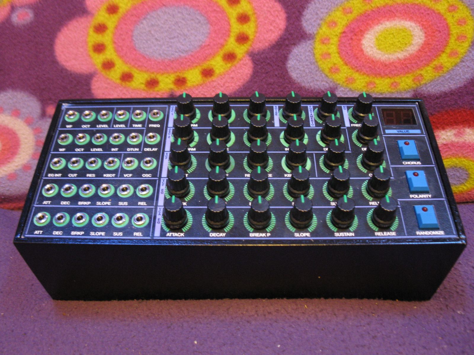

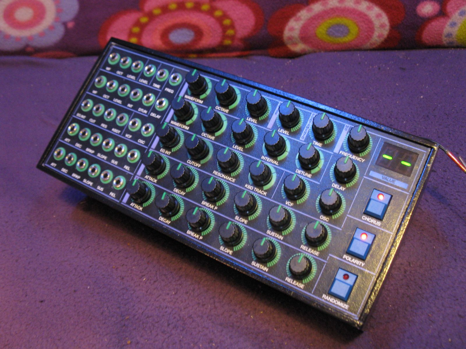

I finished it over the weekend Cool . I also added a DC output to the DW6000 with a diode and fuse in series as protection.
(will post the arduino sketch after cleaning it up a little bit)

That looks amazing, Phobos! afro
PostPosted: Thu Aug 30, 2018 2:04 am    Post subject: Reply with quote  Mark this post and the followings unread
Very, very, very tidy wiring.

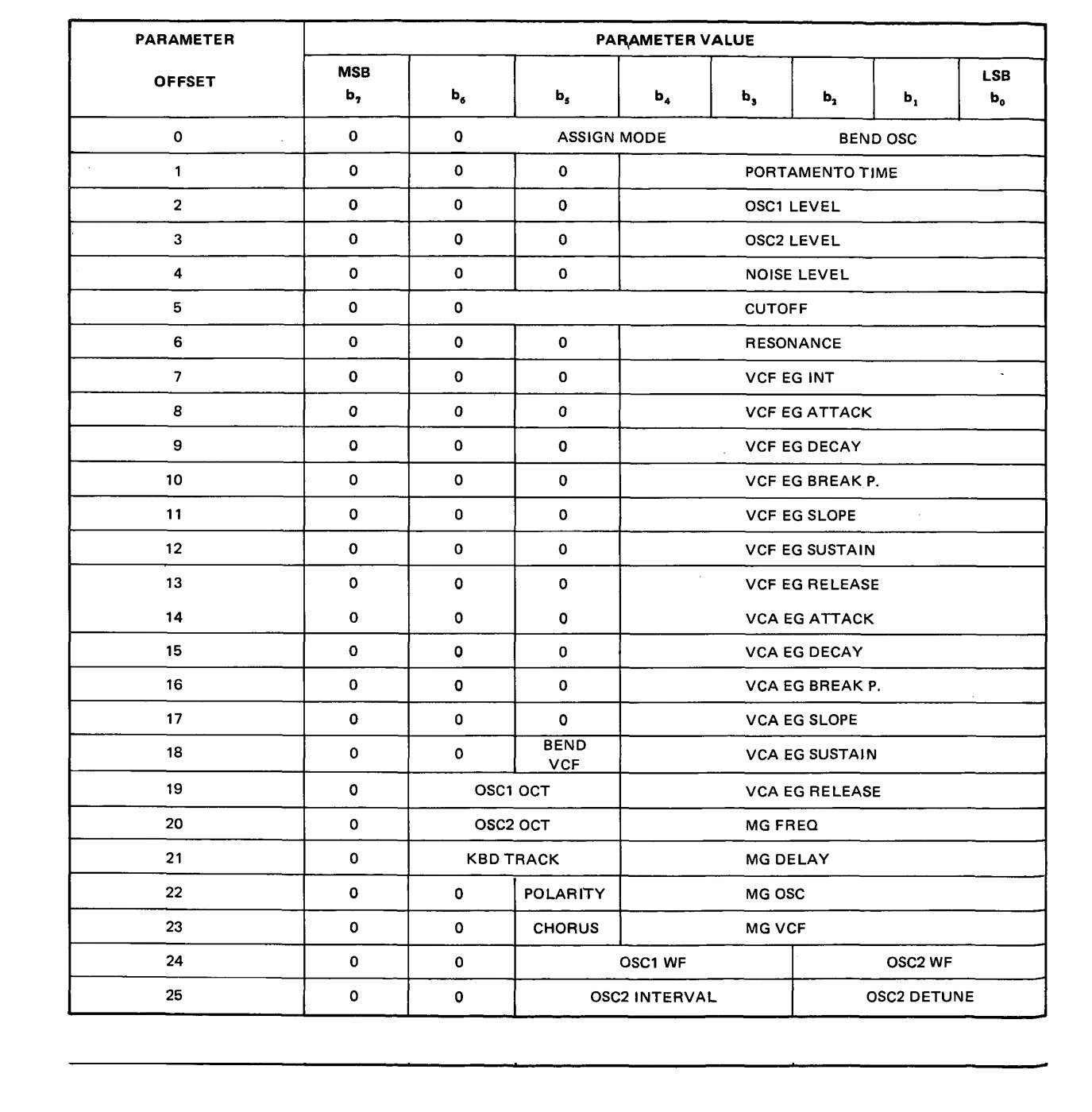

i have a question how do i write a sysex string with shared bytes
fh F0,42,30,04,41,18 -vv Normal8Bit,s,0-7,1 -fh F7
this is the string for the Waveforms osc 1 & osc 2
but i want to use them seperately
it's in your code but i dont understand it

It's pretty much the same as all the other parameters except that both get updated at the same time, it's not possibel to only do one of them.
So if you want to change the value of OSC1_waveform you have to send it together with the current value of OSC2_waveform so that one
gets updated with the same value.

okay kinda confusing
i thought i could control them separately ..
the code says OSC1_waveform [b5-b3] or OSC2_waveform [b2-b0]
#define OSC1_waveform_offset 24
#define OSC2_waveform_offset 24
which makes them 18 in hex
Posts: 5881
PostPosted: Tue Jan 22, 2019 10:26 am    Post subject: Reply with quote  Mark this post and the followings unread
Well they can be controlled seperately in the sense that they don't get changed by one control.
But you can't write values to them seperately. So when you want to update one of them you
always have to check what the value is of the other one, combine them into a single value and send that.
btw I mostly used binary values as that is how they are written in the manual and I also find it
easier to work with. If you are used to working with midi hex pobably makes more sense.
edit: so to change the waveform(s) you send:
F0,42,30,04,41,18,X,F7
where X is one number that has the values of both waveform 1 and waveform 2.

values are converted to 6bit. (this also makes it possible to store values in a single byte)
Code:
ctrl_val_read[CTRL] = analogRead(ana_1) >> 4;                       // read analog value from parameter control, convert to 6 bits (0..63) and store
ctrl_val_read[CTRL] = analogRead(ana_2) >> 4;                       // read analog value from parameter control, convert to 6 bits (0..63) and store
After reading the 'PARAMETER CONVERTER' is used to adjust and store the values in param_values[]. First the bit length gets adjusted
(except for cutoff which needs 6bits) and after that it is shifted if needed (for shared bytes) and finally stored.
Code:
switch (param_id) {
    case OSC1_waveform:                                 // OSC1_waveform:   b5-b3   (0..7)
      ctrl_value = ctrl_value / 8;                      // convert 6 bit value to 3 bits
      ctrl_value = ctrl_value << 3;                     // shift value to correct position
      break;
    case  OSC2_waveform:                                // OSC2_waveform:   b2-b0   (0..7)
      break;
param_values[param_id] = ctrl_value;                  // store new parameter value
The 'PARAMETER_MERGER' is used to create the actual byte value that is send to to the DW6000 which can either be a single value from param_values[]
or 2 values merged together (logic OR).
Code:
    case OSC1_waveform:                                 //  1. OSC1_waveform:   b5-b3
    case OSC2_waveform:                                 //  4. OSC2_waveform:   b2-b0
      merged_value = (param_values[OSC1_waveform] | param_values[OSC2_waveform]);
      break;

i'm talking about this...

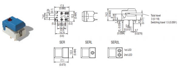

Hi PHOBoS, I plan to use the same Digitast switches in my project, mine are the narrow model (the only cap measures (12.3x17.1)mm).
In your panel design how much bigger is the cut-out with respect to the button itself? I was going for (12.3x17.5)mm (dimensions of the hole button) but I am worried that the switch might get stuck when pressed, and I have not so much space on my panel.
PS. Congrats for the final result, quite an impressive project Very Happy
These are the measures I am talking about
 Filesize:  107.83 KB
 Viewed:  277 Time(s)
Posts: 5881
PostPosted: Thu Aug 08, 2019 7:35 am    Post subject: Reply with quote  Mark this post and the followings unread
welcome party!
and thanks Very Happy
I just measured it and the switches are the same size. I can't measure it exactly and there is some play since i cut the holes myself
but it looks to be 13.0 x 18.0. Keep in mind that you need more space at the bottom of the switch than at the top. You actually don't
even need any extra space at the top, but I think it looks better. So I'd say about 0.3mm on the sides + the top and 0.5 at the bottom.
If you are planning to have the panel fabricated then keep tolerances in mind, it should be mentioned somewhere. It's probably not
very much but it's better to have the cutout a bit too large than just too small.
