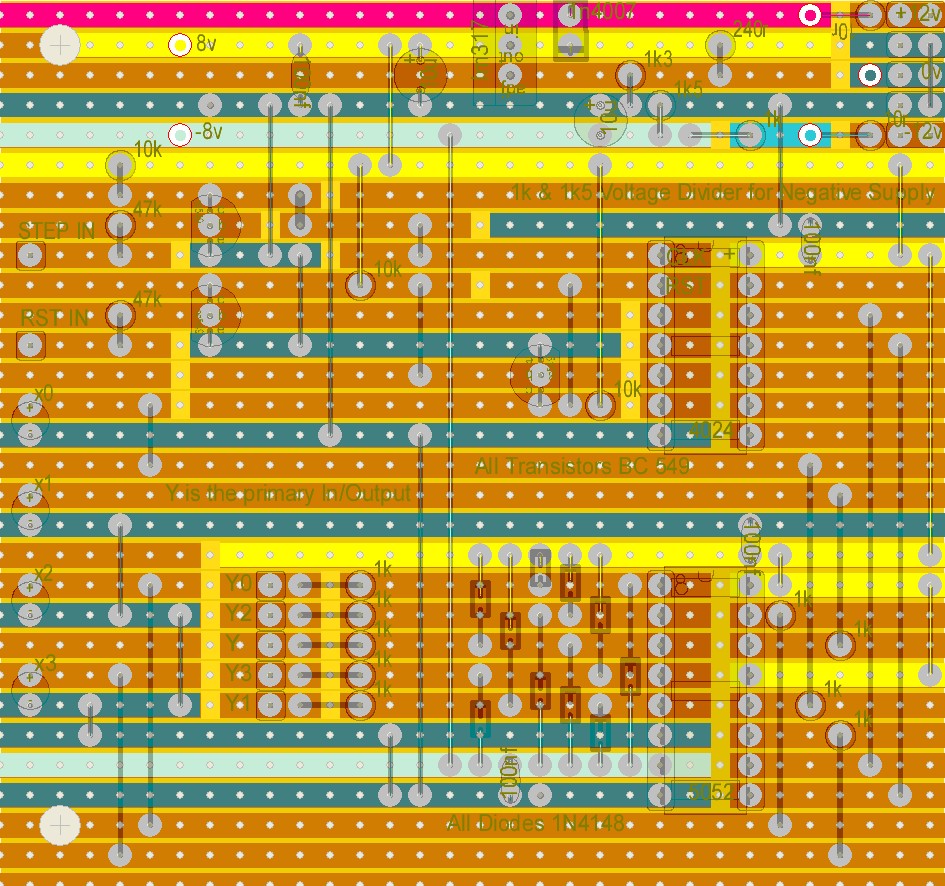

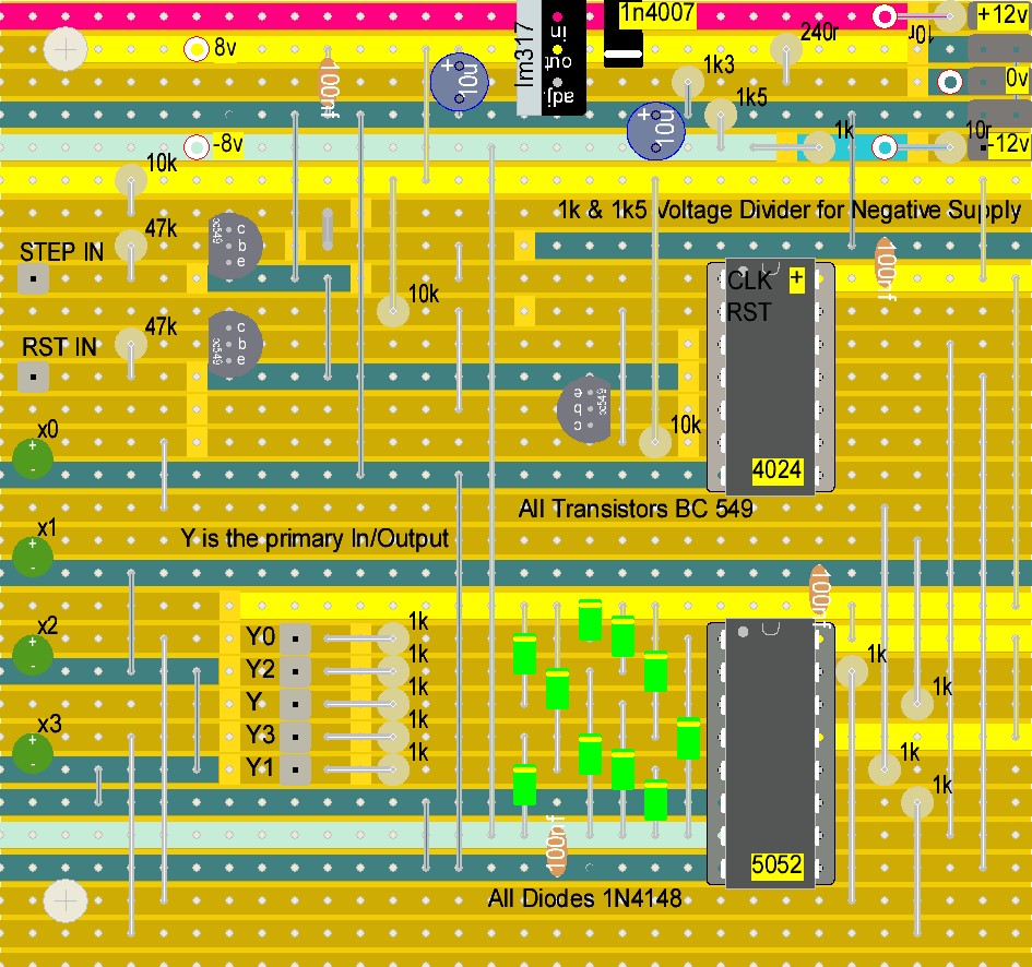

Its a easy and fun to use build.
Based on Doepfer A-151.
The primary input / output is alternately connected to y0 y1 y2 and y3 for each trigger pulse at the step input
