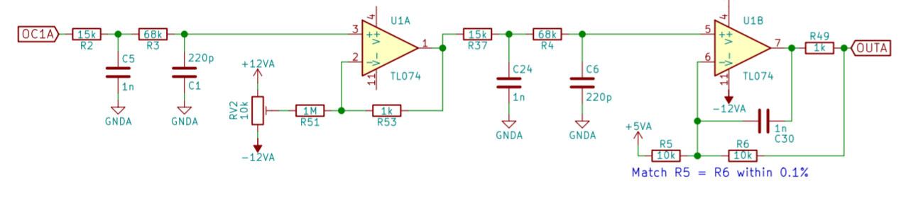

Regarding the PWM filtering (for the nano at least) Kassutronics has a pretty much perfect filter in this design:
https://github.com/kassu/KassutronicsQuantizer
The filtering is so good that you can perfectly quantize CVs for the modular with it and only takes 4 resistors and 4 caps. In fact I use just half of the poles it and keeps working wonders

PostPosted: Sun Dec 15, 2019 4:56 pm    Post subject: Reply with quote  Mark this post and the followings unread
The filter . I just use r2, r3, c5, c1, but you can make it double to even clean more the pwm signal
Thanks Mapache for this. I can see a lot of uses for this filter.
