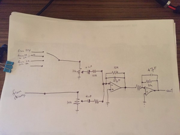

There is no need to add extra input decoupling before the inputs of an opamp based mixer like the one in the first schematic (as it is almost 'perfect' when the opamp has an almost 'infinite' open loop gain), unless you'd want to do pre-amplification or some other sort of signal processing - but then it would not be decoupling but pre-processing.

So, I realise this is an old thread, but what about the circuit below.
Note, I also want to switch between 3 different outputs (various filter outs) and mix in the drum signal.
at the moment (I haven't built this circuit) the 4 way switch creates annoying pops.
And, any tips on an op amp that runs on 9v or 7.5v would be great.
