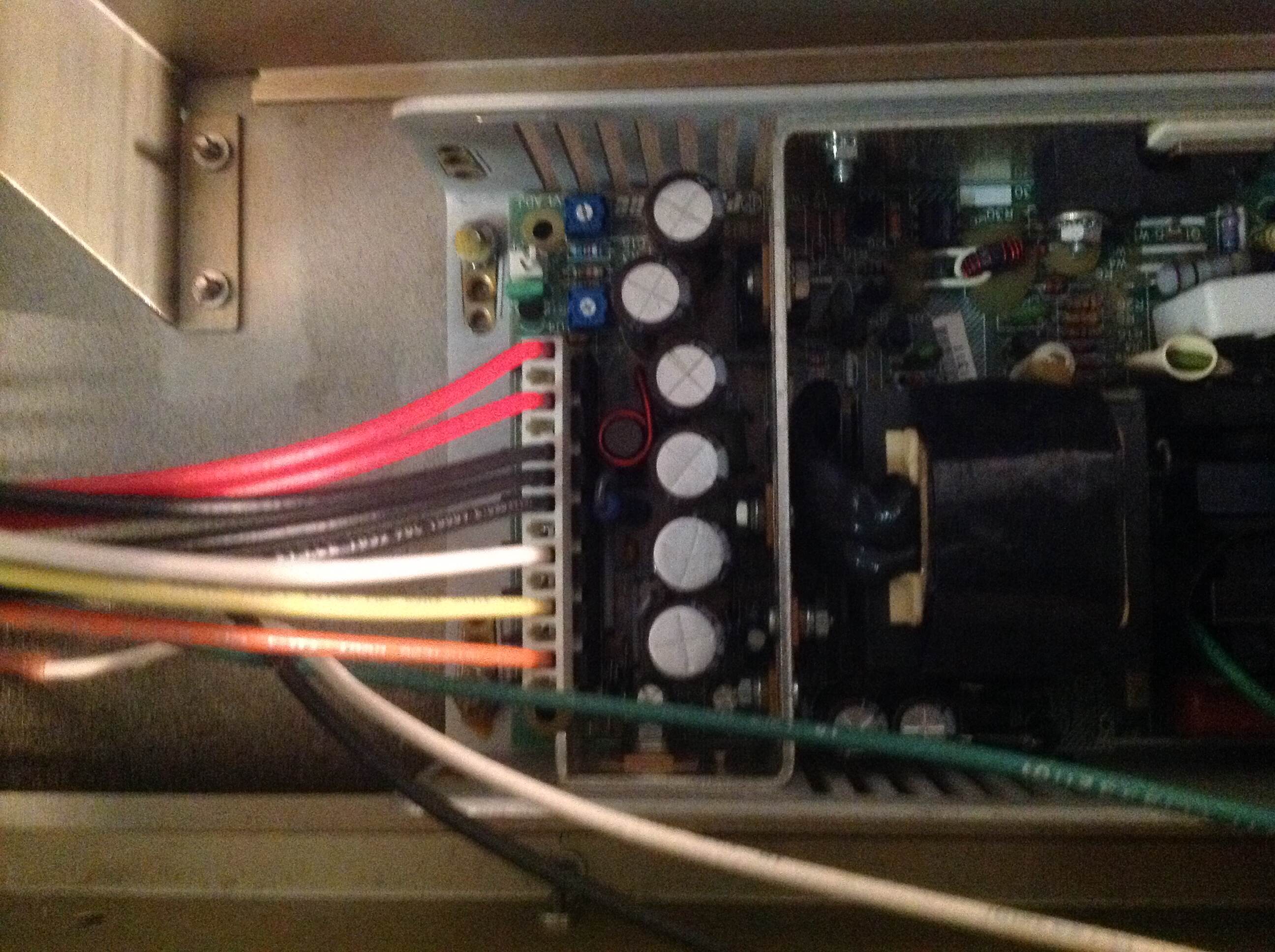

I got a reply from Symbolic Sounds, but am having some trouble doing what they suggested... :S
Basically they told me it can be some oxidation in the internal power connection, and that I should unplug those cables on the inside, and plug them back in...
However, I am unable to actually unplug them... :S
I don't particularly want to put much strength and risk damaging the boards, so I was wondering if there is any trick to remove them?
I tried it again after wiggling those cables a bit, but it was still giving me some problems, and this time it also displayed a new error, “the signal processor timed out on a write. (3)", before saying "No error. (0)” as I tried to reload it.. Sad
And I guess the problems I had with the CM Labs Motormix not being detected was likely a hint of this problem... :S
Would be great to fix it and actually be able to use the CM Labs Motormix again to control it!

The connectors may have a locking mechanism?
something you need to press before they can release - should be possible with just your fingers in that case .. like press and pull.

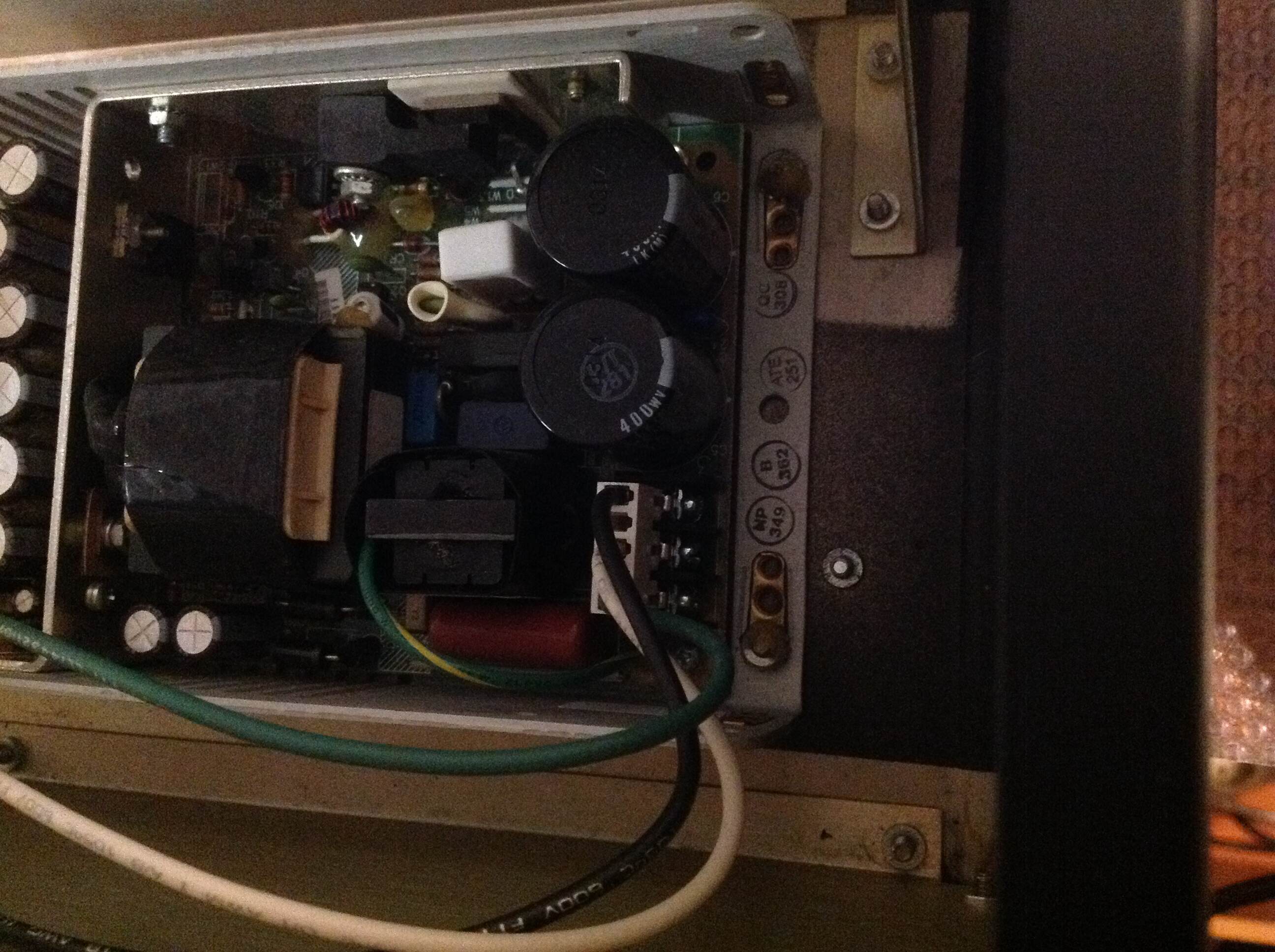

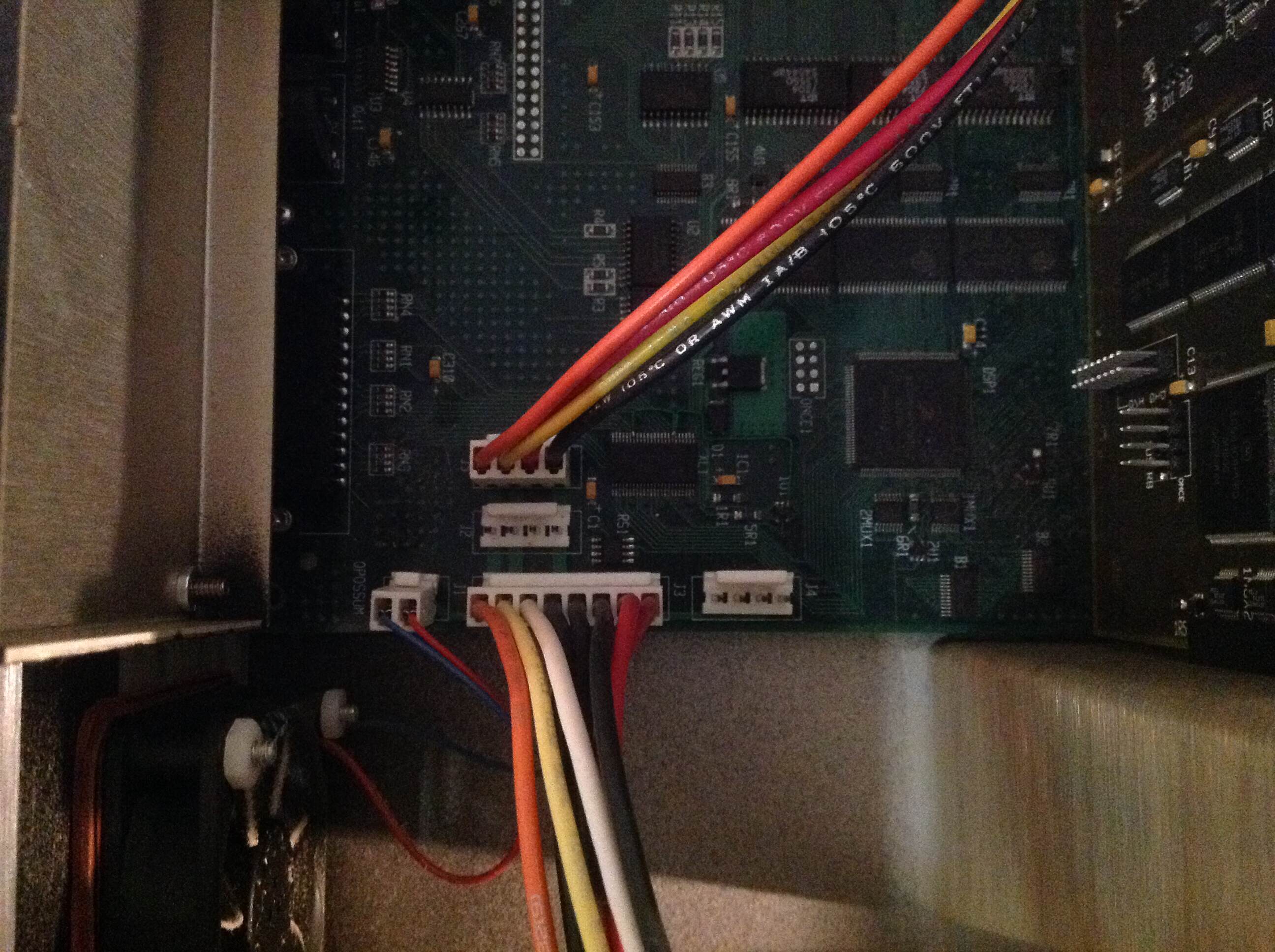

I'll just upload some photos...
Basically I was trying to unplug the cables that are connected to the power supply.
The one that came the most off was the green one, that connects the power supply to the power cable.
The other seemed to be even harder to remove... :S
The capacitor seem ok...
I guess that makes sense, just not sure exactly what should I do and rather not put excessive force and risk damaging the unit... :S

Looking at your images the connectors at the PSU end seem to be soldered on, the other end have tabs that need pulling away to get the connector off.
Maybe it is worth email them the pictures and asking what exactly you should be doing.

I was programming some sounds for the G1 in the computer and turned on the sound card to check and it was working well... Playing music as it should with no drops in connection and I even plugged in my iPad and the sound coming from it was ok...
I will give another try later to the other one, to check if it's working as it should as well!
Guess tabs would be a better name for those locks Razz
In the photo of the mainboard you can see that there is something white on the plug next to the cable I need...
As you plug in the cable, it's basically covering the cable and makes it really hard to unplug... :S
On the other end, it's a bit simpler, just few black ones, rather than a single long one, but all I could do was breaking one of them... :S
I feel a bit stupid I couldn't do this, but if you don't have much experience, sometimes it's better not to try too hard and risk breaking it... :S
