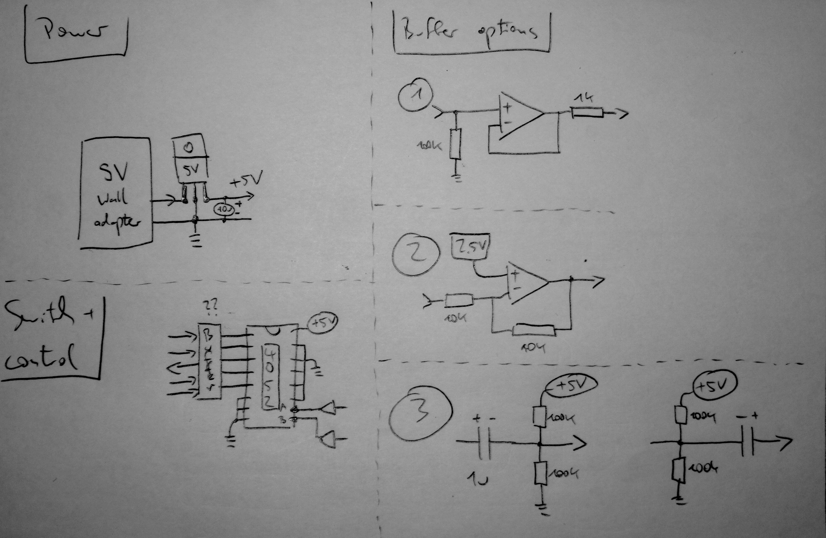

here the 'schematics' ...obliterated are 0.1u bypass caps for power supply and all ICs...my goal is to have the circuit run on +5V...(+9V would be okay if it improves things...I originally thought this could help with the "headroom" of the switch, but it doesn't seem to)...I already tried to run everything on +9V and even the 4052 on +/-12V...
the 4 different input/output options are:
1. simple opamp buffer
2. inverting opamp
3. dc filter +bias voltage
4. NO buffer
all the same (so far)...thoughts?

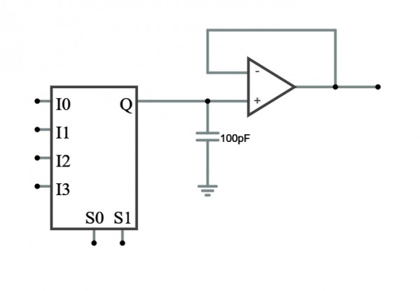

The datasheet says:
Break-Before-Make Switching Eliminates Channel Overlap
So, depending what the circuit after the Y-output is, there will be a short moment that the output is high impedance, so say if the Y-output is connected to a resistor the output will go for a short moment from the chosen input voltage to "0".
What you could try is to have the Y-output connected to a capacitor to gnd and buffer it, you could try different cap values or even add a resistor of say 100k parallel to the capacitor so you will have a constant decay time of the output voltage.

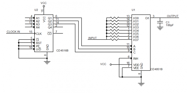

I have built a setup with a 4516 (presettable binary up/down counter) and a 4051 (single 8-channel analog multiplexer)
The inputs of the 4051 were all connected via 8 resistors to 3.3 volt (to make sure all inputs are same for input voltage and impedance), the chips were powered from 5 volt.
When looking at the output voltage of the 4051 there was some ripple caused (i suppose) by the difference in switch impedance and some leakage from the supplied A, B and C inputs.
But not really serious.
Maybe I could have diminished this ripple by making a voltage divider which was trimmable by a trimpot..
But when I added a slow sine wave going from 0 volt to 5 volt, I could hear this switching noise from about 2.5 volt input voltage and getting louder when this voltage rises.
So what You can do is raising the supply voltage (this will lower the switch impedance) and/or lower the resistor value in drawing 3 (the lowest 100k resistor)

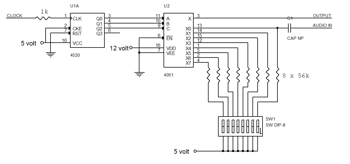

This morning I took a piece of perfboard because the solderless exp board proved to be useless...
So I soldered the below schematic to a piece of perfboard and had NO clock related noise as long as the DC voltages of the inputs are the same!
The only change I made was replacing the 4516 with a CD4520 and the 8 resistors (56k) were connected via 8 switches so I could test what happens if one of the inputs is floating and to connect a signal via the 56k to an input.
Of course if you switch while your input signal is NOT (in this case) 5 volt, you will hear a glitch like PHOBoS already pointed out, but that has nothing to do with leakage of the clock signal but the time when you switch.
And also, if your signal goes below 0 volt or above 12 volt you will hear the clock signal, but then you are using the CD4051 outside its working limits.
The output of the schematic I used is connected to a mixer with an input impedance of 100k.
Resuming: The circuit is solid! Just take care of the timing when you switch and of your input voltages.

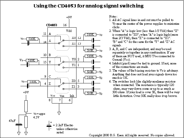

Found this….
And looking at this circuit I realise that the output of the switch(es) should also be pullen up the same as the inputs, with this remark that concerning the 4051 always one input is connected to the output except a short while during switching.
 Filesize:  11 KB
 Viewed:  170 Time(s)
my synth
Posts: 5845
PostPosted: Wed Jan 19, 2022 7:58 am    Post subject: Reply with quote  Mark this post and the followings unread
that's basically option 3 from this:
and what I am familiar with.
With the difference that they set the reference voltage once and connect every in-/output to it with a seperate resistor instead
of setting the reference voltage independently for each in-/output. Not sure how much difference that makes. I guess the reference
voltage wouldn't vary which could otherwise happen because of the tolerance in component values but having it connected through
a resistor might cause some more drifting. I would probably at least add an opamp to buffer the reference voltage and use some
lower value resistors (instead of the 510K).
