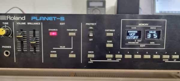

I never liked my MKS-30 displays, too difficult to remember what was what without resorting to the quick guides, so I decided to add some intelligence to the displays by replacing the dual 7 segment displays with dual 0.96" OLEDs and a Teensy 4.1 to interpret all the possible options that the displays could show.
I did a dual Arduino version, but it was slow and really just a copy of what was available, so with the Teensy I had more speed, power, memory and the capability to read in all 4 digits of the LEDs and produce some more informative displays.
https://youtu.be/2-Iy85YFpUE
Details can be found here
https://github.com/craigyjp/Roland-MKS-30-OLED-upgrade-MK-II
