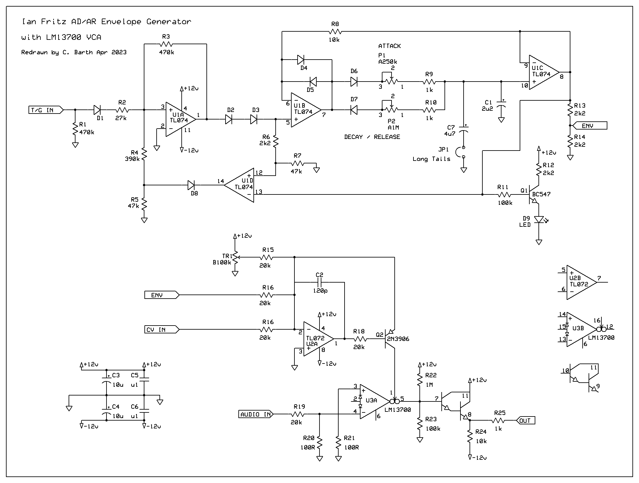

The schematic, below, is what I currently have on my breadboard. It is Ian Fritz' AD AR Generator feeding a LM13700 VCA. It's working great. I plan to build two of them into a single module. The schematic only represents a single channel. However, I am also interested in adding a choke switch, such that Ch1 trigger input will choke Ch2 output. But, I don't have a clue and could use some advice. Haven't been too successful searching online, either.
Instead of looking at the envelope generator to produce the choke, I am guessing that the VCA should just be closed, somehow? Perhaps a trigger input to Ch1 produces a low gate (close VCA2) and a trigger to Ch2 causes that same gate to go high (re-open VCA2), again, somehow? I don't know. Right or wrong I have no idea how to do that, anyway. Definitely need some help.
Are there any thoughts or ideas on how to incorporate a choke switch into the schematic posted here? Presume the schematic is showing Ch2 and a remote trigger (to Ch1) would silence the output. If not, any info on how best to implement a choke, even if different ENV or VCA circuits would be required would be much appreciated! Much thanks, in advance!

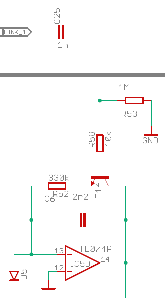

I could be wrong, but it looks like the switch at LINK1, between Envelope 1 and Envelope 2, is one of the two choke switches. The other at LINK2 between Envelopes 3 & 4.
Is anyone able to decipher what is going on with the Choke switch in the Percall? How it works? I looks like there might be some similarities between the Percall and Ian's AD AR, maybe? While the Percall only has Decay control, Ian Fritz' AD AR also has Attack. Is the VCA really not involved with the choke? Could something similar to the Percall's method be adapted to work with a pair of Ian Fritz' AD AR circuits?

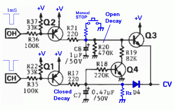

Ugh. Gave me a headache just looking at it. A textbook example of "over engineered." There's far simpler ways to generate percussion envelopes. The design of the Roland DR-110 is one that especially appeals to me.
When an Open trigger OH arrives an envelope with a longish Decay will be generated by C8 and R20. The voltage buffered by transistor Q3 is the CV sent to a VCA (not shown). A Closed trigger (CH) on the other hand will generate a shorter Decay due to C7 being smaller than C8.
If a CH should occur after an OH, while an Open Decay is in progress, that Decay will be shortened by Q4 and R19 discharging C8 faster than R20. OH after CH would produce the classic t-tsss sound. OH and CH simultaneously will produce a Decay between fully Open and completely Closed.
Replace Q1 and Q2 with opamps to condition positive triggers, add another to buffer CV and amplify or attenuate as needed, depending on the maximum EG level desired and what +V is. (Rx would be needed to ensure Closed Decay is short.)
A push button cold be included to manually Choke - er, I mean Stop the Hi Hat. There are other possibilities that could be even simpler.

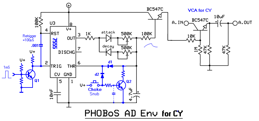

I would have replied sooner, but I first wanted to find the time to try the Choke snippet from the Percall (attached below) with the Ian Fritz AD AR envelope generator currently on my breadboard (scheme above). Unfortunately, no joy. I am guessing that IC5D in the Percall could correspond to U1C in my scheme of Ian's AD AR. Tried a couple of different arrangements based on that assumption, none of which seemed to work.
With fixed attack and decay, yeah, the DR-110 does look nice and simple. Especially next to the Percall! I am looking to have both adjustable Attack and Decay. I found Ian's circuit here and it's working great for me. But I thought adding a Choke control between 2 channels would be useful.
Would it be reasonably possible to implement a choke switch between 2 channels of Ian Fritz' AD AR circuit? Or, does that particular envelope generator just not lend itself to such modification?

I'd suggest putting a transistor (or a mechanical or analog switch) across the Decay pot in Ian's AD/AR. But what do you mean by "between 2 channels"?
In general percussion doesn't need adjustable Attack, but if it's available, when applied to a Cymbal would create a Swish sound. Coupled with a short Decay could give "Reverse" Cymbal, which is always fun to hear.
I've included my thoughts for using a PHOBoS 555 circuit for a Cymbal EG. While pressing the Choke/Snub button causes Q2 to discharge the 4.7uF cap, diode d2 will falsely exceed the THReshold voltage and the 555 OUT will go low.
If the various datasheets for cmos 555s are to be believed, making RST and TRIG low at the same time should achieve retriggering during an Attack already in progress. Please note I HAVE NOT TRIED THIS YET.
Open Decay could be made adjustable by substituting a pot for R20. One way the '110 circuit might be further simplified would be to instead of adding the CH EG to the the VCA just let Q4 shorten the Open Decay.
Thanks. I'll give that a try. But how and what would the base of the transistor connect to?
I am thinking of a module that, on the surface, would be similar to half of a Percall, with two in/out channels and a choke switch. However, internally, it would consist of two instances of Ian's AD/AR, and the switch would enable/disable the choke function. When enabled, a trigger to channel 1 would not only trigger envelope 1 but would also choke, or stop, the output from channel 2. So, it would be capable of producing the kinds of backwards type sounds you described.
I presume that button could be replaced with a transistor and triggered remotely from another source?
