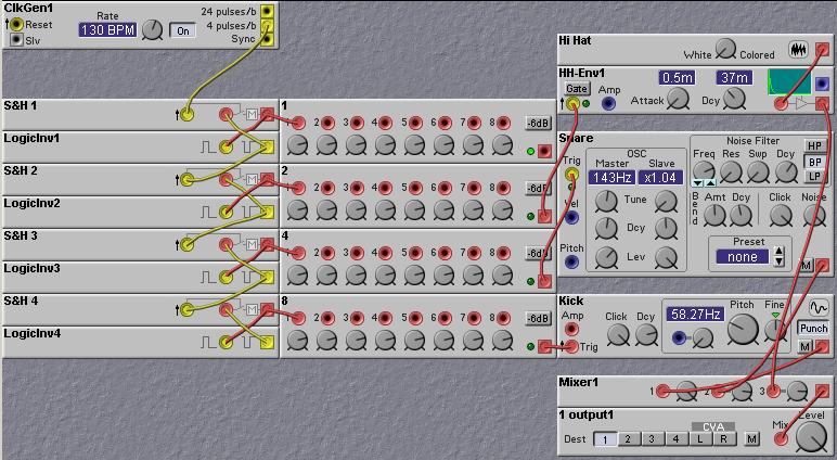

BAD Confused
I've been trying hard to do it but I ran into lots of problems...
In this patch I couldn't manage to reset the bincounter so the kick only play once in the sequence...
Any idea what am I doing wrong?
Thanks to worry, Kassen Smile
bad bincouter with no reset....

PostPosted: Wed Aug 31, 2005 5:45 am    Post subject: Reply with quote  Mark this post and the followings unread
This does look rather good to me, realy.
If there's something wrong with this I don't see it at the moment (that could happen; everybody makes oopses, including me).
Either way I think it's very encouraging that you got the link between flipflops and binary counters, you shouldn't say "bad" at all! Some of my "advanced asignments" were rather challenging, but hey, you *need" to solve some puzzles to get it all down and make it your own.
I fear I'm going to have to bounce around a little for two days (meaning apointments, dates, living out of a laptop bag, working at stray moments) so I won't be able to have a detailed look at your patch right now. I should be back in two days.
Hint about the reset; resetting a flipflop means making sure it stores a "zero", resetting a bincounter means all flipflops store zeros.
(hints; written in white on white to avoid spoilers, highlight to read)
Hint2; This means sending a trigger to the S&H while the input of the S&H is zero
Hint3; You can "break a logic cable" by patching it through a AND and feeding the other input a "one", as soon as that "one" goes to "zero" the cable is broken.
(end of hints)
Of cource there are always more then one ways to do something; some are cheap cpu-wise, others are easy on the memory of the chips and yet others are pleasant because they are easy to understand.
We are also eating rather a lot of resources here, building our own binary counter but sometimes there is no other way and of cource it's fun and educational. Well, at the least it's educational and I'm having fun, hope you do too. :¬)

.... just thought I should point out here, for anyone who isn't aware, that this S/H + Logic inverter idea also works just fine at audio rates, so when you clock the S/H from an audio waveform the output of the flip flop is a sub-octave sqaure wave. Very cheap way to add a sub osc signal to your patch!
