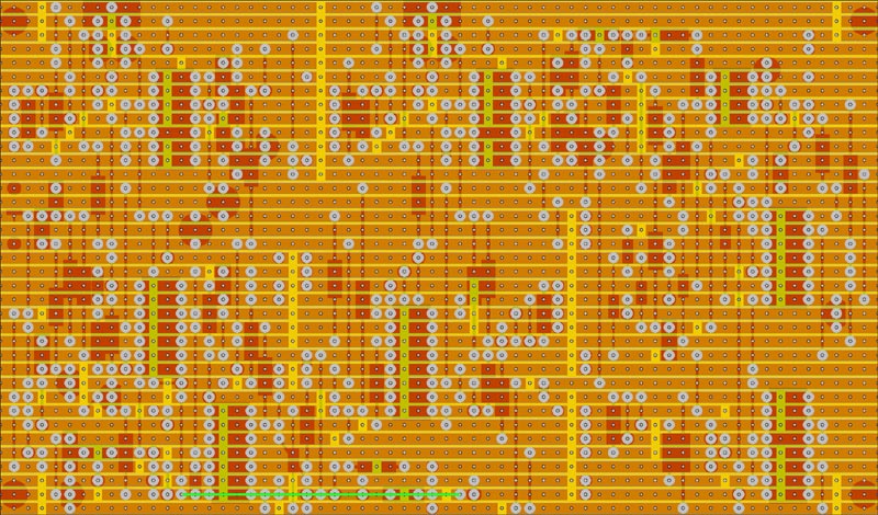

so - did you post the moded version then? i'm interested in building one...
PostPosted: Sat Jan 14, 2006 3:17 pm    Post subject: Reply with quote  Mark this post and the followings unread
I think I posted a closeup of the S&H section on another thread, I can't remember now.
Anyway, here's a copy of V2.0 which includes the S&H and the 1V/Oct mods. The designators for the S&H are as per Ray's Schem +300. Note the orientation of the chips, and the three "weird" links. Two diagonal ones on front, and one long horizontal on back.
This layout now looks (and is) cramped in the top left corner, compared to some space I could probably steal from elsewhere. I'd like to refine it sometime, but it's one of those jobs I haven't gotten around to yet. Besides, at this stage I can gaurantee that the whole board (except the S&H) works perfectly. If you build it and the S&H works please let me know, as it may be a while before I get the chance to check it myself.
 Filesize:  164.52 KB
 Viewed:  72267 Time(s)

PostPosted: Sat Jan 14, 2006 3:19 pm    Post subject: Reply with quote  Mark this post and the followings unread
Here's the copperside view.

PostPosted: Sat Jan 14, 2006 3:22 pm    Post subject: Reply with quote  Mark this post and the followings unread
sweet! what about the underside? i mean... where the traces are cut.
note: i've never done a stripboard anything YET.

thanks for the welcome, i'm currently deciding whether to buy the pcb or to make a stripboard version... the latter can last right? i mean.. it's not meant only for testing purposes?

If I had the choice, I would go for Ray's PCB. Stripboard is a real chore- and is a sort of nostalgic thing used by people who are well into self harm (basically masochists!!!)

PostPosted: Sun Jan 22, 2006 6:17 am    Post subject: Reply with quote  Mark this post and the followings unread
hi !
Uncle Krunkus can you explain me what is for the 2 circles that are
under the R60 and R61
the same for the Old StripBoard version
http://www.musicfromouterspace.com/analogsynth/SOUNDLABMINISYNTH/SoundLabStripBoard.html
i have not connected them to nothing ....
what are they for ?
Thanks
Pedro
www.pedroinf.plastic4records.com
PostPosted: Sun Jan 22, 2006 7:51 am    Post subject: Reply with quote  Mark this post and the followings unread
I put them there to remind myself (mostly) that if the tempco mod is implemented (replaces R60/61) they need to be sat between the 2N3904s and thermally packaged somehow to get the best 1V/Oct tracking.
The red circle (in my mind) means the resistor and the 2 transistors are thermally "connected" if you know what I mean.

Does version 1 of this layout (the one that's on the sound lab site) include the 1V/oct mod? Or will I have to add it. I've decided not to do the sample and hold for right now.
PostPosted: Wed Jul 04, 2007 6:53 pm    Post subject: Reply with quote  Mark this post and the followings unread
No, the one on the SoundLab page doesn't include the 1V/Oct mod. The one further up this page does. It also includes the S&H in the top left corner. Just isolate which bits you don't need, and omit them if you don't want it.
