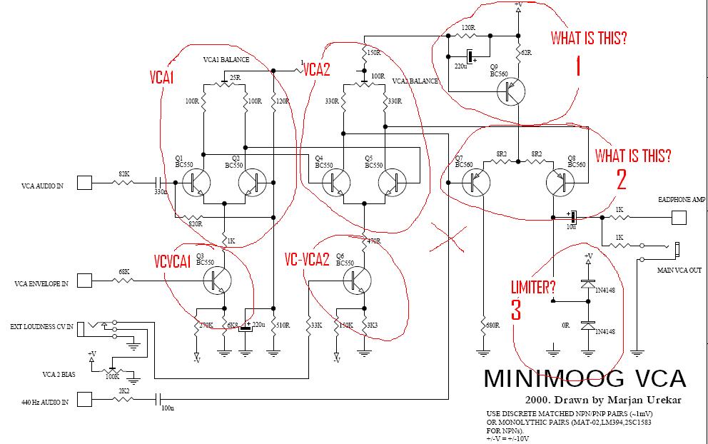

I understand... VC2 affects the signal after it pass through VC1...
I have some questions more Mr. Green
What function have parts marked 1,2 and 3 in the following picture?
Good questions Smile
VCA1 and VCA2 on your circuit are called "Gm Cells" or "Transconductance Cells". They are actually controlled by current (not voltage), and the current to control them is provided by the transistors below each one of them. These transistors are called the Current Sinks.
The "What is This 1", on the other hand, is a current source. Realize the difference? The current sink controls how much current flows *into* it, while the current source controls how much current flows *out* of it. (But the current source here is fixed... we don't control it...)
"What is This 2" is just the output stage. It's a discrete operational amplifier and could be replaced by an op-amp chip (such as the TL072). Here's an example:
http://yusynth.net/Modular/EN/VCA/index.html
The Diodes on "What is This 3" are there just for protection, to prevent the signal from becoming lower than GND or higher than +V.
Hope it's clear! If anyone else thinks there's anything wrong here, feel free to correct it, 'cause I'm learning too Smile

Thanks, Your explantion and the link of yusynth helps me a lot.

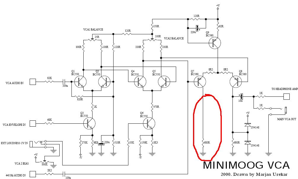

Other question is ... If I would put another output in the leg that I marked in the following picture... I would achieve a negative output? I meant 180º output of the actual output.
 Filesize:  62.81 KB
 Viewed:  881 Time(s)
yusynth
Joined: Nov 24, 2005
Posts: 1314
PostPosted: Tue Feb 12, 2008 5:34 am    Post subject: Reply with quote  Mark this post and the followings unread
Yes it will be a negative output, that's what is done in the Moog 902 VCA module.
Yves

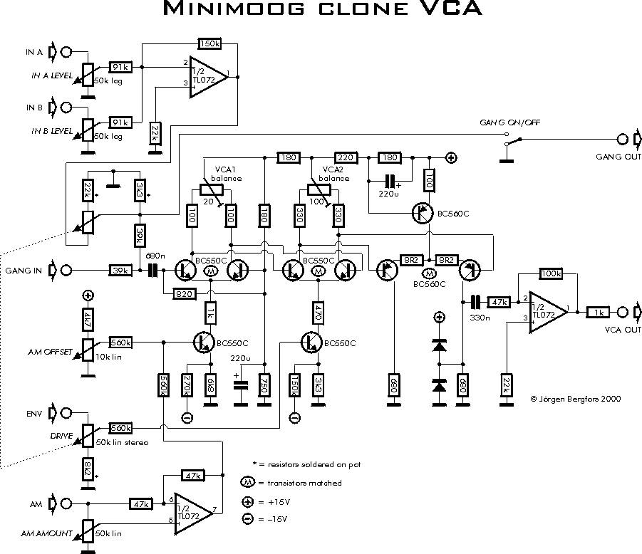

Yes! It is an amazing website. I like it very much. But I didn't understand one thing... In his schematics he applies the envelope to the second VCA. So... It will work if the first VCA is closed?
From http://hem.bredband.net/bersyn/VCA%20Minimoog.GIF

sound wrote:
YBut I didn't understand one thing... In his schematics he applies the envelope to the second VCA. So... It will work if the first VCA is closed?
Sure, but it's just a matter of cranking up the AM OFFSET pot to fully open it.
Yves

Can the VCA2 close the signal of the CVA1?... Definitely I need to breadboard it Mr. Green I have alredy orered the BC550 &BC560. Waiting for them. Very Happy
