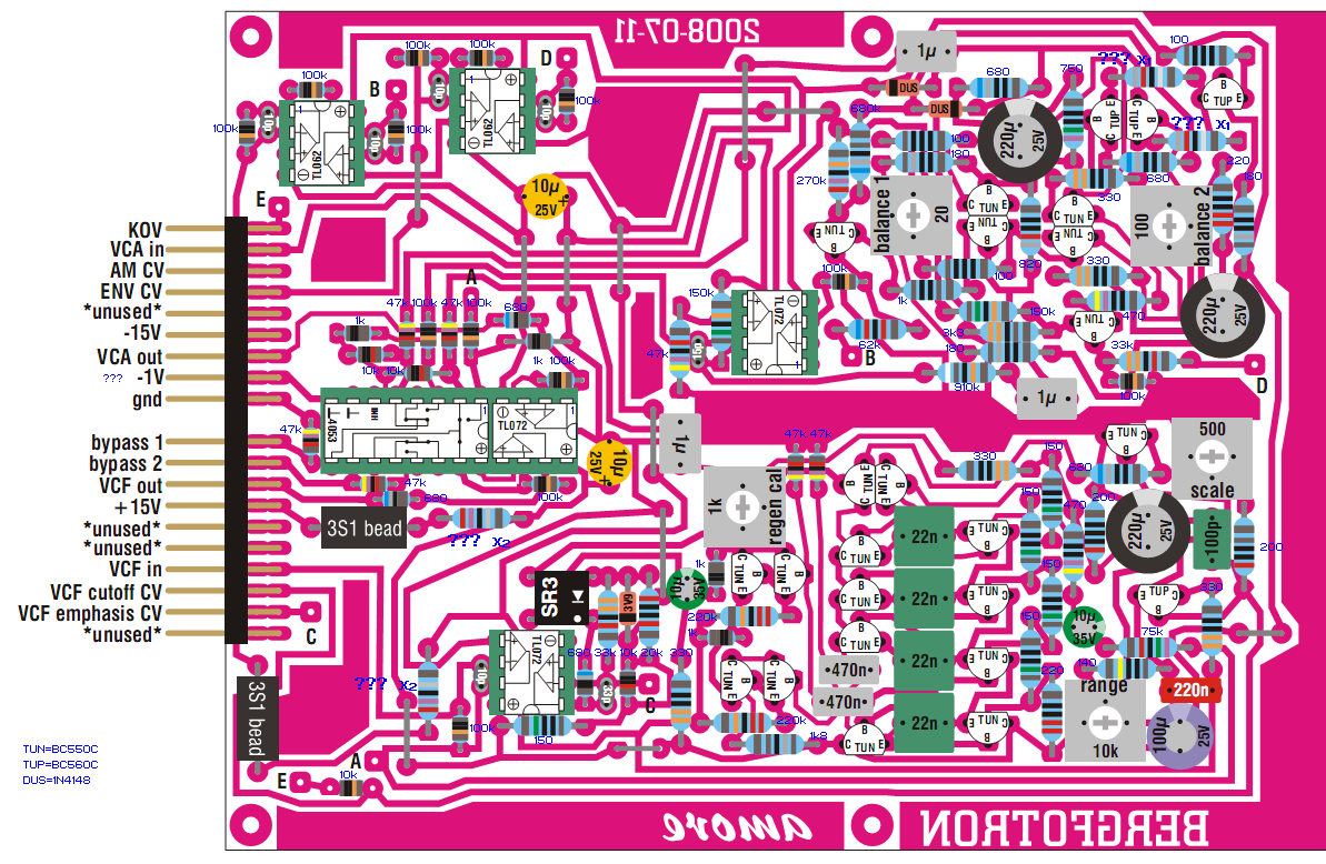

PostPosted: Sat Dec 12, 2009 5:08 am    Post subject: Reply with quote  Mark this post and the followings unread
I'm upping this topic as I'm going to build this vcf+vca by Bergfotron, but I got cunfused a bit with the resistors values. Of course, I see the schemes aforesaid, but in the component placement file:
http://hem.bredband.net/bersyn/VCF/VCFPCB_k.pdf
the color decoding of resistors differs a bit from the common used color table. It will be very nice if you will post all the resistors' nominals used in this vcf+vca project, but if no, could you at least give me a solution how to "read" Jörgen Bergfors' color scheme of resistors?
Matching the R by this scheme http://www.breakup.de/resources/resistor.html I get 10 ohm values where should be placed 100K etc.
Of corse, the simpliest way is to rebuilt all the scheme from the original scheme from the beginning, but there are other projects in the web (for example, this minimoog vcf+vca built on smt elements
http://diyfactory.ru/forum/forums.html?act=Attach&type=post&id=4828) where all the values are specified.
but I really liked the Jorgen's PCB so I don't think that Bergfotron on his webpage was purposely made errors in PCB to prevent copypaste?

PostPosted: Sat Dec 12, 2009 1:25 pm    Post subject: Reply with quote  Mark this post and the followings unread
Dear friends!
Appreciate your help & I've almost finished the resistors' identification using this calc:
http://www.musicfromouterspace.com/ElectronicTools/ResistorChart.html
But there are still some values I couldn't identified. I marked them x1 and x2.
Kindly see the image attached or the alternative link.
Could you suppose what it could be?
And if it is not difficult for you, kindly ask you to check other values. At least a few ones...
From the resistor's calc I defined that the values of x2 could be either 27R or 80K.
But since the x2 filters the power, there will be noting after 80k in the chain. That's why I suppose it could be 27 Ohm.
By the second res. caculator I got the X1 value of 820000M what sounds strange a bit.
What do you think?
p.s.: could you also answer what SR3 is? is it some kind of a diode bridge of array?
http://www.alldatasheet.com/datasheet-pdf/pdf/178546/PROTEC/SR3.3.html
how will be the right placement of it?
and what means -1V input? it lockes the 6-7-8 pins on CD4053
p.s.2: the original image attached is the copyright of Bergsyn.
 Filesize:  330.71 KB
 Viewed:  269 Time(s)

PostPosted: Sat Dec 12, 2009 3:32 pm    Post subject: Reply with quote  Mark this post and the followings unread
Looking at this circuit board I'm surprised that the apparent -15V connection apparently goes nowhere.
I would suggest that the lower *unused connection is actually the correct -15V connection. The 3S1 beads would then be just basic ferrite beads and the X2 resistors would be correct at 2R7 (2.7) Ohms. If you trace this *unused connection, it is connected to the - connections on the TLxxx opamps, which also reinforces the view that this is the proper -15V connection.
Looking at the original circuit diagram for the VCA, the X1 resistors should be 8R2 (8.2 ohms).
I would say that the confusing band on these resistors is actually silver, not white (compare the 910K resistor with X1), this may then be a multiplier of 0.01. Look at the 1% tolerance resistors on the resistor reference page sebo linked to:
http://www.hobby-hour.com/electronics/resistorcalculator.php
Hope this helps
Magman

PostPosted: Sat Dec 12, 2009 4:15 pm    Post subject: Reply with quote  Mark this post and the followings unread
Thank you very much for help! Everything clear with resistors for now and turned out as I supposed.
SR3 is a optocouple for resonance control
http://electro-music.com/forum/viewtopic.php?highlight=sr3&t=29839
2s1 bead - are ferrite beads (as one can use 10 ohm resistors instead (I saw them in Yusynth, for example)
the one point that still confuses me is -1V

PostPosted: Sat Dec 12, 2009 7:06 pm    Post subject: Reply with quote  Mark this post and the followings unread
Hi:
Go to the Bergfotron site and read the AMORE spec. You will find that the -1V
is a reference for VCOs, I don't know for what is used in this circuit.
In the AMORE spec there is a circuit to generate that -1V
The -15V connection is not showed in this layou because is masked by the header.
As I said before the resistors are 1%, so the last band SHOULD BE always
brown, so x2 is 27 ohms (is used for short circuit protection).
Also the multiplier band (BROWN one) is slightly wider in the layout (sadly
is not in the real resistors).
Don't use 10ohms resistors instead of the ferrite beads, as the 27 ohms are
in series. If you don't have ferrite beads use a jumper.
Hope this help.
Sebo

PostPosted: Sun Dec 13, 2009 1:27 am    Post subject: Reply with quote  Mark this post and the followings unread
Well spotted sebo.
I should have looked at the circuit board layout to check this, rather than just looking at the component placement.
Just to confirm for ultrashock, the -15V connection on the header is correct (there is a trace hidden by the header). The lower *unused connection is indeed unused.
I still read the X2 resistors as 2R7 (2.7 ohms) though, not 27R from the supplied colour coding. If this is correct, then I believe that the ferrite beads should be replaced by 10R (but better still, use the ferrite beads, as they can filter out some PSU noise from getting into the circuit), rather than a wire link.
Regards
Magman

PostPosted: Sun Dec 13, 2009 2:46 am    Post subject: Reply with quote  Mark this post and the followings unread
Kindly find attached updated version of the components' placement.
according to the 4053 datasheet
http://www.premiumorange.com/daniel.robert9/anglais/Digit/Data_book_CMOS.html#4053
the 8pin is ground.
According to the Bergsyn PCB layout
http://hem.bredband.net/bersyn/VCF/VCF+VCA_PCB_l.pdf
the 6, 7 and 8 pins are connected together that's why I'm asking could we connect them directly to the GRND pin (I'm not going to be compartible with AMORE ideology)?
 Filesize:  330.74 KB
 Viewed:  226 Time(s)

PostPosted: Sun Dec 13, 2009 3:29 pm    Post subject: Reply with quote  Mark this post and the followings unread
Hi magmans:
You are right x2 is 2R7. About the ferrite beads, they are for line filtering, and
sometimes are replaced by 10R resistors, because this resistors helps to
protect the components from short circuits (the resistor acts as a fuse). In this
case x2 is the resistor for short circuit protection, so another resistor is not
necessary.
Hi ultrashock:
About the 4053, I don't know exactly what this switch is doing, as the Bergfotron
have a lot of automation in it I suppose is for something to do with that, I will
look at the schematics later to see if I can understand why is connected to -1V
instead to GND. Anyway generating a -1V is a very simple task using a simple
resistor network.
Sebo

PostPosted: Mon Dec 14, 2009 1:26 am    Post subject: Reply with quote  Mark this post and the followings unread
Sebo, thanx for your help! Looking forward for your reply asap!
BTW, I've found out that 4053 is a triple analogical multiplexer/demultiplexer with 2 channels
then everything is right and -1V flows for range widening.. althought more voltage could be feed I think.... what do you think?
magman
Joined: Feb 04, 2009
Posts: 363
Location: Liverpool, UK
PostPosted: Mon Dec 14, 2009 11:24 am    Post subject: Reply with quote  Mark this post and the followings unread
I have a suspicion that the -1V trick may help to eliminate switching pops with the 4053, but I haven't been able to find any corroboration for this suspicion.
It should work with 0V as well, you can always try the -1V trick later.
