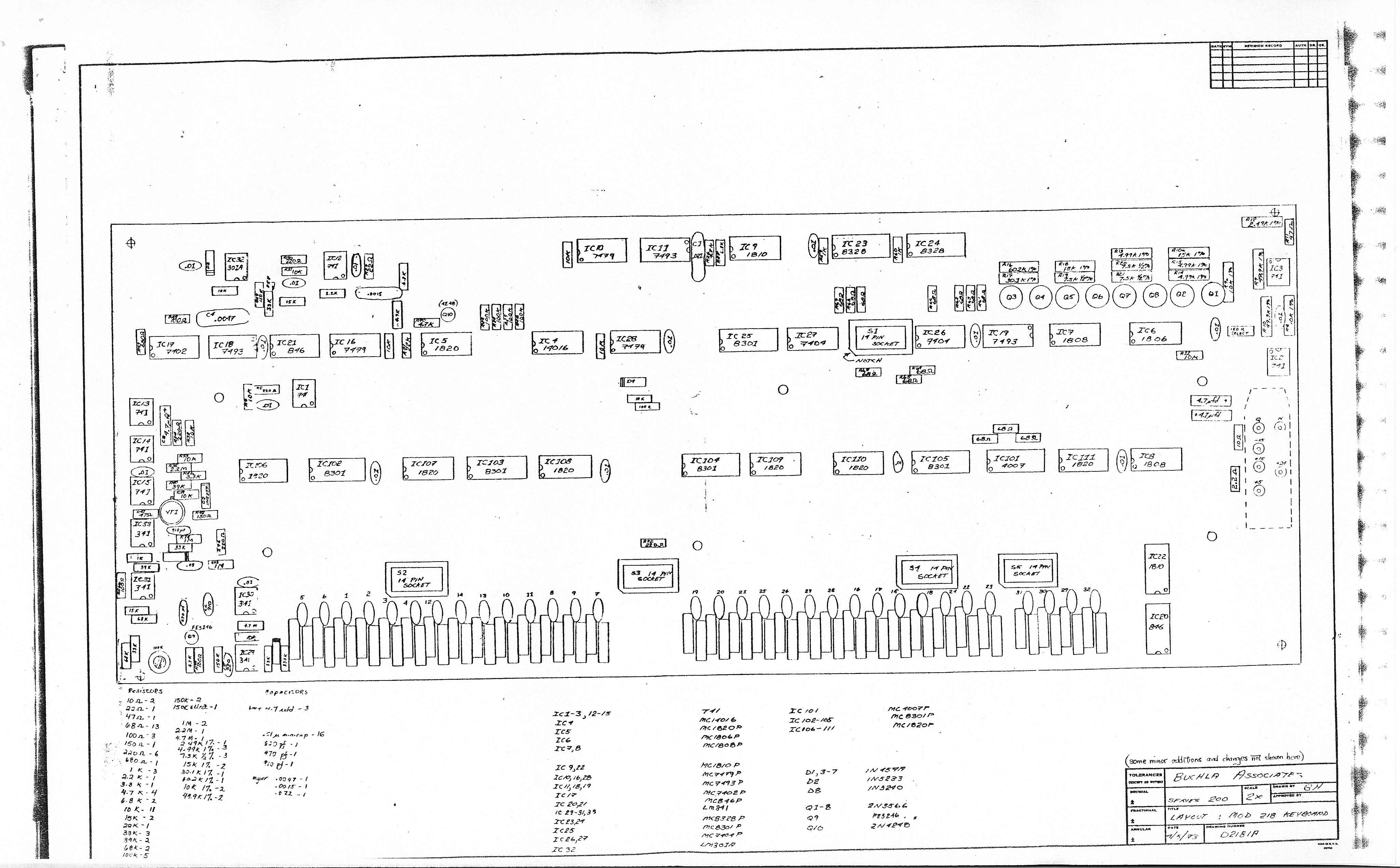

Last night I finally tested the slew circuit that I cloned from the Buchla 218 keyboard. I'm happy to say that it works. I've posted the schematic and a couple of sound samples below. I may have to do a bit of fine tuning... if nothing else I will try smaller cap values, since it's pretty easy to get way too much portamento going.
Update: I've uploaded the PCB layout, for those who like to roll their own.

In the schematic, it calls for a 6V Zener diode. But on your PCB diagram it says 1N5224. Isn't this a 2.8V Zener? What Zener did you use here? I don't know how crucial it is, as I have neither anyway. I'm a vactrol n00b and I don't want to fry them.
Nice efforts studying Buchla's work! Most of his stuff makes my head spin.
vtl5c3
Joined: Sep 08, 2006
Posts: 425
Location: PDX
PostPosted: Tue May 27, 2008 8:51 am    Post subject: Reply with quote  Mark this post and the followings unread
Good question. I'll have to check my work when I get home. You're correct that the 1N5224 is a 2.8 Zener. It should read 1N5233. Thanks for pointing it out.

PostPosted: Sun Nov 16, 2008 3:25 pm    Post subject: Schematics Reply with quote  Mark this post and the followings unread
Forgot that I was gonna post them, but here they are.
218 Schem Page 1
 Filesize:  2.07 MB
 Viewed:  1494 Time(s)
Buchla 218 Page 2 Schem
 Filesize:  2.86 MB
 Viewed:  1302 Time(s)
Buchla 218 Board Part Placement
 Filesize:  2.2 MB
 Viewed:  1174 Time(s)
