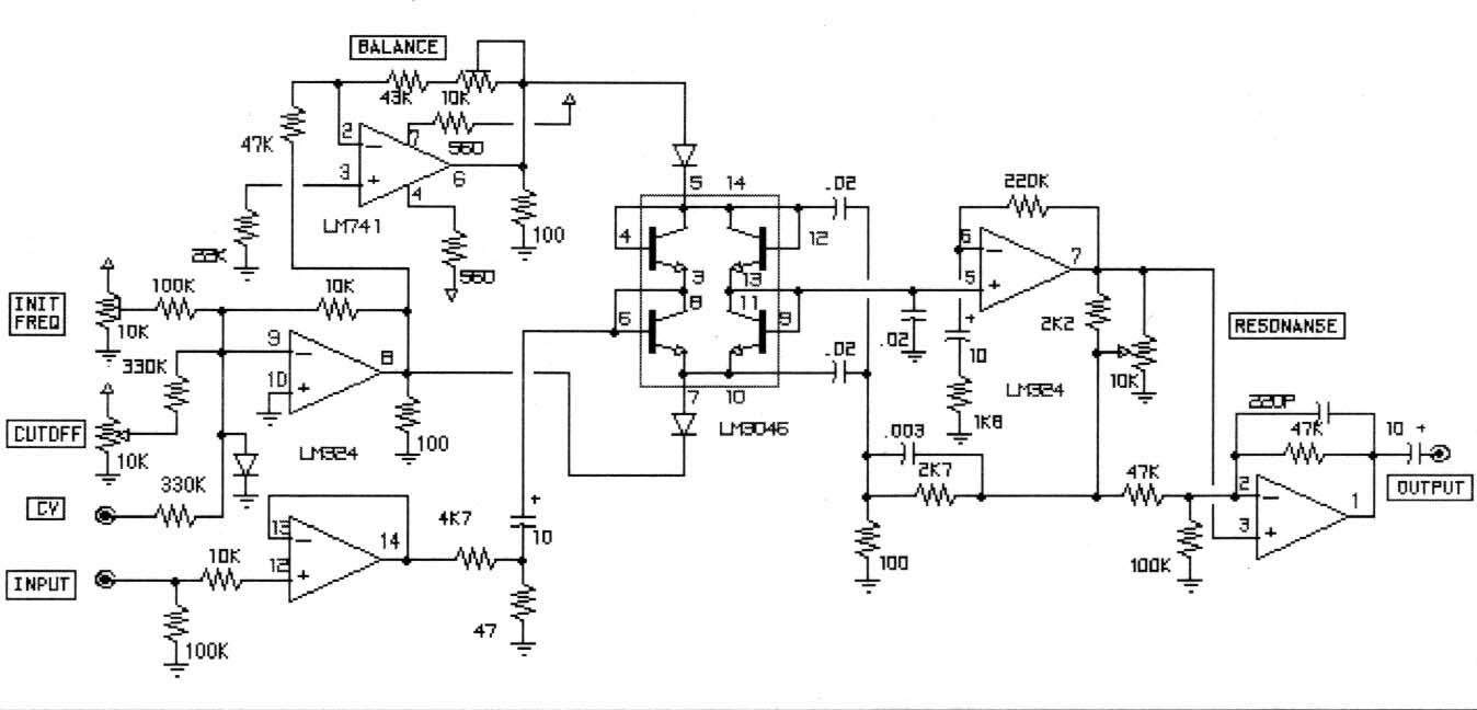

Anyone know anything about the Korg ms-50 filter?
There is a schematic here..
http://machines.hyperreal.org/manufacturers/Korg/MS-synths/schematics/ms50filt.gif
Looks kinda interesting

The arrangement of diodes in the schematic just looks strange to me. The rectifier in the middle bit. no quite a ladder.

I imagine that the rectifier is there to keep the feedback (resonance) in check?- Similar process to the Trancendent 2000 design by Tim Orr?
Everybody in the 70's had a way of trying to get round Moog's then patented transistor ladder- using diodes was just another way- very similar to the EMS synthi filter I suppose? But before you say "Hey that filter was really unique"- think for a moment why it was unique.... because I think the EMS filter was unique because of the way it handled modulation signals, and not necessarily the sound.

I remember MS50 filter as being a bit noisy. It obviously uses the peskily expensive CA3019, but I suppose that one could match diodes in its place.

I built a couple of them about 10 years ago. The CV rejection is pretty bad, so it's no good for sequenced CV control (unless you like that clicky sound). For pads it is kinda nice, has sort of a "glassy" type sound that reminds me a bit of things I've heard done with the EMS synthi. I'd say it's not a "must have" VCF...

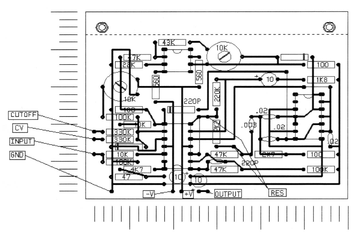

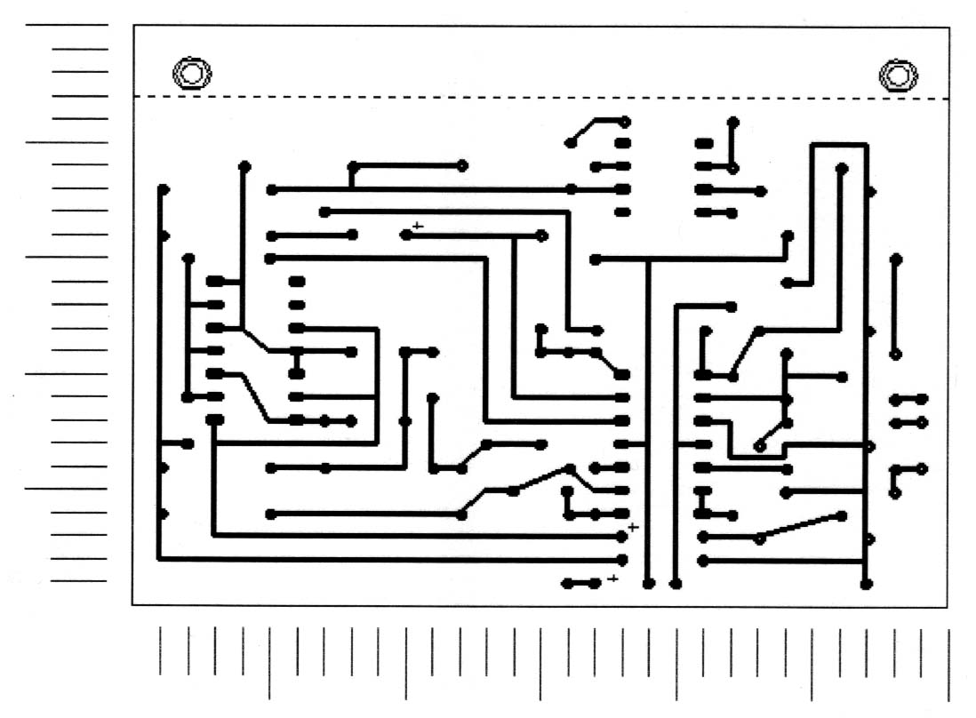

I have been scanning old EFM projects for the archives, and it so happens that this weekend I had found the MS50 clone I was riffing off of. It's a nice starting point.

Here's a later version of Tom's EFM VCF5. Got to split!
